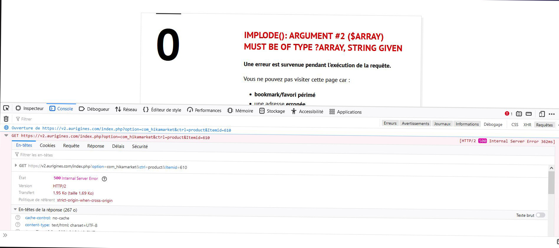

Under PHP 8, when we want to have the list of products in the seller space (url : /index.php?option=com_hikamarket&ctrl=product&Itemid=504) I get an error page:
"implode(): Argument #2 ($array) must be of type ?array, string given"
Once back to PHP 7.4, everything works fine.

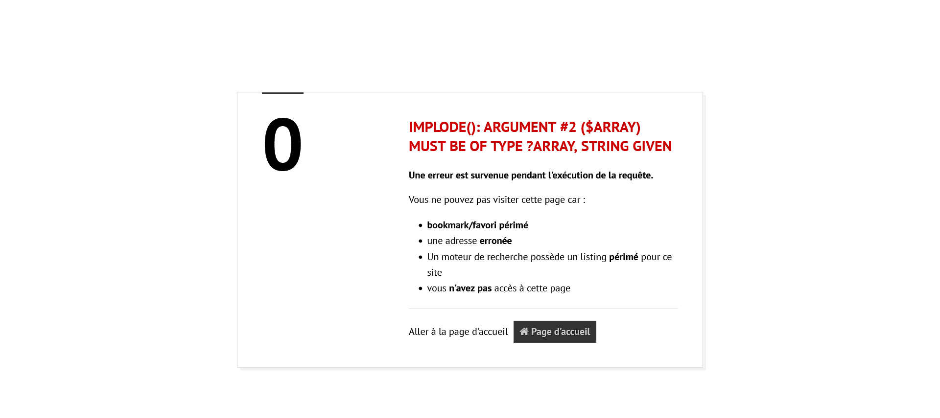

4 years 11 months ago #335714
As I said,
Debug mode is enable (debug2)
When I click on "produits" , I get a blank page, without anythink .
The screenshot with the error is the complete page displayed, without any debug info
As you can see, this bug causes a 500 error.
So, no debugging info to give you
All works fine with PHP 7.4, error occurs when I change to PHP 8
Patrick
Last edit: 4 years 11 months ago by LOCELO.

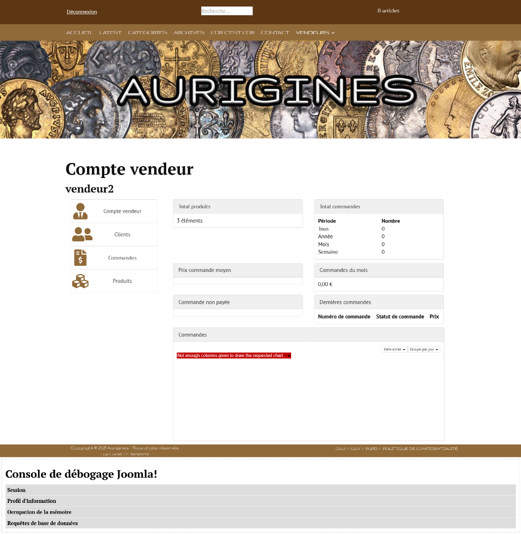

4 years 11 months ago #335745
Your front-end template does not support the display of the call-stack.
By switching to "protostar" (and with the debug mode), we can see more details of the issue.
/home/lorcestlor/v2/administrator/components/com_hikamarket/classes/category.php:532
Which allow us to fix the issue.
You can re-download the HikaMarket 4.0 package to get the hotfix.
Thank you for your report !
