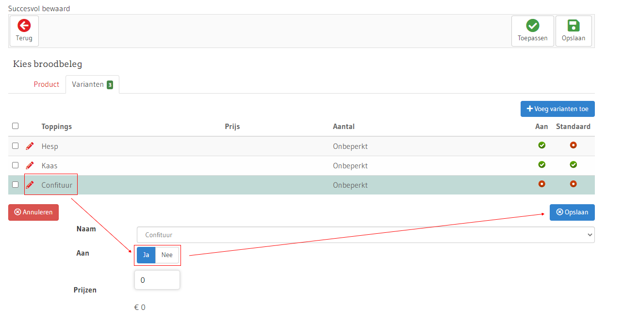

we run into some problems when switching the variants on/off in the front-end.
If I disable 1 variant and click on save the variant, it works, but switching the next on or off does not work correctly. It only saves it when the product is saved. And if I click on a disabled variant, according to the switch it is already on?? Weird things are happening in the front-end editor :blink:
You can try it yourself... if you log in with the details below.
