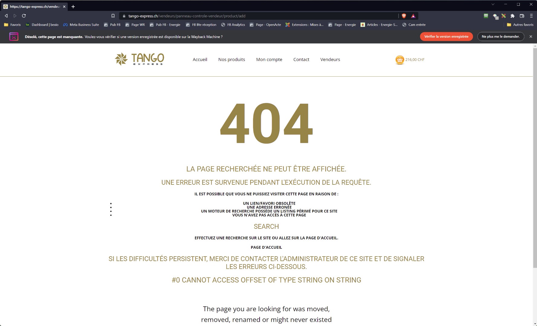

4 years 5 months ago #341947 by thefbi
OK, here it is, but it is just a 404 message...

4 years 5 months ago - 4 years 5 months ago #341971 by Jerome
There is bit more, we can see an error message
Code:
#0 CANNOT ACCESS OFFSET OF TYPE STRING ON STRING
But it looks like you need to activate temporally the debug mode in the Joomla global configuration, in order to get more details about the issue (the file, the function name and the line).
Unfortunately, I cannot reproduce your issue in my Joomla 4 test website.

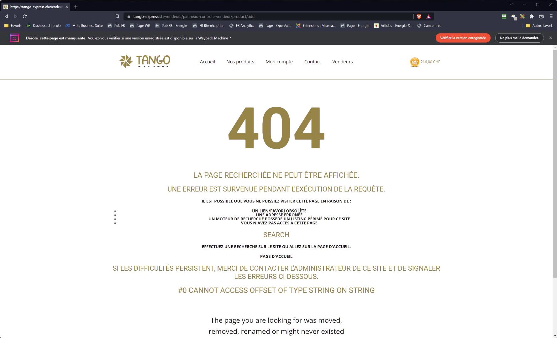

4 years 5 months ago #341978 by thefbi
Here is the error message with debug max :
