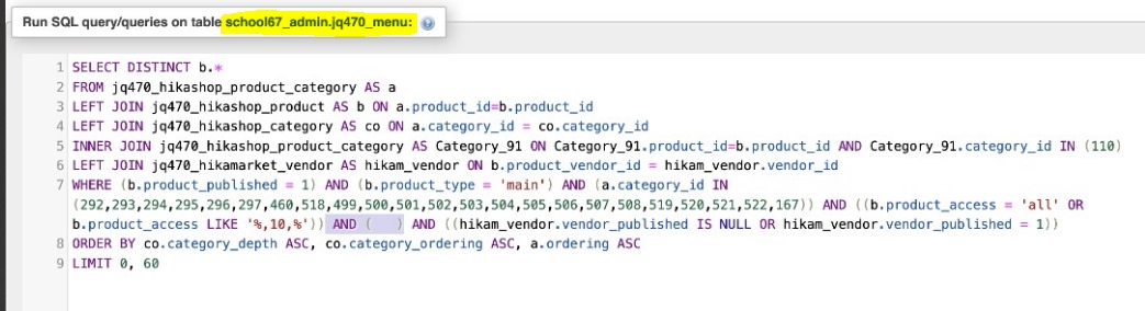

attached the debug we found that causing the error
there is an empty part in the query?
could you advise this query script location/path? or advise the method to fix this query

Regarding the SQL query and how HikaMarket interact with HikaShop during that trigger, there is nothing which indicates a bug in HikaMarket.
And since the error is coming from a query after a HikaShop plugin trigger, the callstack won't give you any useful information ; the plugins have been already called and the $filters variable contains an empty entry.
I understand that I think that HikaMarket is the cause of the issue ; but if you do unpublish the "hikashop / market" plugin, the issue should still be there.
