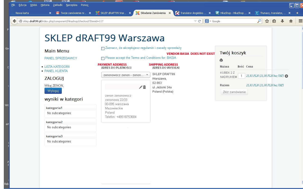

12 years 3 months ago #158104
the unpublish vendor produces errors. payment terms are assigned to another vendor, the terms and conditions the seller is connected to another vendor ... it's unacceptable. I want to be able to completely remove the vendor account, as an administrator.

  • Posts: 10
12 years 3 months ago #158133
O.K.
I found a solution, simply remove the entry in the databases.
What with orders? -nothing. as the vendor unsubscribe from the store can just be deleted.
you dont see error? look on screeshoot - BASIA is unpublishing

12 years 3 months ago #158153
In the file "components/com_hikamarket/views/checkoutmarket/view.html.php" you can replace
$query = 'SELECT vendor_id, vendor_name, vendor_terms FROM '.hikamarket::table('vendor').' WHERE vendor_id IN ('.implode(',', $vendors).')';
By:
$query = 'SELECT vendor_id, vendor_name, vendor_terms FROM '.hikamarket::table('vendor').' WHERE vendor_published = 1 AND vendor_id IN ('.implode(',', $vendors).')';
It should solve the problem for the terms & conditions.
