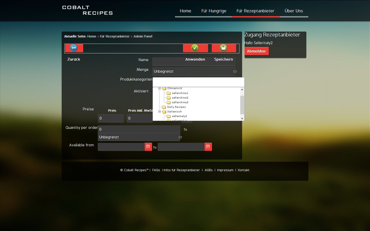

However - is there any possibility to restrict, which categories are shown to a vendor?
Each vendor should only see the categories, in which a vendor is allowed to publish products.
At the moment a vendor sees all categories. A vendor can also publish products in categories of other vendors. This will lead to confusion.
Also -imagine a multi vendor shop with dozens of vendors: the selection list will become quite confusing to the vendors as well.
Have a look at the screenshot. This is an example with 3 categories. 2 categories contain 5 different vendors in total:
The ideal solution would be that during the initial vendor set up, one can configure the categories, which a vendor can see, when he is creating a new product...
Thx
