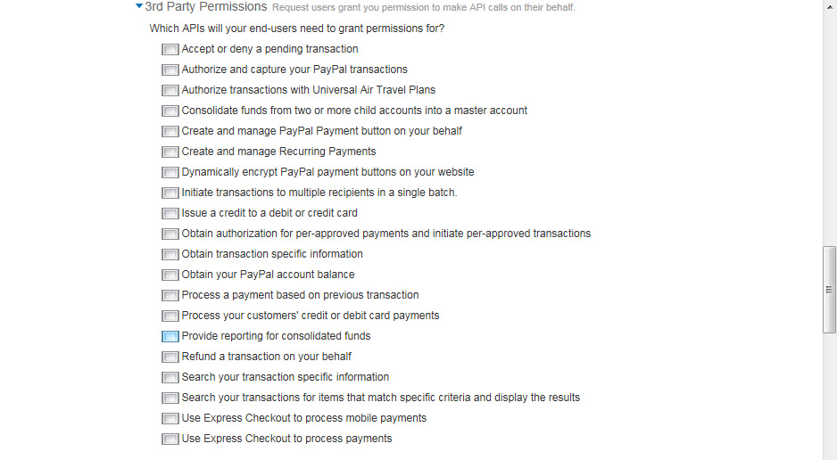

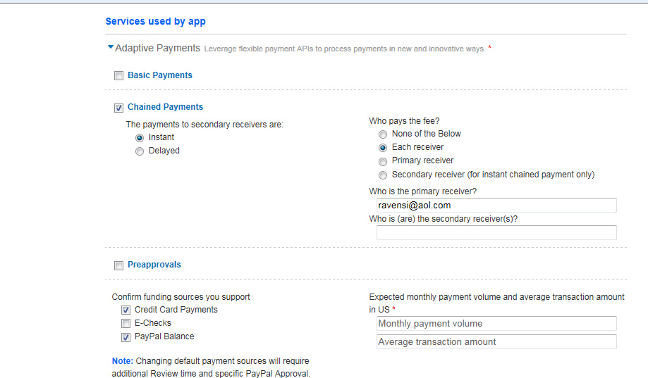

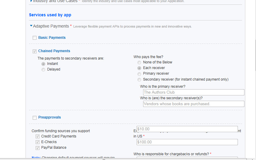

12 years 8 months ago #130941
Okay, so what do I enter into the PayPal API application for secondary vendors? What value needs to go there? (see the first attachment). We have our PayPal email address for primary receiver.
Also, can you tell me which of the 3rd Party Permissions need to be checked off in the application? (See the second attachment) There are so many and I don't know which ones the plugin needs permission for.
I'm sorry to be so confused. Thank you.
  • Posts: 26376
12 years 8 months ago #130952
Can you just read what I wrote ?
Your screenshot is not HikaMarket and it's not the HikaMarket paypal adaptive plugin either.
Just do what I am asking you to do.
  • Posts: 145
12 years 8 months ago #130965
It's the PayPal application I was showing you. I understand how to configure the plugin. I left all of those permissions unchecked. Maybe it will work.
  • Posts: 26376
12 years 8 months ago #130971
Yes it is the paypal application and I am not a specialist of the configuration of Paypal applications.
What I can tell you is that the fields for the "who" are manual fields, it does not ask emails.
For the 3rd Party, you need to authorize en capture your paypal transactions, and I guess, accept or deny a pending transactions.
Even if it uses the adaptive API, it only use the payment feature (to create a payment) to several receivers..
There is no other special feature used in the plugin.

  • Posts: 145
12 years 8 months ago #131055
It's a live account and "debug" is turned off in the plugin. The application is conditionally approved.
When I enter our store's email address as the primary receiver, PayPal tells me that our email address should be secondary receiver and that the vendors should be primary receivers. I've told them that we have many vendors in our store and that there is no way we can list each vendor as a primary receiver. I have tried to explain to them that HikaMarket asks for the vendors' PayPal email addresses when they register on our website, but they insist on listing EACH vendor as a primary receiver.
PayPal's message:
"Before we can proceed with our review, can you confirm that the seller will be the Primary recipient in the Chained payment & you will collect your fees as Secondary recipient? We will require you to set up the payment in this way so that the seller is the Merchant of Record in the case of any Chargebacks or Refunds. As in chained payment structure, the primary receiver is 100% responsible for the full amount of refunds and chargebacks regardless how much it actually retains to its account. Please amend your selections in the ‘Services Used by App’ – ‘Adaptive Payments’ – ‘Chained Payments’ area of the submission form to reflect this. Note: You will need to click the App Name in the ‘My Applications’ area in order to expand and edit the fields of your submission form."
Would it be better to configure the plugin as Parallel payments?
  • Posts: 26376
12 years 8 months ago #131141
It is not possible to set several vendors as primary receiver on a single transaction.
It means that you can't have several vendors for a single vendor (so set the option of HikaMarket 1.3.1).
In order to have this new comportment, we have to update the paypal adaptive plugin and add a new option (which will be only available if the vendor limitation is activated) to set the vendor as primary.
For the paypal adaptive documentation I read, I never see at any moment that the vendor can be set as primary receiver and for what I understand, it is a special configuration case in the paypal application.
