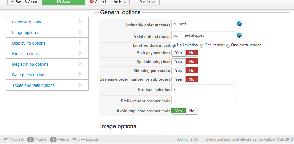

I noticed that when a customer purchased a book on my website, I received the full amount of the price ($1.99) in my PayPal account.
I have it set up so that my vendors should receive 70% of the sale from their products, but it's not working. My store should have only got $0.60 and the vendor who sold the product should have got $1.39 from that sale.
I have the configuration set up so that the Vendor commission is 30%. I don't understand why it's not splitting the payments like it should.
Should "Split Payment fees" be set to Yes?

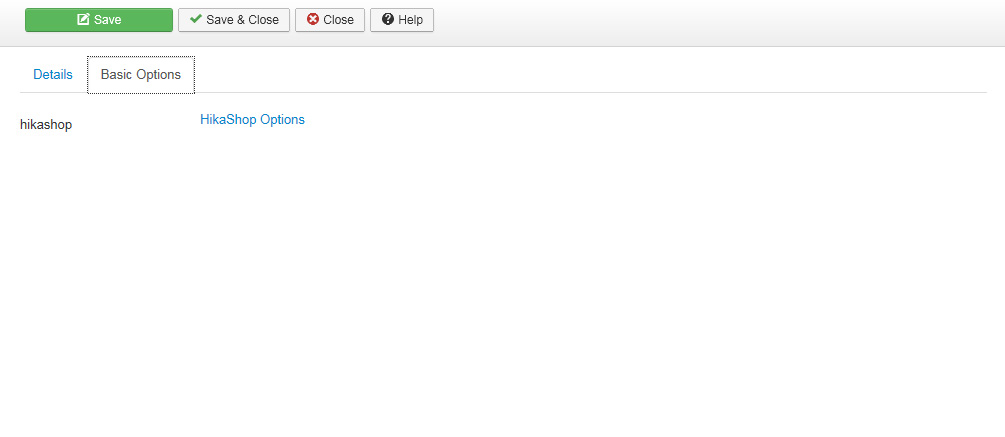

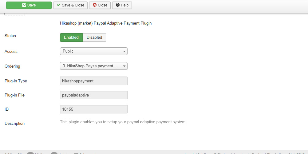

When I click on the HikaShop (market) PayPal Adaptive Payment Plugin, I see this:
The other tab says Basic Options, and I see this:
I can click on that link that says HikaShop Options, then it says PayPal. When I click on PayPal, it takes me to the HikaShop options for PayPal. I don't see anything else.
If you need to see for yourself, I can create an admin account for you.
  • Posts: 26376
12 years 9 months ago #129744
To access to the payment methods, you have to use the payment method menu.
HikaShop > System > Payment methods.
You can create a new payment method configuration by clicking on the "new" button and then, select the payment plugin that you want to create a configuration for.

Testing for the Adaptive Payments was successful yesterday. However, I noticed in PayPal's documentation that when using chained payments, there can be at most 1 primary receiver (my store) and 1-5 secondary receivers (vendors):
"You can have at most one primary receiver and 1-5 secondary receivers. Chained payments are useful in cases when the primary receiver acts as an agent for other receivers. The sender deals only with the primary receiver and does not know about the secondary receivers, including how a payment is split among receivers."
Is there a way to specify how many vendors a customer can have in his cart in the Adaptive Payment plugin? Or where would I look to specify the number of secondary receivers (vendors)?
Thanks!
  • Posts: 26376
12 years 8 months ago #130396
There is an option in HikaMarket 1.7.3 but the option does not allow you (yet) to specify a precise number of vendors for the limitation.
It will see to include it in the next build.
