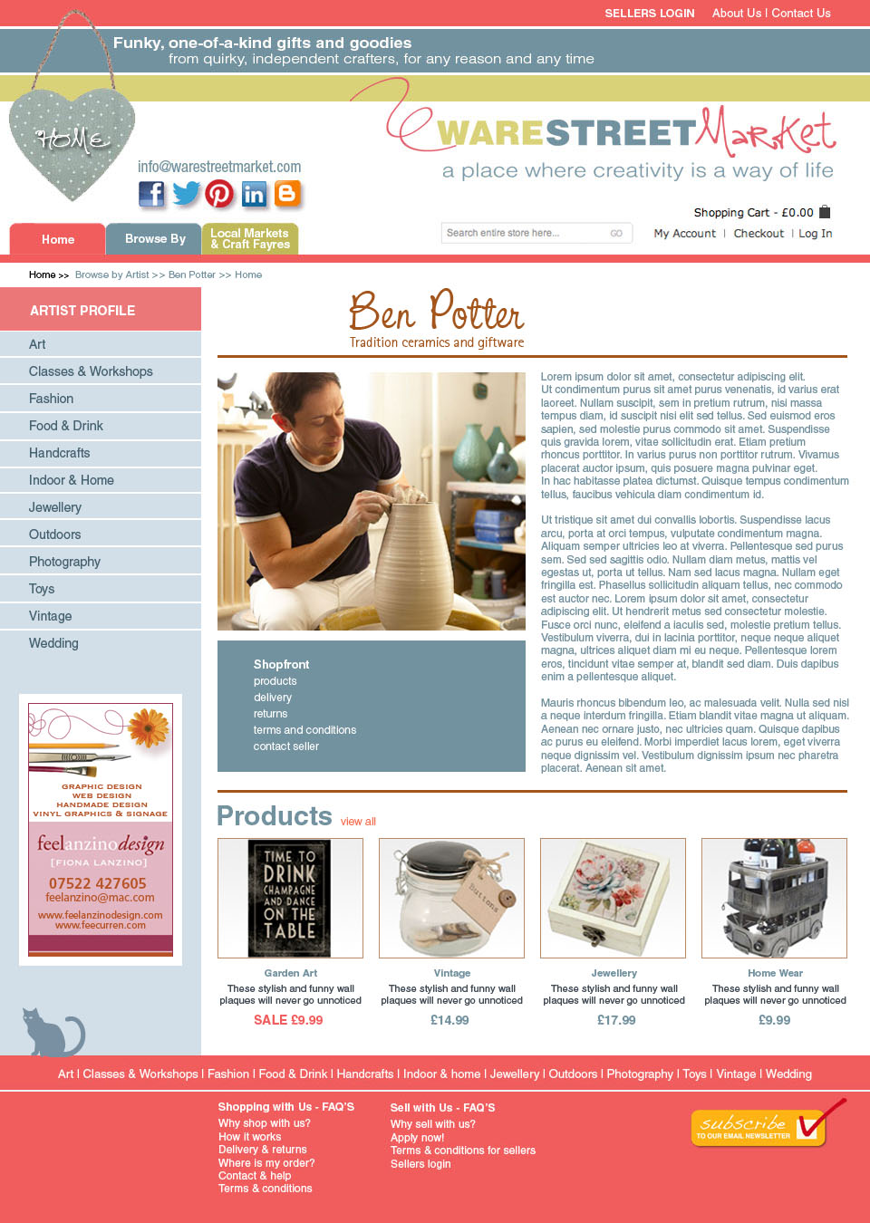

12 years 5 months ago #148271
When the vendor ends up with say 100 products, how do i use this module to show them all? The design i have been given for the seller page is attached. So the seller may list all their products, is there a way to do that because hikashop forces you to list the number of products it will show, or is there a way of pagination after say 50 products?

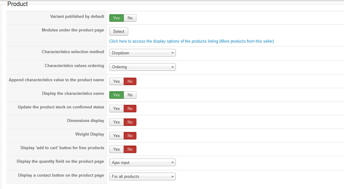

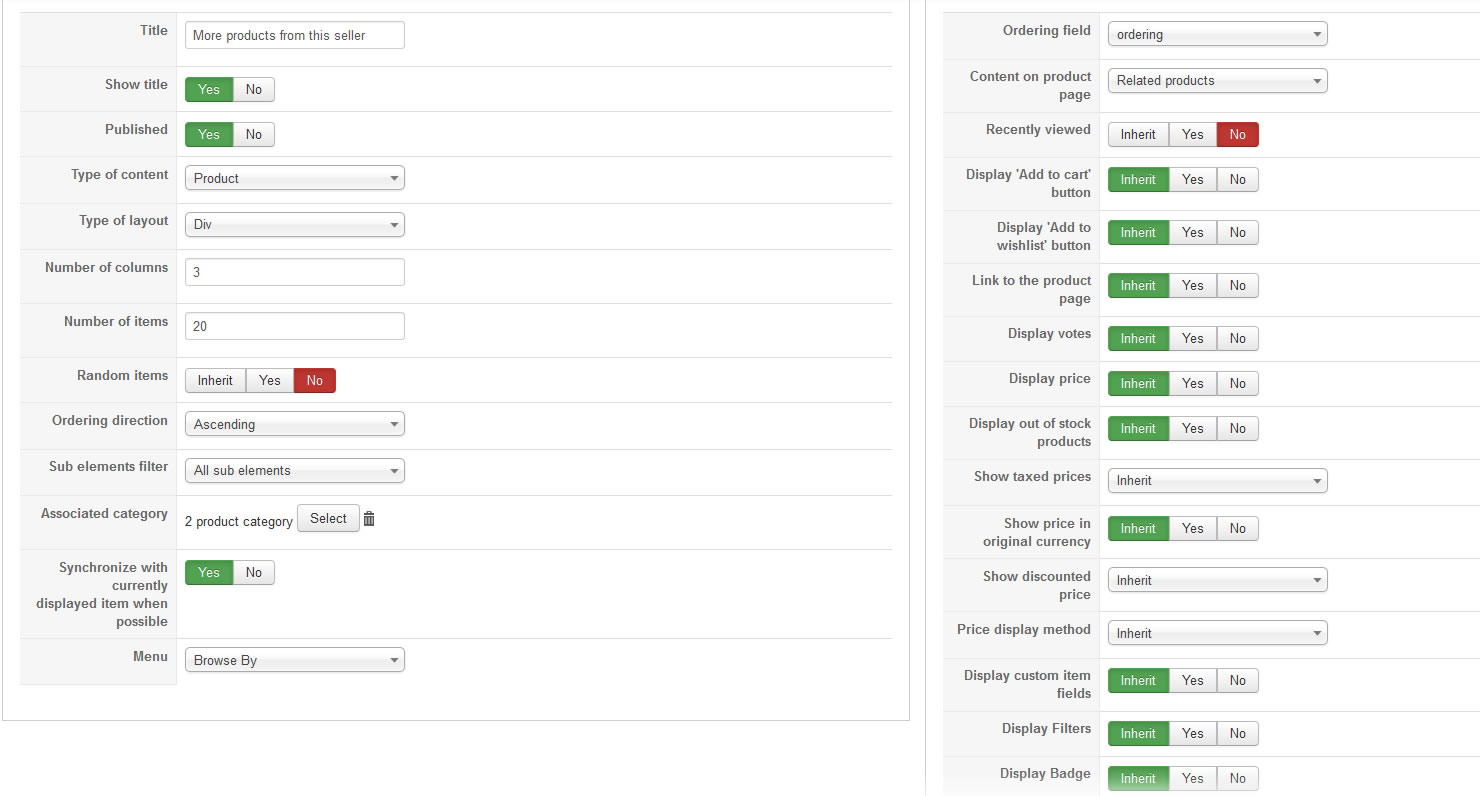

12 years 5 months ago #148505
Aha i didnt know you could allocate module in the configuration. It works for hikamarket, but not hikashop under product even though i select the same module to be displayed under product as under vendor page. Should i raise a ticket in hikashop for not displaying the module below the products?
Also the pagination is not showing for the module on this page even though i have the random set to off as described in the FAQ on this page
www.warestreetmarket.com/newsite/Artist/vendor/show/cid-2.html
FAQ:
I don't see any pagination on the listing of products.
That's probably because you have the "Random" option of your menu (for products listing menus) or of the associated module of your menu (for categories listing menus) which is activated. In that case, no pagination is displayed and the products on the page change each time you're displaying the page. If you turn off that option, the pagination will be displayed if there are more items to display than the "Number of items" option of your menu/associated module.
Any idea why?
