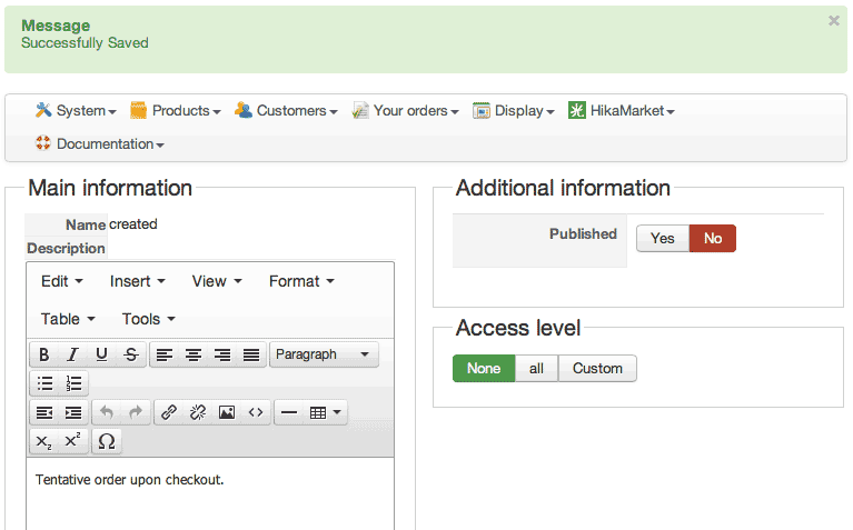

Sorry Jerome,
But I just thought I had THE idea: "Use ACL on order statuses to block them from being seen!"
So, I went to edit the "created" order status and set ACL to only admins and super-users. Nope, "created" orders still in vendor's order listing view in frontend and accessible.
ACL to "None". No change, still the same.
I also unpublished the status. No change, still the same.
Just FYI, check on the Shop side: All the same as well, created orders listed for customer, emails on creation, etc.
And all the same for different order statuses as well.
Duh?! What am I forgetting/overlooking? Why am I expecting that an order status, technically a category, doesn't show anymore if I both unpublished it and set ACL to none? Seen it working with other category types, am actually using the feature for certain product categories.
Attached what might not be telling much more, but anyway.
Thanks for a nudge for where I'm wrong, if so.

12 years 3 months ago #158100
You are right, we should be able to determine which order statuses the vendor can use.
HikaMarket does not load the ACL for the order statuses drop down, that's why this trick does not work.
I will see to add the code for that, or find another system to provide this feature.
My main idea was to add a "order status workflow" into HikaShop and does not really authorize vendor to change the status of the order but more "make an action".
Like "if the order is confirmed, you can ship it." which means that the button "ship it" won't appear if the order is not confirmed.
So the vendor won't have to choose an order status, he will choose to perform an action depending the current order status.
If the order is created, he will be able to "confirm it" when receiving the payment, etc.
For a first step, the ACL on the order status can be a good (and fast to implement) solution.
