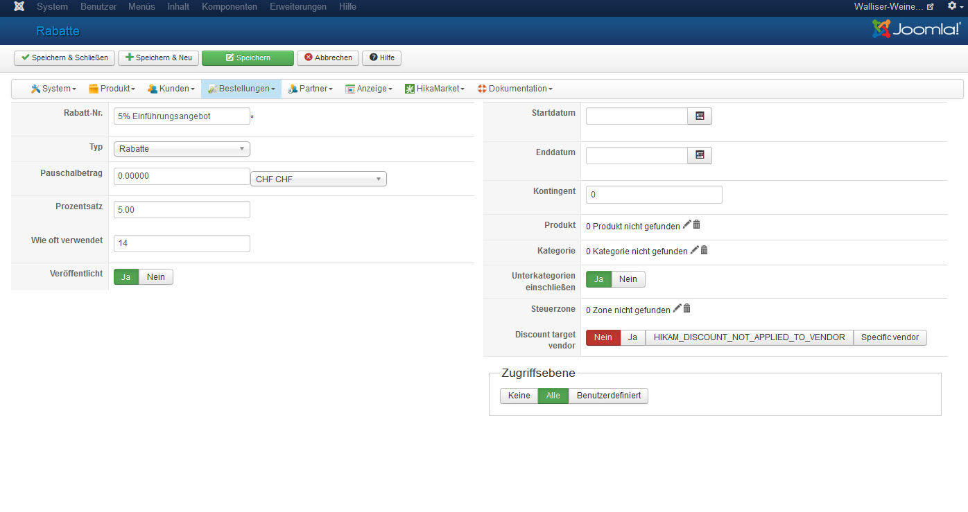

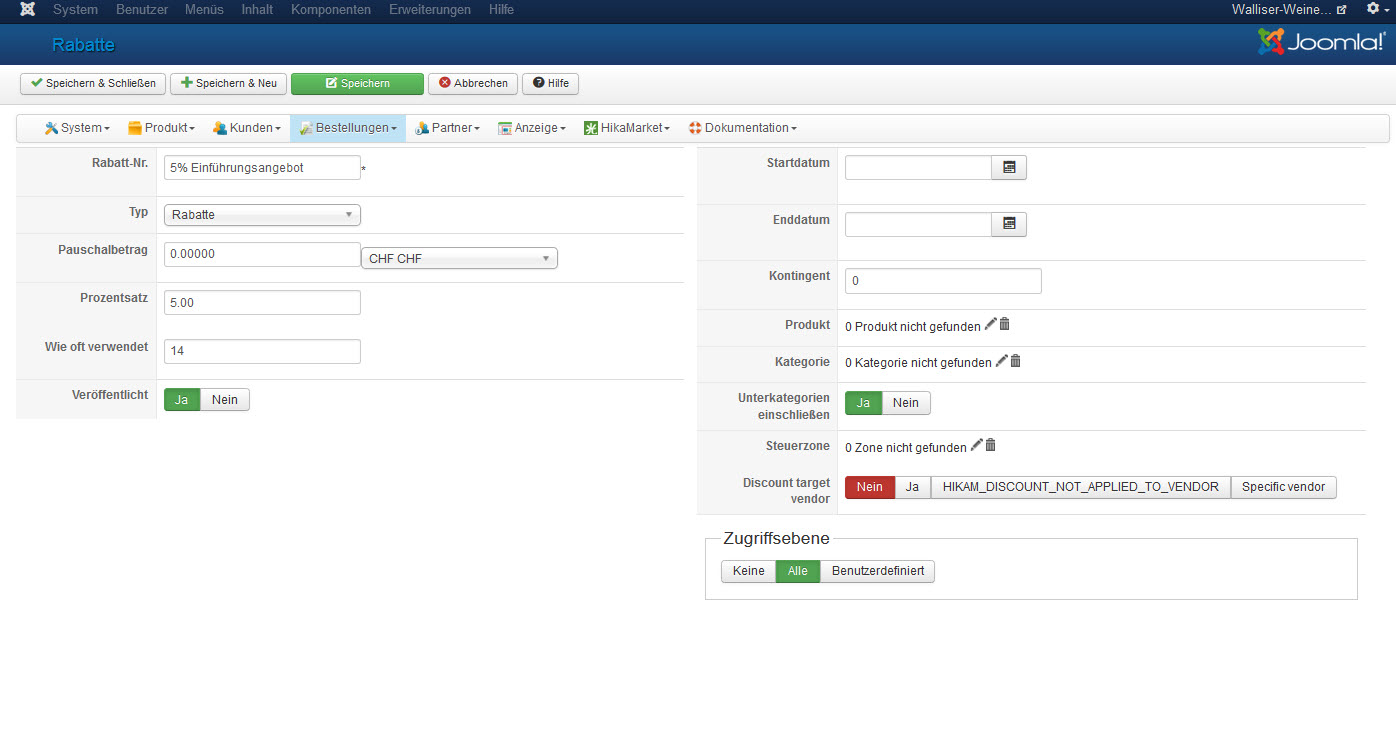

1.step:
Should this configuration asp creenshot not showing a discount for all products in the store?
Markus

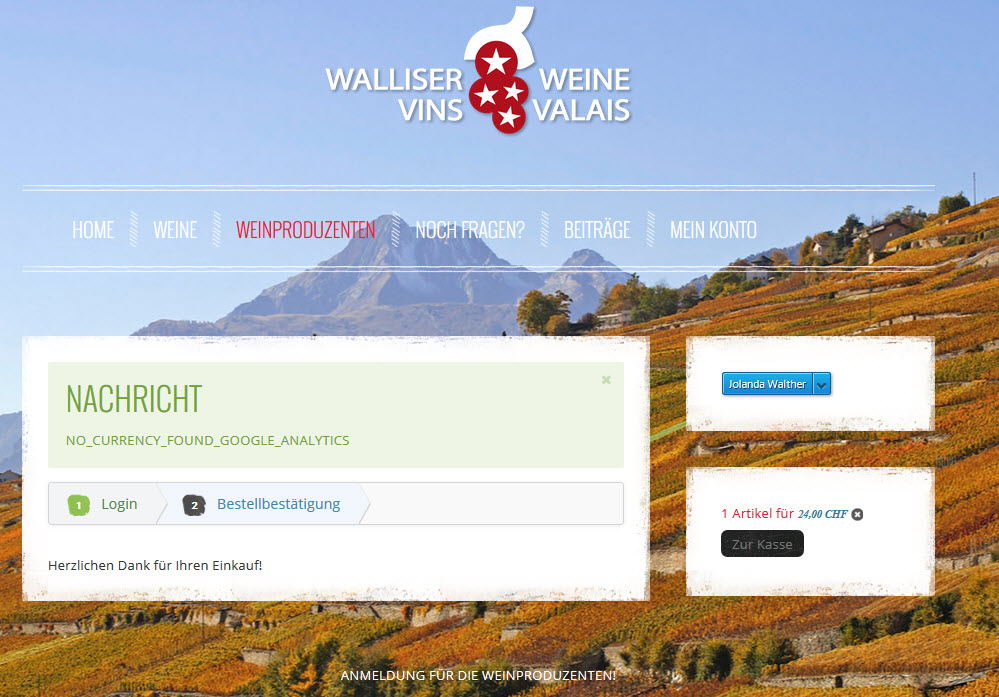

  • Posts: 116
11 years 11 months ago #168989

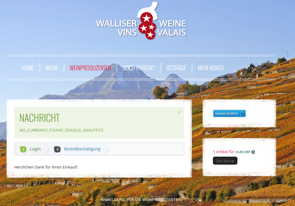

I need help.
When i want to scheckou, i immediately get trasfered to this page (asp checkout attachement) and not to the SOFORT payment which is defined as the only payment method. I also cannot change the path anymore.
What did i screw because of the EMail notification modifications?
Thanks very much for your help. B)
Markus.

1. You have a thread for your discount problem and I think that now the problem is solve.
If you still have problem with that, the best is to use the other thread and not mix several questions/problems in a single one (otherwise it will be very difficult to manage and help you correctly).

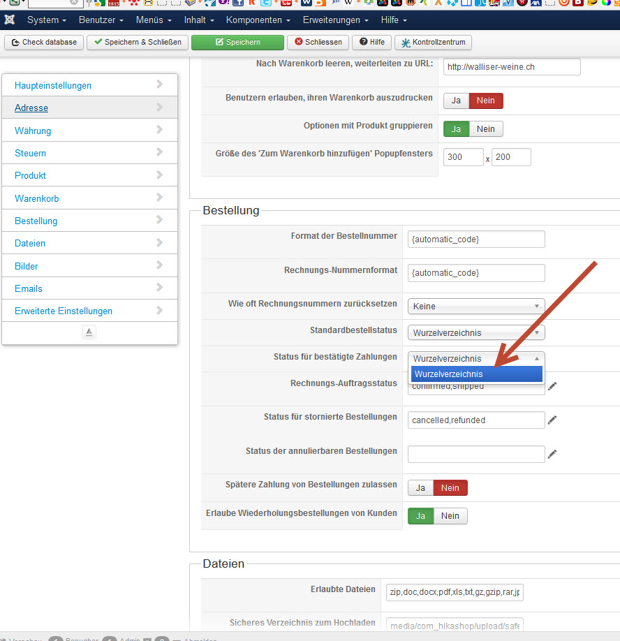

  • Posts: 116
11 years 11 months ago #169066
Hi Jerome
Discount and Coupon is solved. Many thanks for your help.

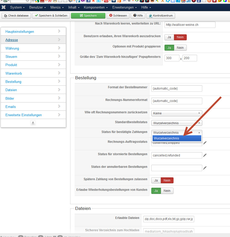

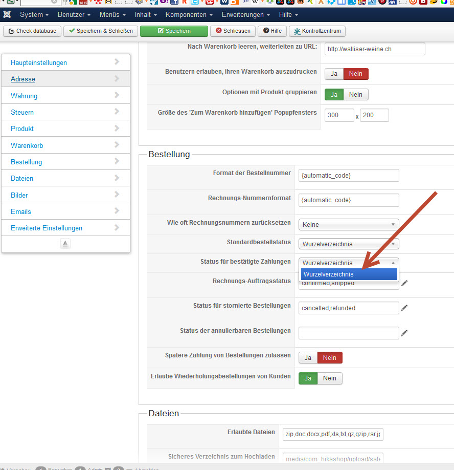

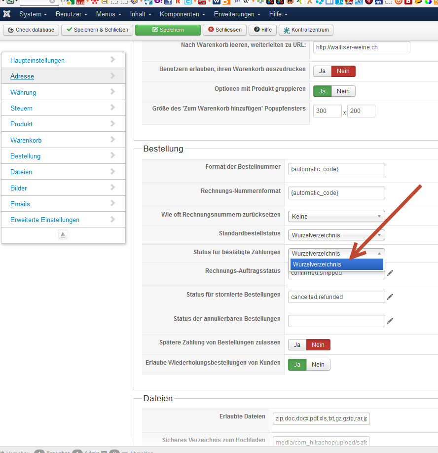

Rgarding the "path" issue, i do not know if this is a Shop or Market issue.
The problem is, changed somehting in the order routine, because i do not want that the vendor gets a order notification. Since i use SOFORT payment only, the customer can only buy when the order is payed. But since then, i cannot buy anymore.
On the order i see: The order is now ROOT. And i cannot change it in the main configuration asp attachement.
That's what i meaned with "path"
What did i screw up?
Thanks for your help
