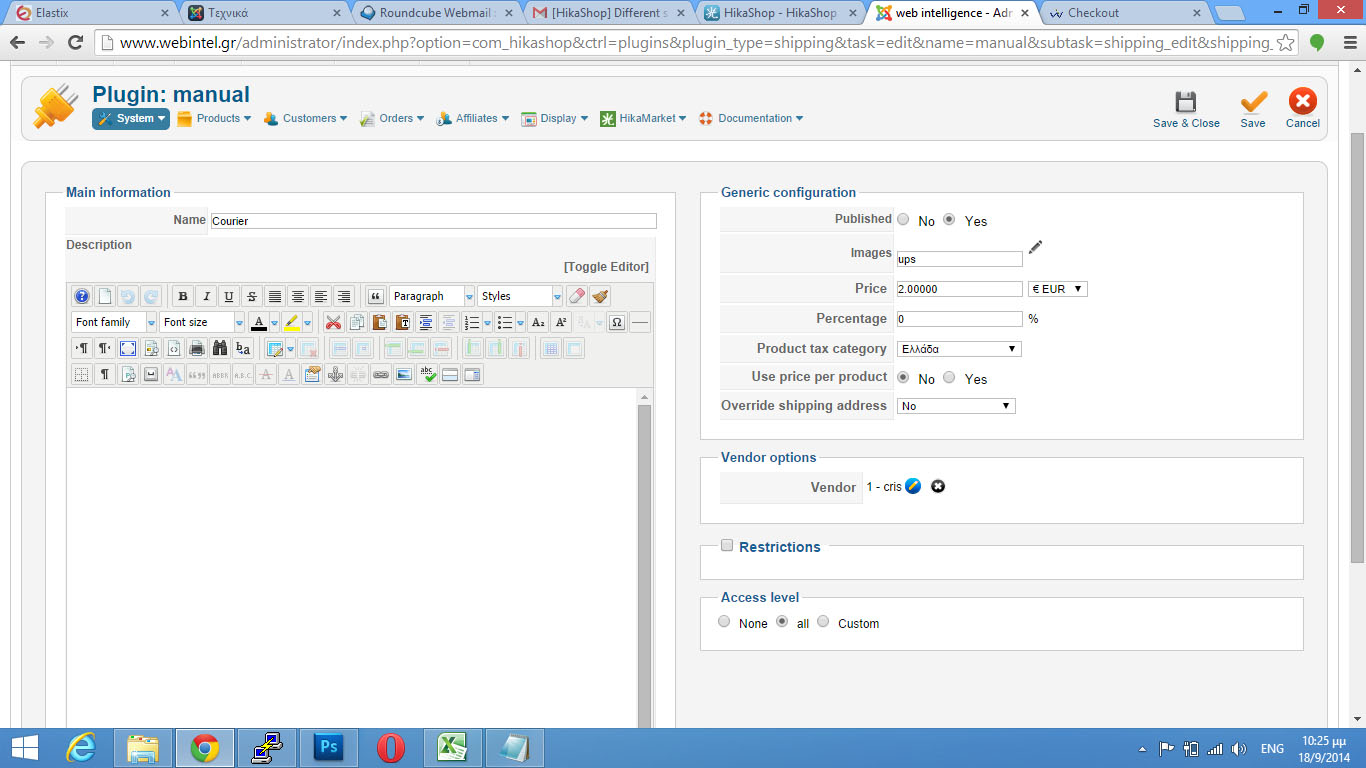

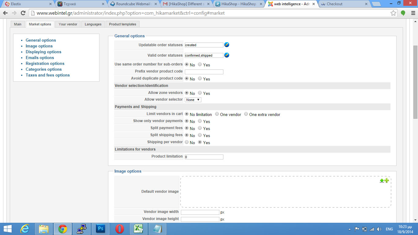

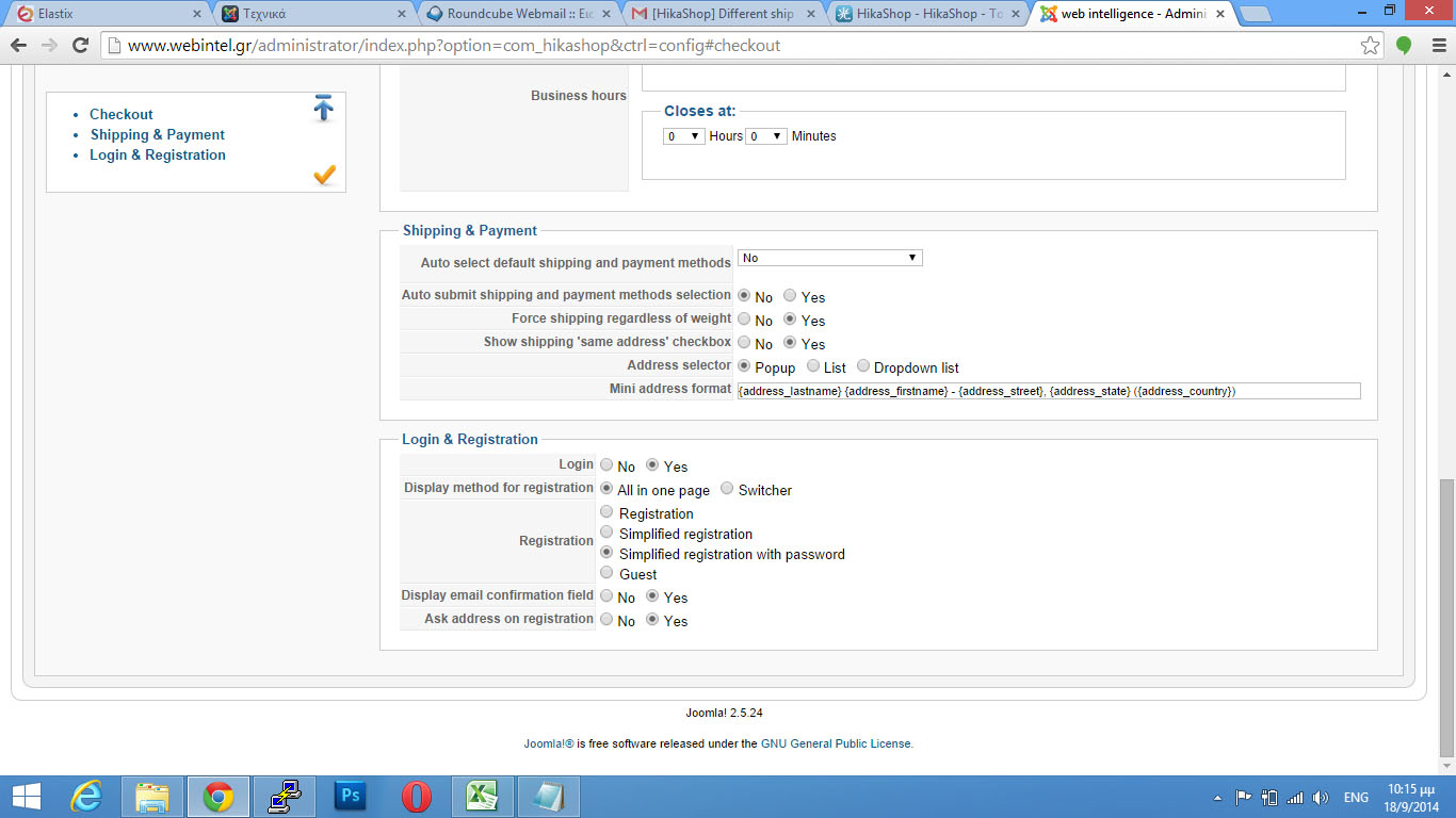

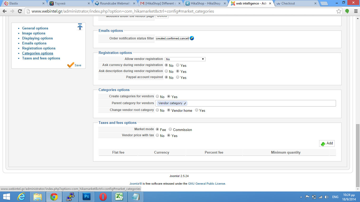

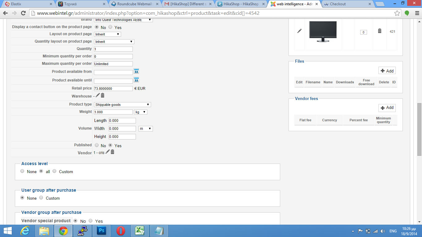

I have done what you told me.
Here some screenshots and I also pmd you for access

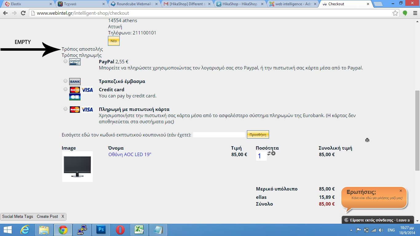

11 years 11 months ago #172229
ok.
I saw it but. if you add this product
Part of the message is hidden for the guests. Please log in or register to see it.
, you ll see that both ups are available. It should have only for my vendor i suppose
