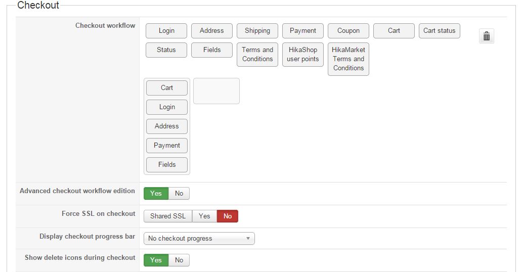

  • Posts: 58
11 years 6 months ago #186572
I have attached a screenshot of the checkout workflow.

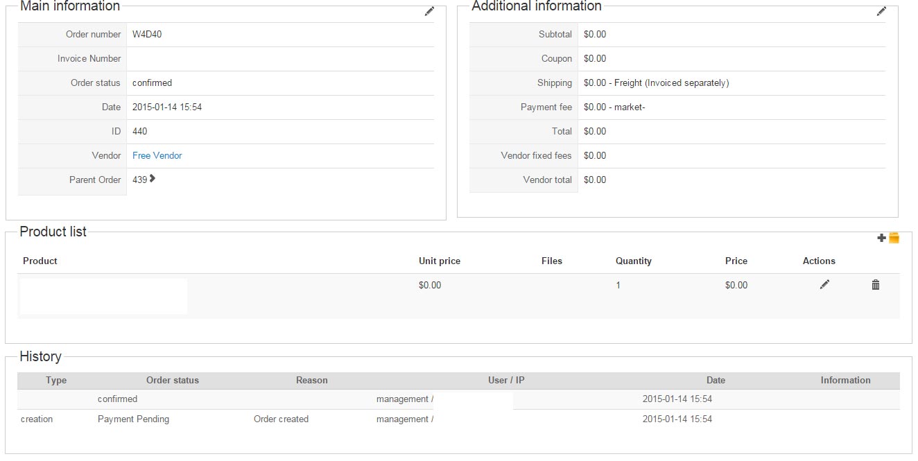

  • Posts: 58
11 years 6 months ago #186645
HikaShop Free orders validation Plugin - is published and Send confirmation email is set to YES
Regarding order status, the main order status is set to none, but the vendor order status is confirmed on the free orders.
Attached is a screenshot of the Vendor Order for an order with a free product,
