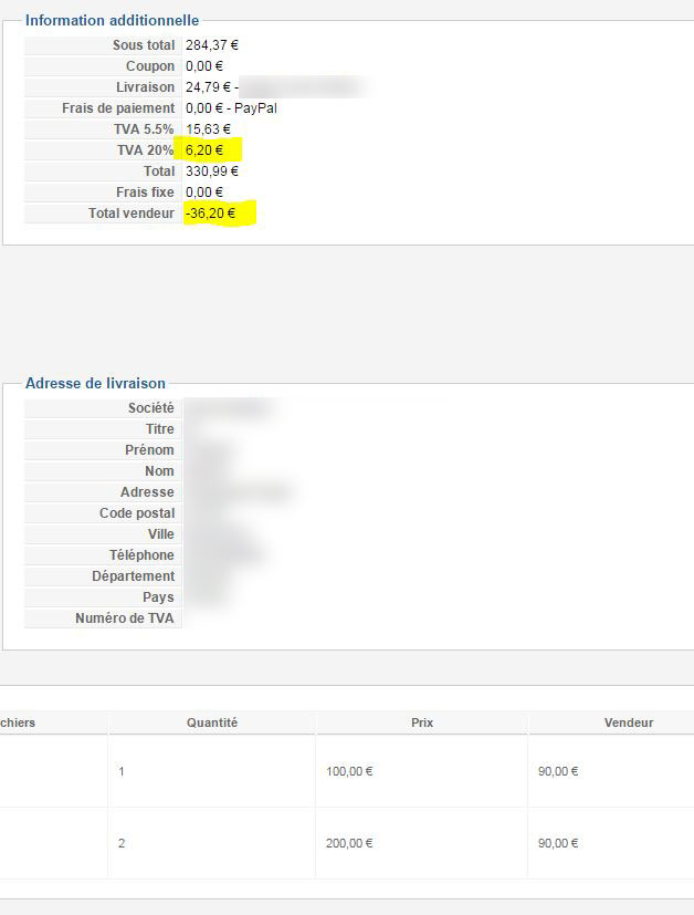

I Cannot understand why fees of all sellers are correctly calculed but add VAT from shipping on it !
hikamarket global configuration is configured without include shipping for calculate fees;
please take a tour into the screenshot below and tell me how to exclude this VAT.
Thank-you.

You are in the mode where the vendor is paid directly.
That's why the vendor total is negative.
It means that the vendor receive all the money, including taxes.
So the vendor have to pay back the store fees and it includes the taxes that he does not handle itself.
  • Posts: 54
