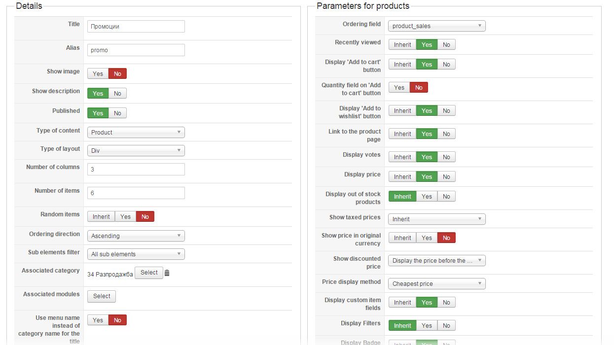

I would like to list all the products from all the vendors, that have discounts. Is there a way to?
I tried using product_sales as Ordering field, in HikaShop options, but it is not the case.
Thank you!

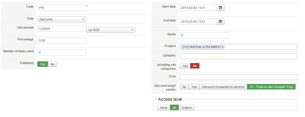

11 years 6 months ago #193291
There is an example of discount that is not listet this way.
What is the wright way to set them or could I find example somewhere?
