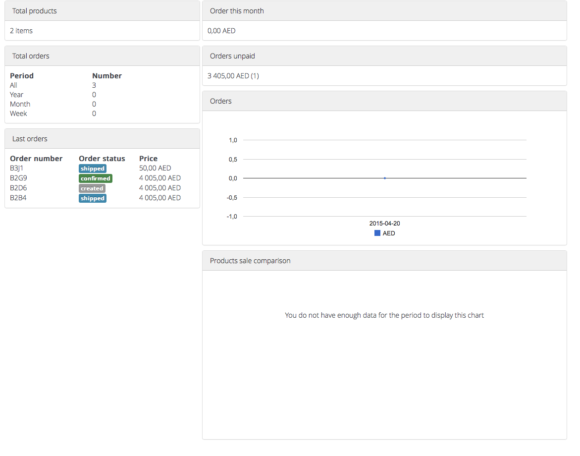

Hey guys
The vendor analytics aren't working. how to fix this?
I attached a screenshot
  • Posts: 26385
  • Thank you received: 4077
11 years 4 months ago #199351
Are you sure that the statistics are not working ?
Because the stat "total order" indicate that you just have one single order but that it is an old order (in the past year)
So, the two stats on the right does not have any order to process ; because you only order is outside of the date range for the statistics (that you can configure in the HikaMarket configuration).

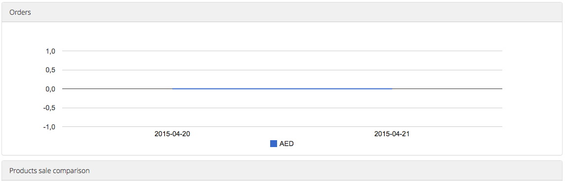

  • Posts: 125
11 years 4 months ago #199378
Well no they aren't showing the details. Ive attached another screenshot so u can see.
Graph not working, comparison not working, and the total orders incorrect
Please help
thank you

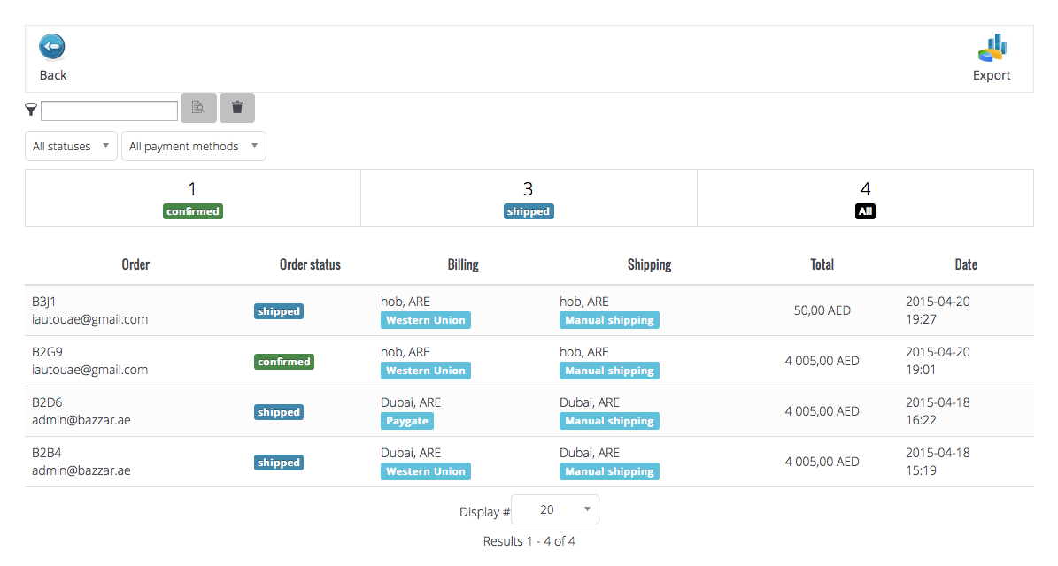

  • Posts: 26385
11 years 4 months ago #199383
Once again : like you can see in the screenshot, there is no order detected for the periods "year", "month" or "week" which means that you have only old orders.
www.hikashop.com/support/documentation/1...ml#config_main_stats
1/ Please check the configuration or your different statistics ; you have a "period" setting for them.
If you have a short period with no order in that period, the graph won't have any data to display.
2/ Please check the setting "valid order status" in the "statistics" part of the HikaMarket configuration.
If you hare sure that you have orders to display in the statistics ; please provide screenshots of your HikaMarket configuration (for the stats part) and also a screenshot of your vendor order listing (to see the different order dates).

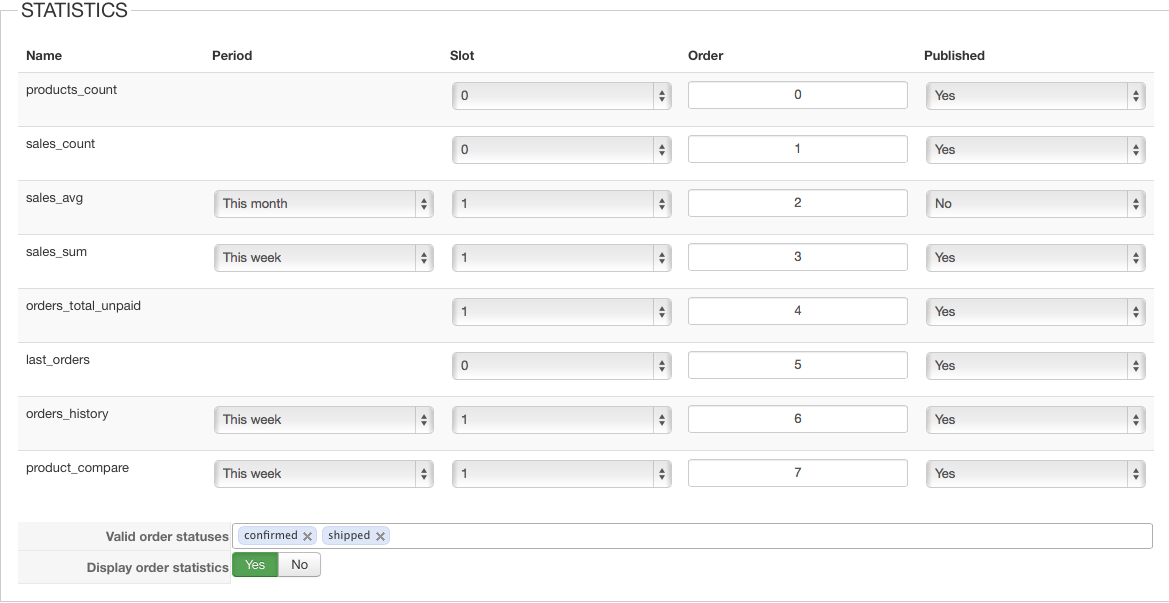

  • Posts: 125
11 years 4 months ago #199443
I am 1000% sure that something is wrong. Ive attached u the setting and the screen shot of the statistics.
Regards :)
  • Posts: 26385
11 years 4 months ago #199458
Regarding your order listing, none of your order have an invoice number.
The statistics are using the "order invoice created" value in order to place the order on the date when the order has been paid/confirmed ; but it can also use the "order created" value if you include the order status "created" in the valid order statuses (for the statistics).
So, I think that you have an issue with the confirmation of your orders because they don't have an invoice number (so they don't have an "order invoice created" either)
How do you confirmed the orders ? Only the sub-order (the vendor order) or the main order (custom order) ?

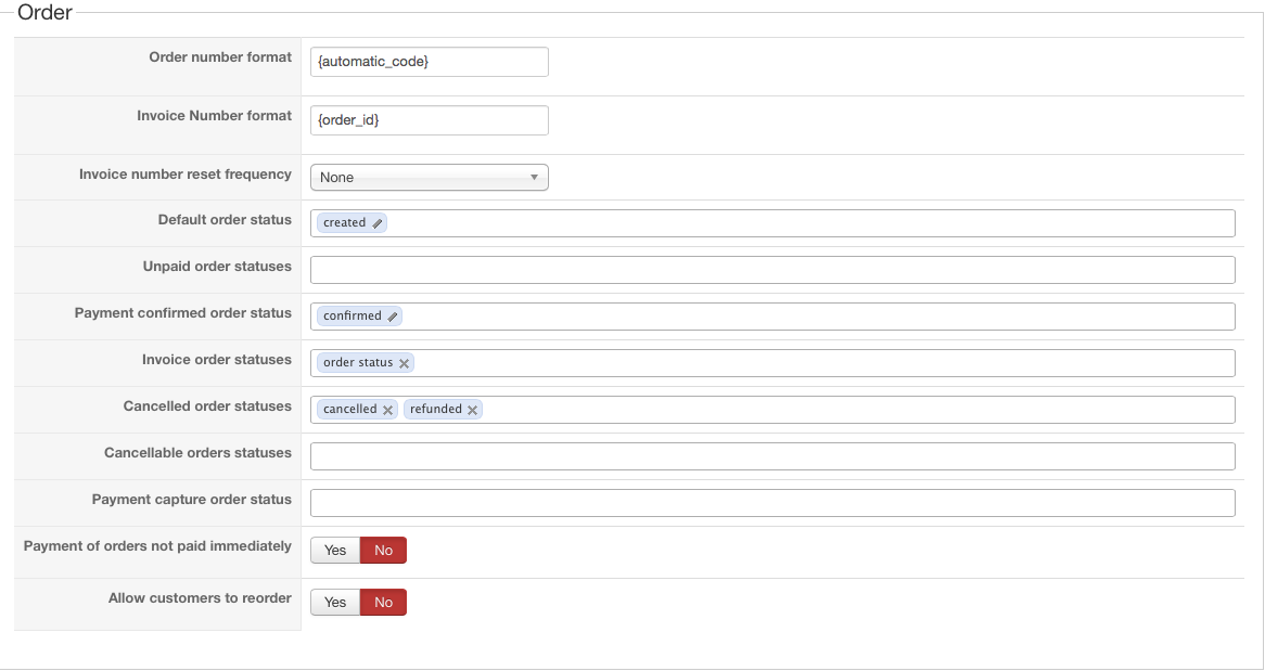

  • Posts: 125
11 years 4 months ago #199497
I attached whats in the order options. Im so confused i have no idea what to do :cheer: :cheer: :S :S
  • Posts: 26385
11 years 4 months ago #199501
For the setting "invoice order status" you should put the order status which generate an invoice number, like : confirmed, shipped
I don't know how you got "order status" but that's not a correct value for the setting.
The following user(s) said Thank You: Konstantin1996

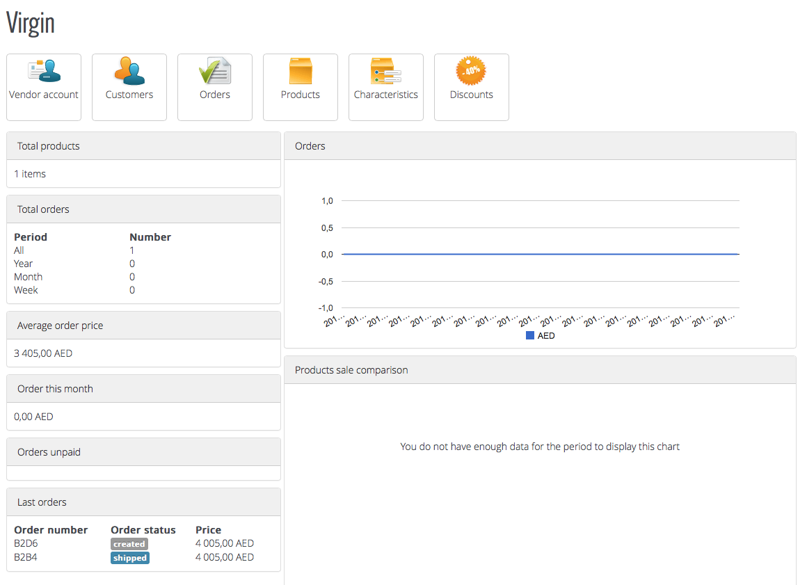

  • Posts: 298
  • Thank you received: 7
  • Hikamarket Frontedition Hikamarket Multivendor Hikaserial Standard Hikashop Business
11 years 4 months ago #201410
I seem to be having the same problem that Konstantin1996 has or had. The Total products, total orders, average order price, and last orders seem to be working fine. The Orders this month, Orders Graph and Products Sale Comparison Graph show no activity.
Hikashop 2.4.0
HikaMarket 1.6.2
Invoice Order Statuses: confirmed, shipped, printed
Order Number Format: {id size="6"}
Invoice Number Format: {order_id}
Valid Order Statuses: confirmed, shipped, printed (if I add 'created', then the Orders This Month shows a total, but the two graphs go completely blank, not even a zero line)
Thanks!
