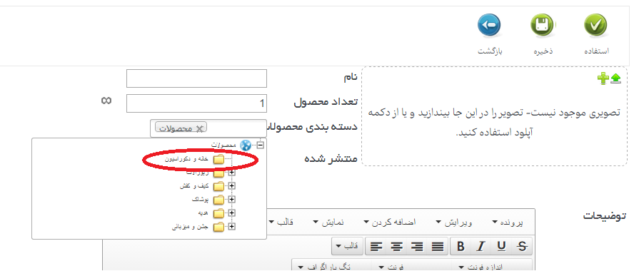

I have another issue with category selection and related product selection in "add product" page in vendor front-edition. When I select a category, its products and subcategories do not load. (As the attachement)
Thanks in advance.
Last edit: 11 years 1 week ago by mehdikazemi.
  • Posts: 26376
11 years 1 week ago #208841
When there is subcategories or products under a category, you can see some kind of "+" near the category icon.
If there is no symbol, it means that the category is empty.
In your example, the category is empty, there is no subcategory (or no product if it's a product selection).

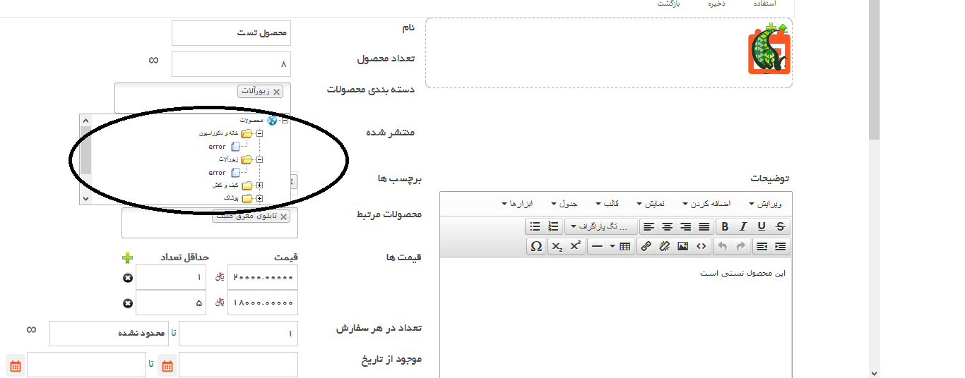

I removed {} but problem occurs in different way. See the attachment.

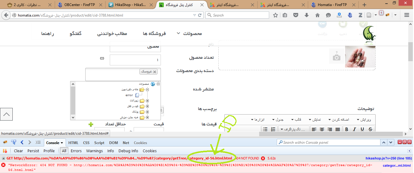

If you look at the network log, you can see the "XHR" calls (ajax calls) and see the URL which is used.
And you can also see the returned content. Knowing the used URL will help to understand the current issue.
If you do not know how to do it ; an access to your front-end will be required.

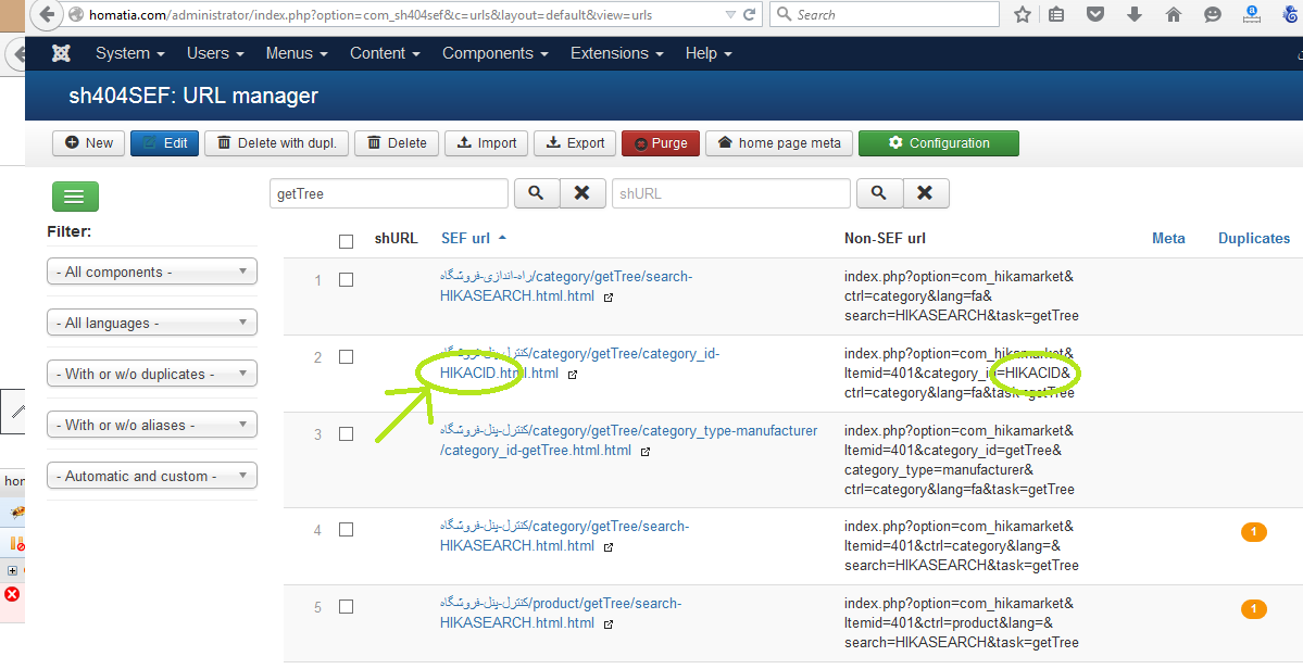

10 years 11 months ago #212300
Thanks for your response.
It seems it doesn't work. HIKACID does not replace by any value in the Sh404SEF (see the attachment), while it does in the hikamarket requests. (see again the attachment).
