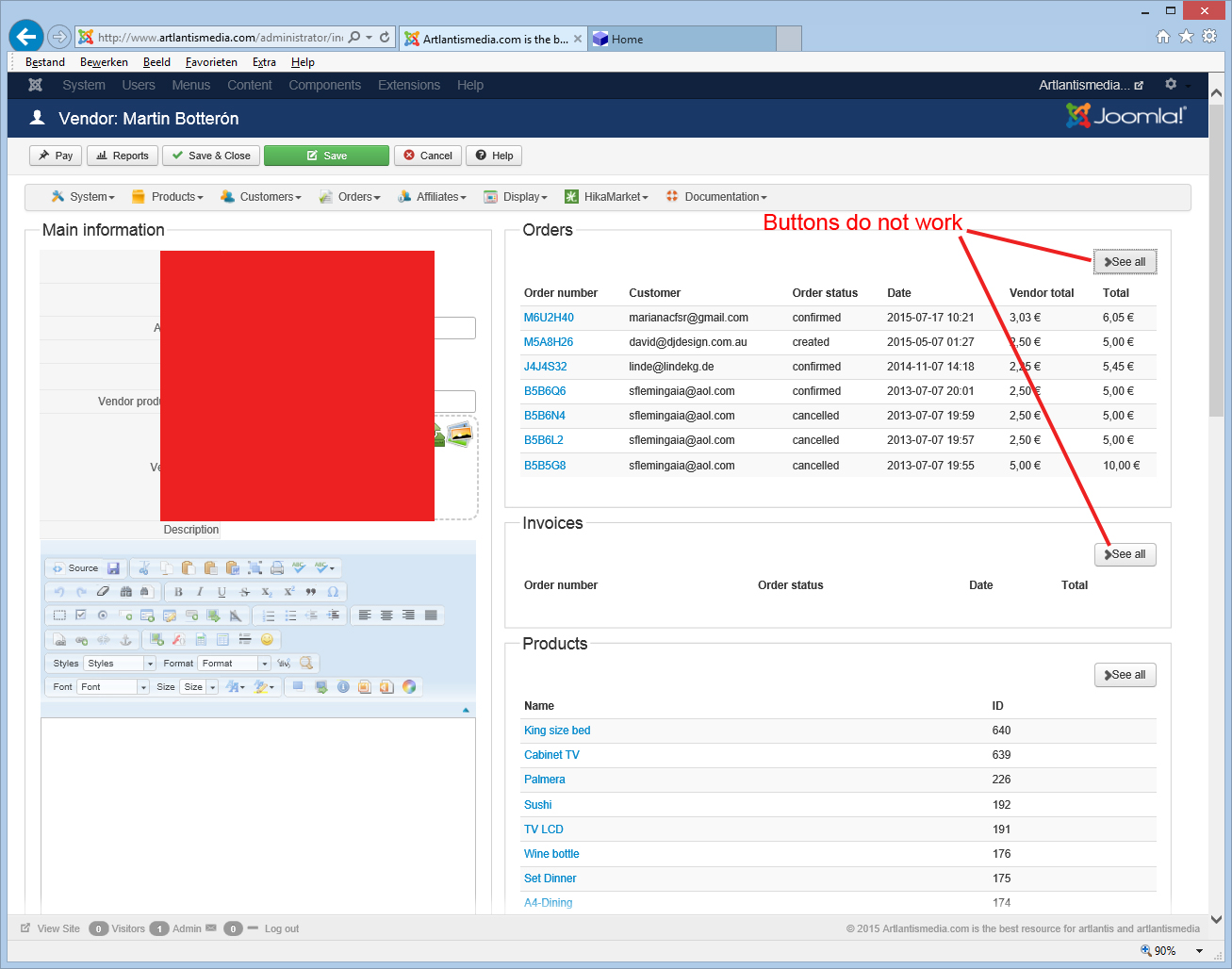

One of my vendors requests a payment. When I want to view his orders to make the payment I have a problem. Screenshot is attached. There is no payment button visible and the 'see all' buttons do not work as expected.
What can I do to solve this?

I'll see why the buttons are not working properly with Internet Explorer.
About the payment button, I can see it in the screenshot, it is the first button in the toolbar.

Sorry about that. I indeed completely overlooked the pay button. Wasn't that somewhere else in the past?
Well. Pushing that button opens a page showing all the orders I need to pay. In this case I need to choose manual payment. Orders to pay are checked and then? How to complete this action? There's no 'confirm button' or something alike. If I push the pay button again I get a white screen. Nothing happens further on. After payment I need to 'clear' the list of unpaid orders so my vendor has a clean sheet.
