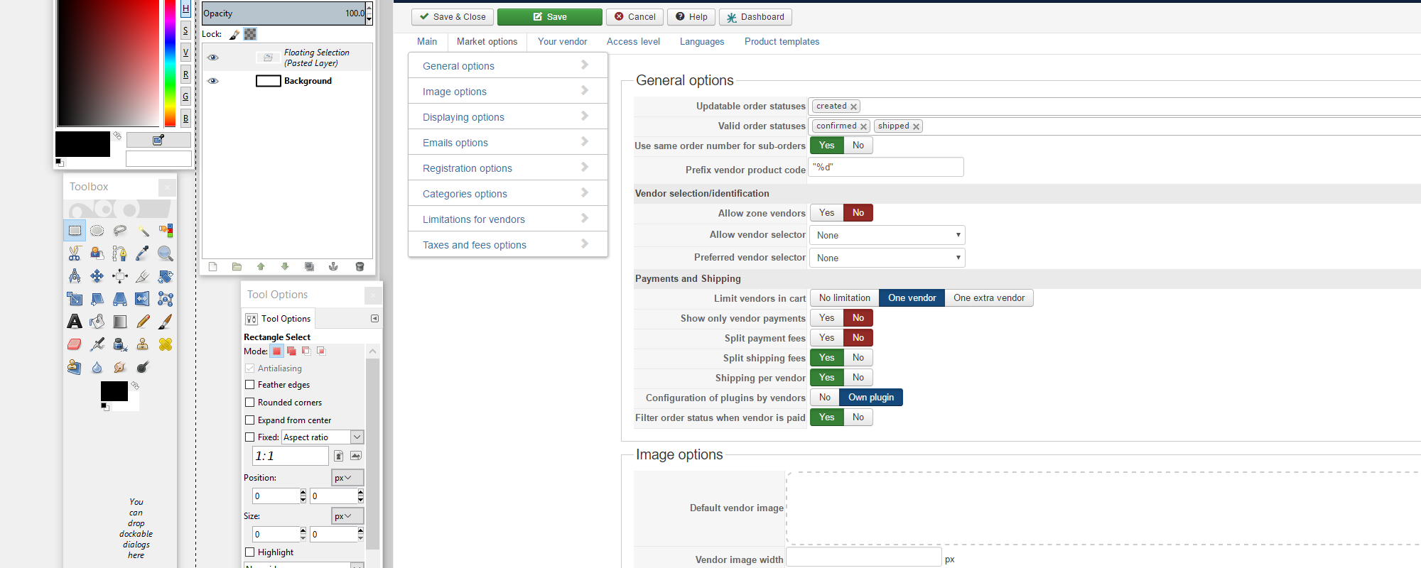

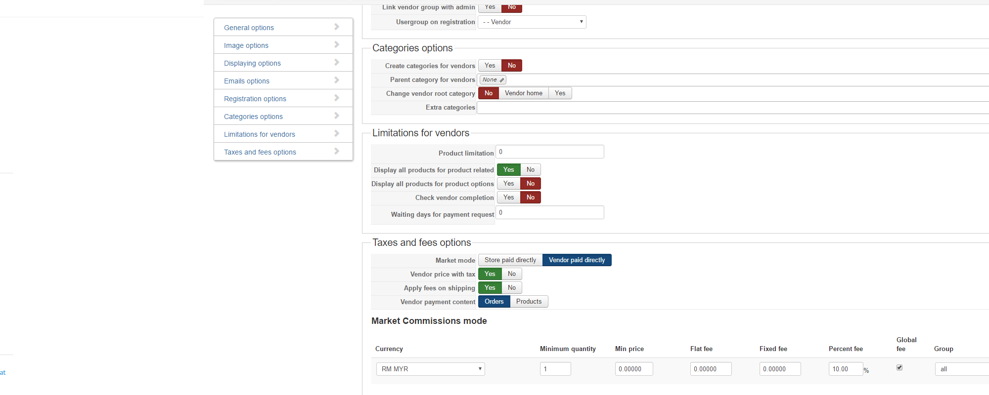

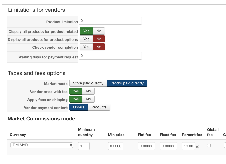

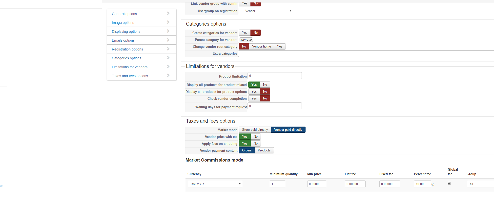

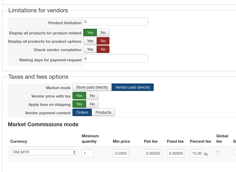

Can you please provide a screenshot of your HikaMarket global "Taxes and fees options" configuration ?
  • Posts: 23
10 years 2 months ago #245320
Hi, Thanks for reply, here you are attached screenshot.
Actually been tried almost all combination, store paid direct, vendor paid directly, vendor price w tax, apply fees on shipping..
Can't get the correct calculation for commission.

  • Posts: 26385
  • Thank you received: 4077
10 years 2 months ago #245327
I would check the "Global fee" setting ; otherwise your configuration looks good for that part.
What is the issue with the result ?

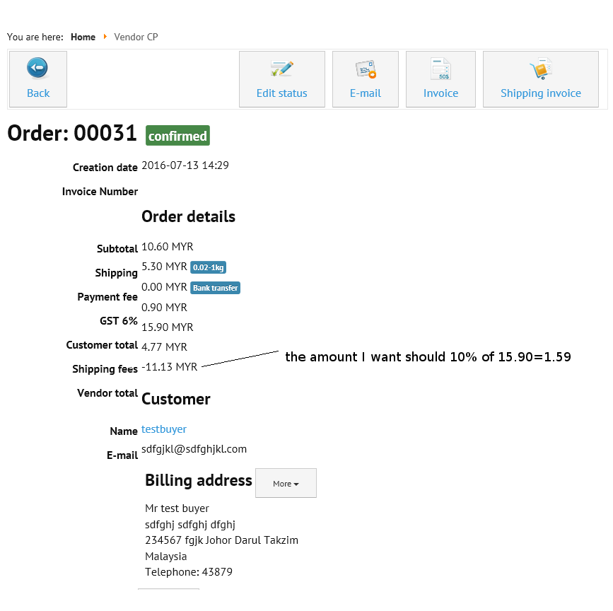

  • Posts: 23
10 years 2 months ago #245355

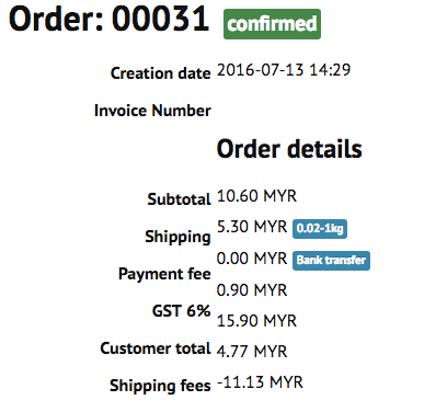

Hi, site access info send via contact form, pls check.

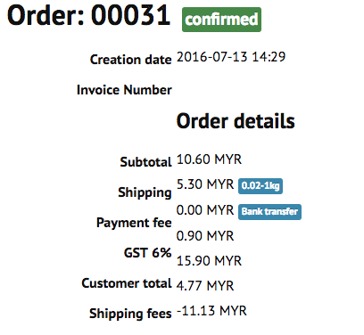

Cannot get the correct 10% commision amount from total order.
Example order detail:
Subtotal10.60 MYR
Shipping 5.30 MYR 0.02-1kg
Payment fee 0.00 MYR Bank transfer
GST 6% 0.90 MYR
Customer total 15.90 MYR
Shipping fees 4.77 MYR
Vendor total -11.13 MYR
The 10% commission should be 15.90*0.1=1.59
Thank you.
  • Posts: 26385
10 years 2 months ago #245391
While I understand the result of the order "00027", I cannot see how you got such result for the order "00031" because it is the order total (with taxes) minus the shipping price.
Thanks to your accesses I will duplicate your configuration in a local website and process some internal tests with a lot of debug trace.
  • Posts: 23
10 years 2 months ago #245397

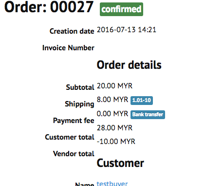

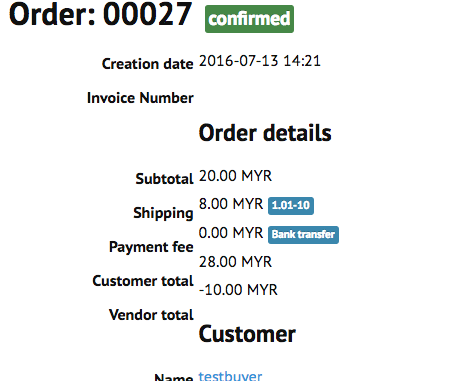

Order 00027 is not correct, the setting for this order is vendor paid directly, 10% commission for product only.
Subtotal 20.00
Shipping 8.00
Payment fee 0.00
Customer total 28.00
Vendor total -10.00 <-- 2(10% of 20)+8.00 this is not correct
10% commission of product should = 2.00 or (-2.00 negative mean vendor should pay me back the commission), the system calculate vendor total 2.00+8.00(shipping) while the shipping fee should belong to vendor.
______________________________________________________________

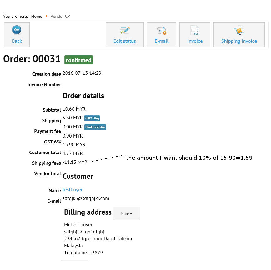

Order: 00031, I set the commission 10% for total order.
Subtotal 10.60 <--10 x 1.06 correct
Shipping 5.30 <-- 5 x 1.06 correct
Payment fee 0.00 Bank transfer <- correct
GST 6% 0.90 <-- 10+5 x 1.06 correct
Customer total 15.90 <-- correct
Shipping fees 4.77 <-- what is this, I never set any shipping price
Vendor total -11.13 MYR <-- 10% of total order should be 1.59 or -1.59
Thank you.

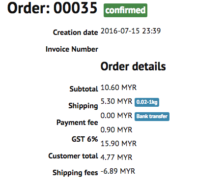

Hi, Yes, it seems permission issue with sftp, have to use ssh and sftp together. sftp put the file to user /home then use ssh copy/move the file, your user with sudo privilege.
__________

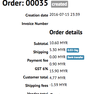

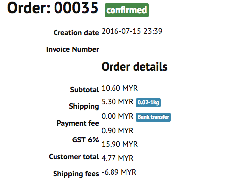

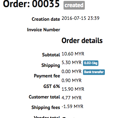

Result for order status "created" look good, however result for order status "confirmed" will add the shipping with store fees.
Order:00035
Subtotal 10.60 MYR
GST 6% 0.90 MYR
Vendor total -6.89 MYR
Thank you.

  • Posts: 23
10 years 1 month ago #245584
Hi.
I manually update the order status on front end vendor control panel, after update the order status to "confirmed" then back to order list and select/view the order again the vendor total will add up store fee and shipping fee.
  • Posts: 26385
10 years 1 month ago #245632
I installed a new package in your website ; the reprocessing of the order total is now better.
I saw a potential problem with the adjustments (because your vendors are paid directly, if the total changed there is a fund adjustment). but you had the issue mostly because the first total was not correct. So I'll continue to investigate on that but the latest version should be already better.
  • Posts: 23
10 years 1 month ago #245653
Thank you for the help. yes is show the correct figure now.
