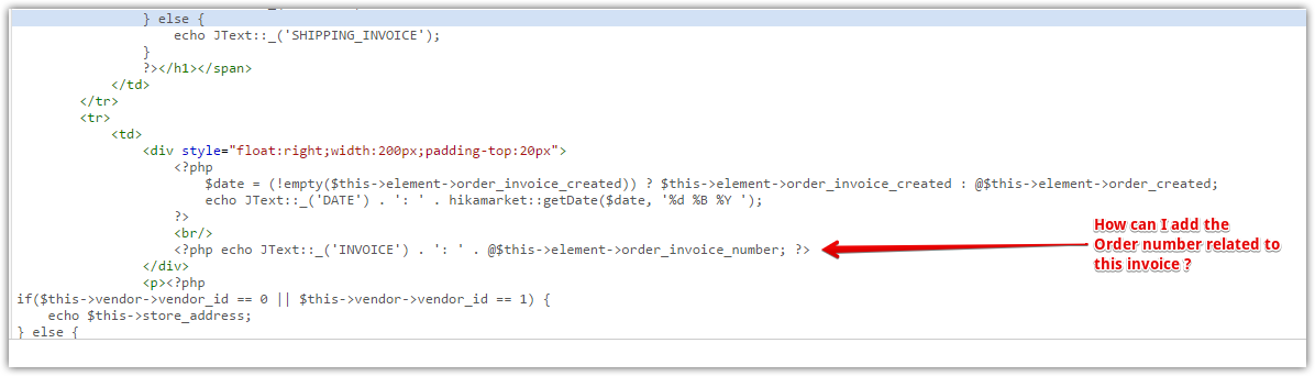

I would like to add the related order number to a given invoice :
Thanks in advance for your help an advise,

Knowing that you have access to the Order object (element), you have the order invoice number (order_invoice_number) but you have also access to the order number (order_number).
Afterwards, you'll need to write a small part of PHP to display the information where you want to put it.

Thanks Jerome,
Could I suggest to add it as a standard ?
I cannot remember, here in France/Europe, getting an invoice where the order number is not added... (ie. Amazon)
I would need it just below the invoice number.
simply as the invoice number like :
Numéro de Commande : xxx-x--xx
My PHP skills are really limited could you please provide me the php I should enter below the invoice number ? like :
<br/>
	<?php echo JText::_('INVOICE') . ': ' . @$this->element->order_invoice_number; ?>
<br/>
        <?php  Your code.............?>
				</div>
Thanks in advance for your help and advise,
Best regards,
Stéphane
And you're asking the code to display the order number.
I wrote you :
Which explain that you have the order_invoice_number and you want to display the order_number.
So we basically replace the two names and we change the translation "invoice" into "order_number".
<?php echo JText::_('ORDER_NUMBER') . ': ' . @$this->element->order_number; ?>
It does not require high programming skill, it is a strict basic replacement or something you already have.
It is a simple display (echo) of a translation and a value.
If you were asking some complexe code, like how to load the vendors link to an order, details about the multivendor internal structure or a lot of things ; I would gave you an answer.. Like I answered you even in my first message where I gave you the solution.
I gave you the instruction to tell you "how to fish" and you're right now telling me "no I want a fish".
So you now have the code to paste. But I don't think it is the right way to help you right now, to help you to understand and use HikaMarket (or HikaShop in that case due the fact that the view is the HikaShop view, so it is not really related to HIkaMarket so is not in the right section of the forum).
