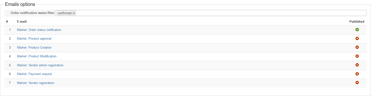

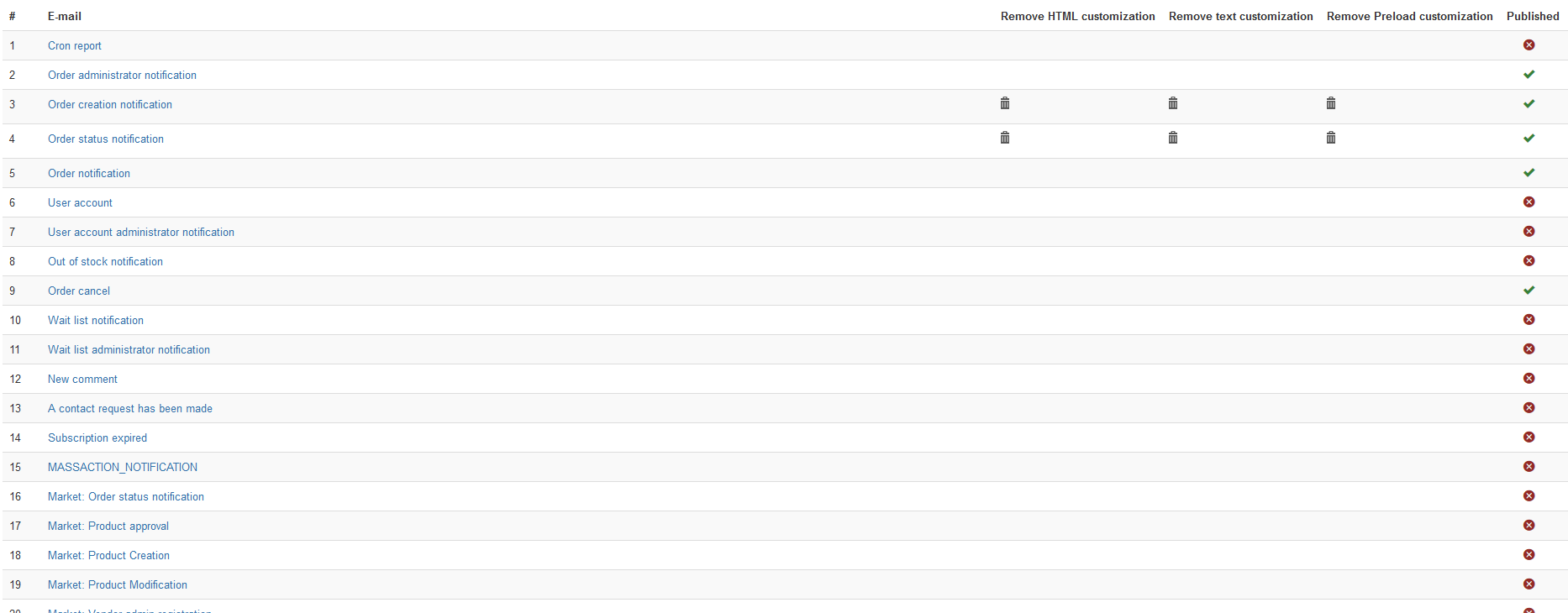

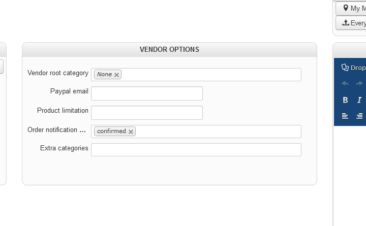

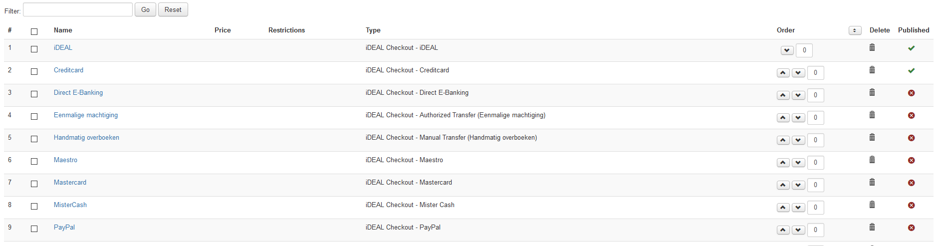

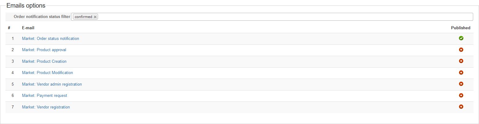

When i set the filter in the market on only confirmed, the vendor will not receive an email. Only when i put created in it. Then the email of order creation is sent. also when an order payment is canceled.
In attachment, you see i put only confirmed in the email options. But it seems it does not work.

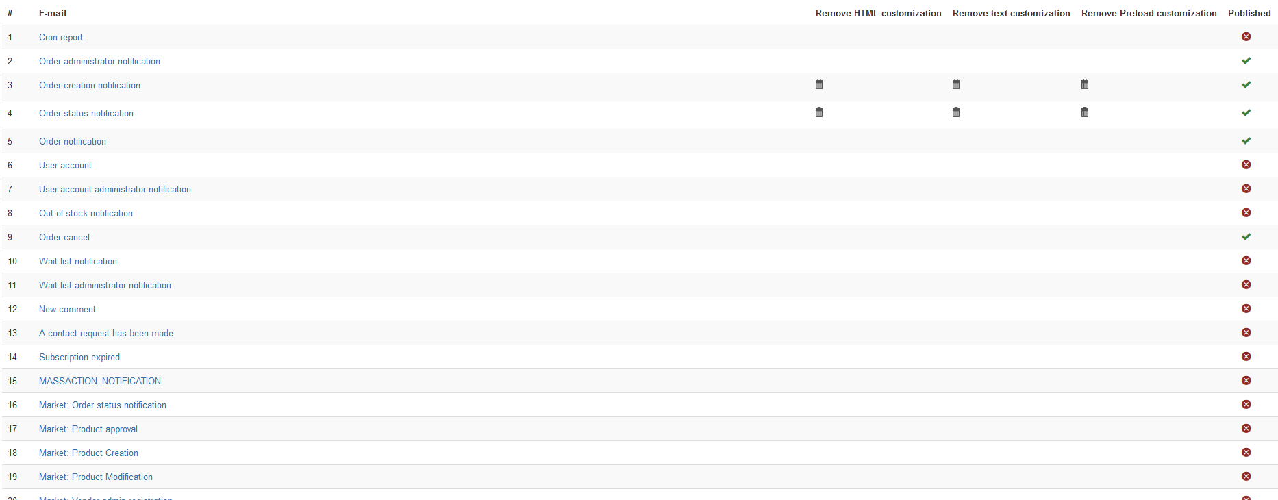

In the second attachment you see the published hikashop emails.
I do not understand, i really want the vendor only to get the confirmed email when payment is succesfull.

Please make the difference between the users in the HikaMarket main vendor account (which have the "order/notify" acl) and the email send by HikaShop itself to the administrator.
Regarding your email listing, I can see that the "Market : order status notifications" is unpublished ; which mean that HikaMarket cannot send any email.

  • Posts: 424
  • Thank you received: 11
9 years 8 months ago #258698

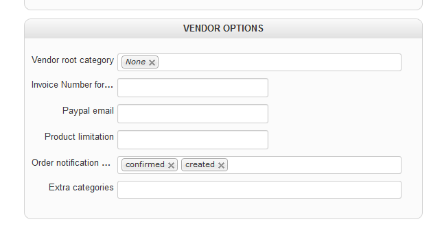

I understand that it is a little confusing. and my english is not that good. So i will try to explain and have made to screenshots.
in one you see at the vendor options that the order notification is only on confirmed and then no email will be sent to the vendors. but when i set both, confirmed and created, then only the email of order creation will be sent.

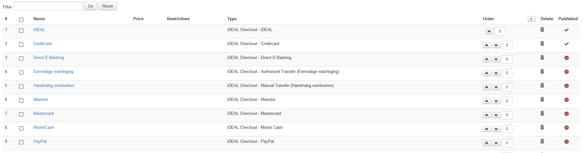

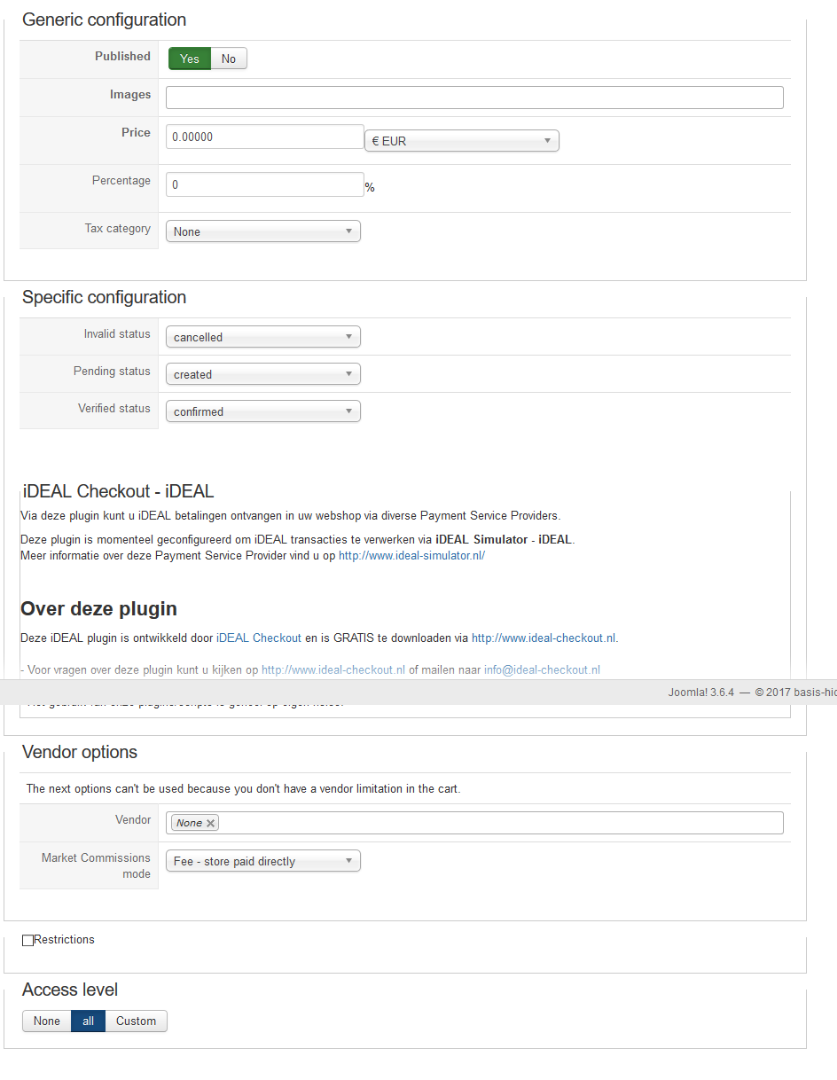

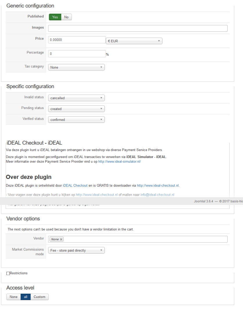

We are using the ideal component and the customer has 2 options to pay, via ideal or creditcard. see attachment. I
s this what you mean how they the orders are confirmed?? Where can we set the vendor sub-order right confirmed. in the vendor setting i showed you, in the screenshot i have set the confirmed on both the main vendor and the other vendors. but then i won't get an email, only when i put it on created i get emails to all.

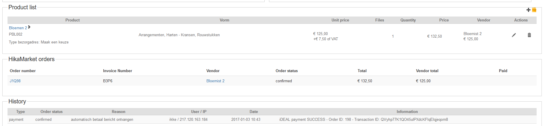

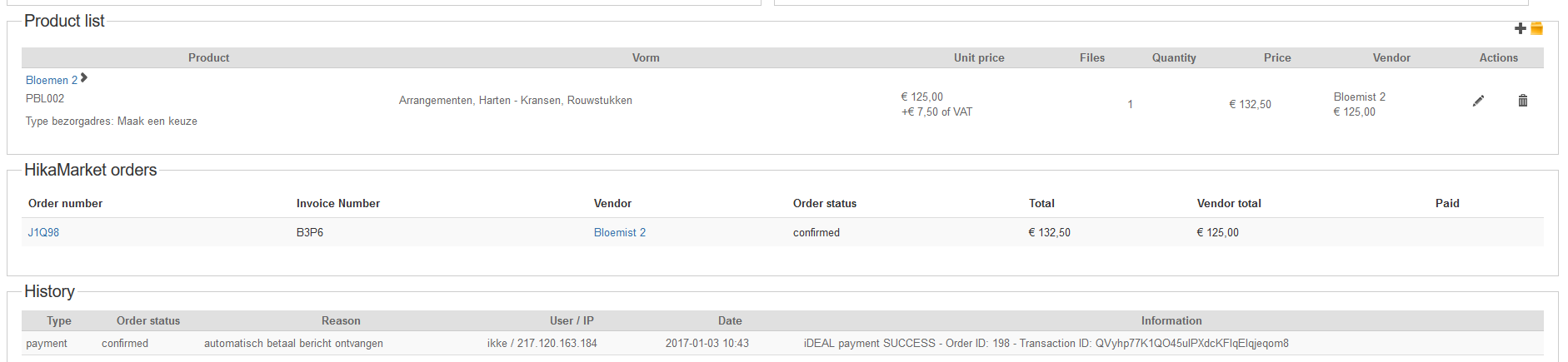

9 years 8 months ago #258806
hi, this is what i found in the order and the status of the vendor in hikamarket.
Let me try to explain what we want. In the shop, there are multiple vendors, when the customers order a product and makes payment via ideal or credit card towards the shopowner. Payment of vendors will come later and will be done by the shopowner himself.
We want the following.
when the customer places an order and makes payment he gets 2 emails. created and confirmed,
The shopowner also 2 emails, created and confirmed
The vendor only one email. confirmed even when he is not paid yet. so he can proces his order.
Hope you understand what we want to happen.
  • Posts: 26385
  • Thank you received: 4077
9 years 8 months ago #258809
Thank you for that screenshot.
As we can see in the order history, the order is directly created as "confirmed".
So the order is right created but there is no "update" of that order to change it from "created" to "confirmed" because the order is directly inserted in the database as "confirmed".
Because the order is confirmed, the order has been paid (the payment plugin has validated the paiement).
I don't see how it would be possible that the vendor receive that the order is confirmed if the order is not confirm.

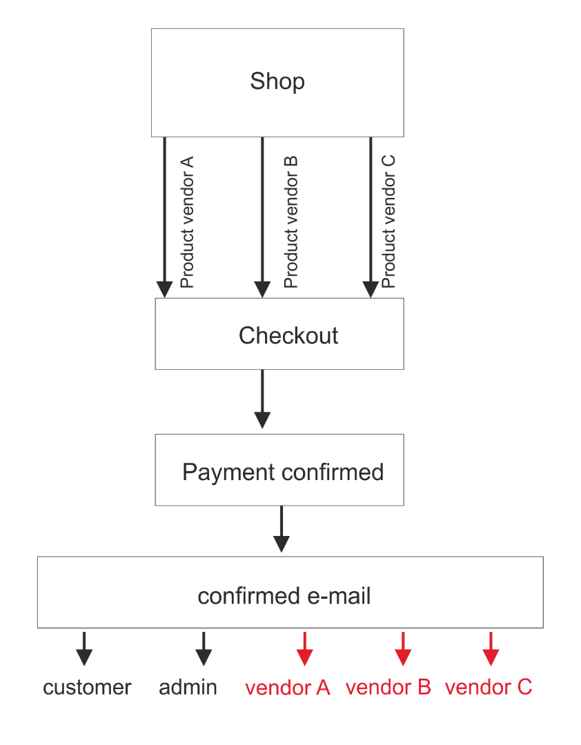

9 years 8 months ago #258934

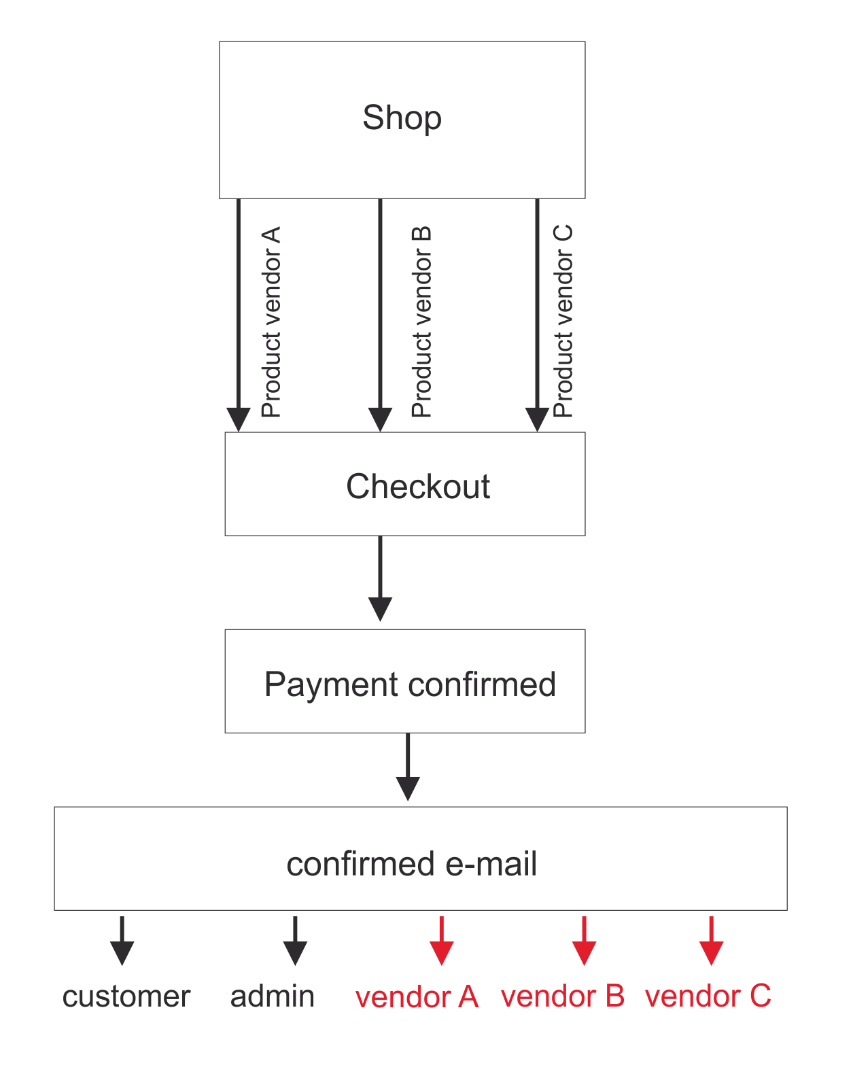

Oke a little confusing this all and sorry again for my bad english.
In the attachment i made i hope it will be more clear what we want.
The problem we have is that the vendors in the shop don't get a confirmed email notification.
What i draw is a flow how we want it to happen, customer orders different goods, pays the shop and after the payment plugin confirmed we want them to get the confirmed email.
hope you understand my problem and can help me out with this.
Thanks a lot!
  • Posts: 26385
9 years 8 months ago #258936
Thank you for the schema but it does not explain everything.
There are a lot of confusing points, like
You said that if you change the filters to have "created" and "confirmed", you receive the order creation.
But the order is created "confirmed", so there is no order with "created" status.
So I don't see how it is possible to HikaMarket to send an email at the creation of the email if that order status is "confirmed".
Do you see my point ?
Please use the "contact us" form in order to provide me some backend AND ftp credentials.
Please include the link of that forum thread so the HikaShop support team will automatically assign the message to me.
