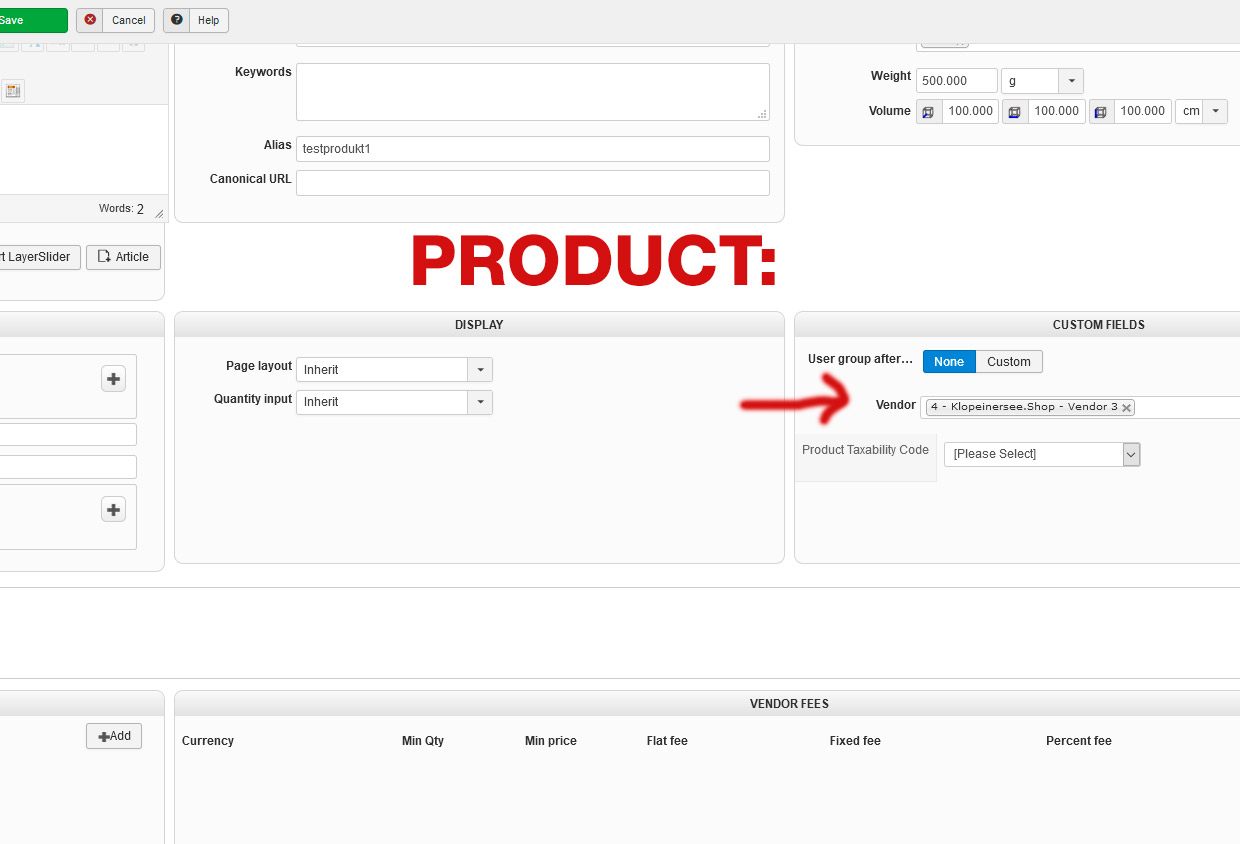

I have 3 different vendors, with different shipping methods and different payment methods.
The assigment of the payment methods work: when assigning a method to (for example) Vendor 3 ...then the chosen payment method is used in the checkout correctly for this Vendor 3.
Unfortunately it does not work with the Shipping methods:

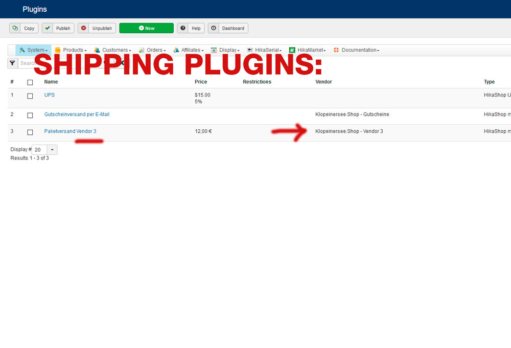

- When I assign a product ("Product Vendor 3") to Vendor 3
- Then assigning the Shipping plugin to Vendor 3

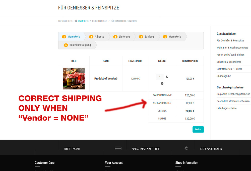

Result in Checkout:
The desired Shipping method is not found - "No Shipping method chosen"
When I change the plugin(s) to "Vendor= None"... then the Shipping Methods are all available in checkout.
But this is not helpful, I need different Shipping methods for different Vendors of course.
Thanks for your help!

Would it be possible to know more about your HikaMarket configuration ?
(for "market / general" section : www.hikashop.com/support/documentation/1...onfig_market_general )
The vendor shipping assignation is there for the attribution when using the "shipping per vendor".
So when HikaMarket create the virtual warehouses for the products, it can filter the methods to only provide the shipping method of the vendor (and the shipping methods without any vendor restriction).
