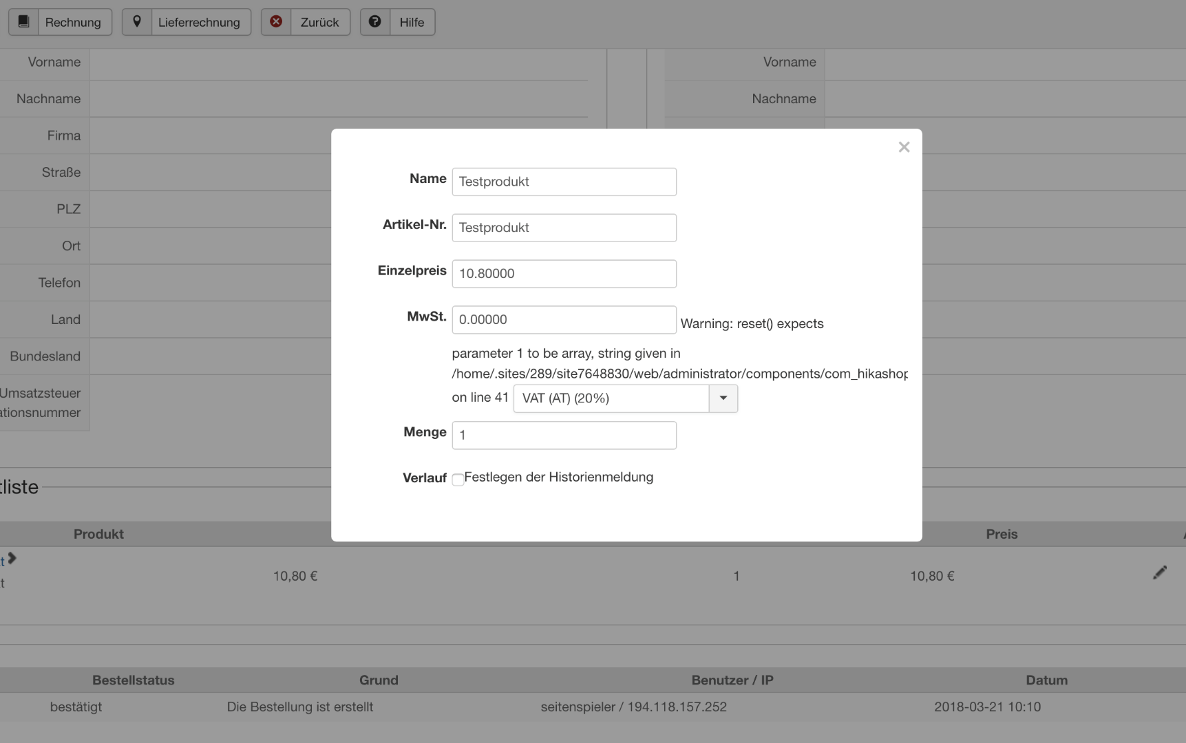

Hi there,
I have still trouble to create an invoice for my vendor including the tax of the products, he/she sold. I found an error message (attached), that could be the main reason for my trouble. Further more i made a little video to explain the workflow.

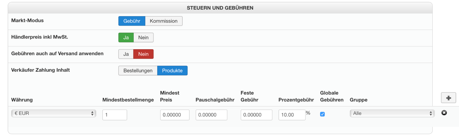

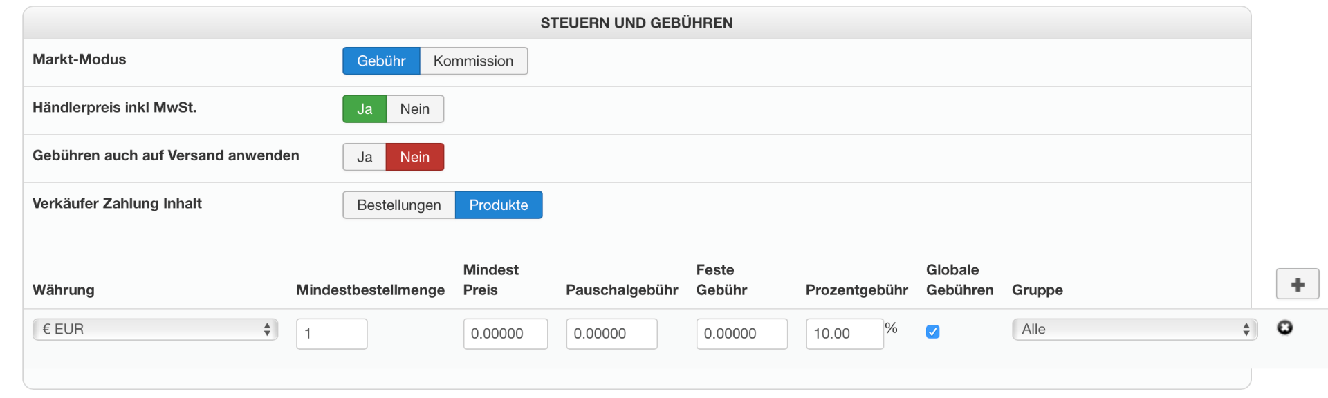

8 years 5 months ago #290093
here are the HikaMarket market taxe settings

8 years 5 months ago #290158
So you right have the setting to include the taxes during the processing of the vendor total.
And the vendor payment you are generating are based on the products (and not the transactions).
Please note that the vendor total is not reprocessed if you change the setting related to the inclusion of taxes for the vendor total.
So if you perform tests ; best is to create new orders to be sure that the total is right processed as you want.
Can you confirm us that the "vendor total" and the vendor subsales have correct values ?
By correct values, I mean that the "vendor total" should be based on the product prices with taxes ; so the fees are also applies on the product inc taxes.

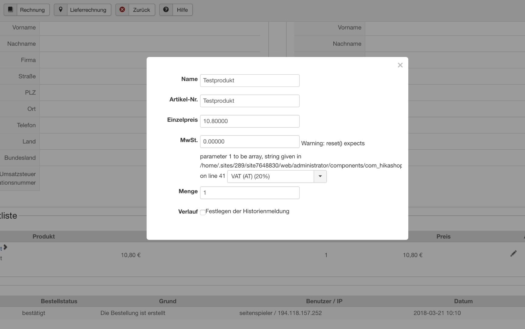

I've testet that with new test-orders and different settings (based on product/order, global fee/not global fee). Vendor total and subsales are correct and based on prize with taxes. The tax is calculated correctly, but not shown on the vendor's invoice. (The Invoice for the Costomer shows taxes) When i edit the suborder there is always following error shown:
Warning: reset() expects parameter 1 to be array, string given in /home/.sites/289/site7648830/web/administrator/components/com_hikashop/views/order/tmpl/edit_products.php on line 41
I don't think, that there is any issue in the market-setting. This line (41) is related to tax_namekey. Can it be that my general tax settings are wrong?
