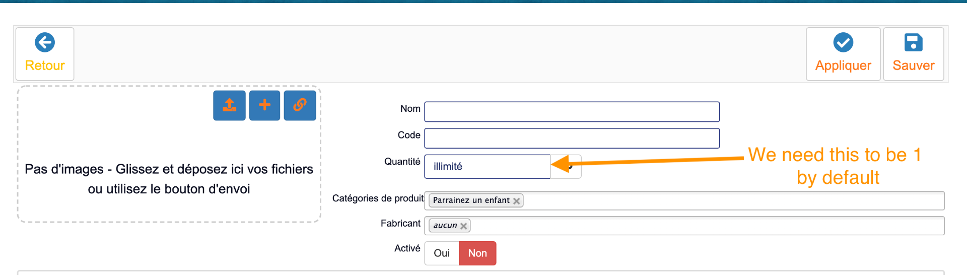

Each of our products is only available in one original unit. How can we make the inventory quantity to be 1 by default in the frontend ?
Thanks,
