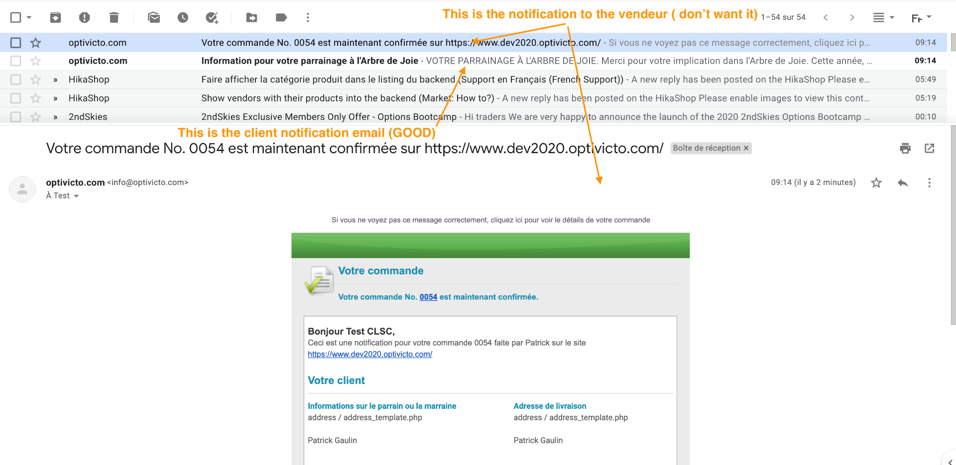

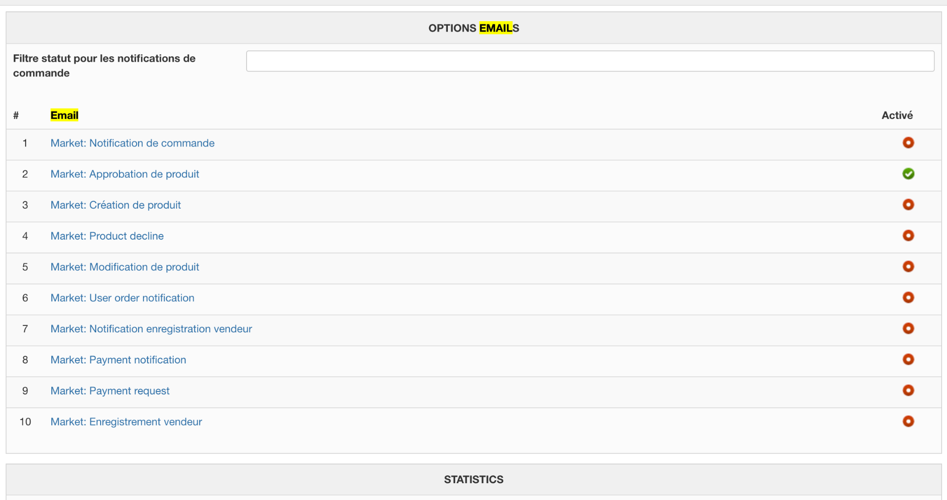

6 years 3 weeks ago #323237
We don't want vendors to receive email after a confirmation order. How do we turn all them off? the reason is that, in our situation for the Arbre de Joie project, they manage only the product creation. Not the orders.
Actually vendors receive confirmation emaiI. But the setup is at OFF
This is the setup in Hikamarket.
Thanks,

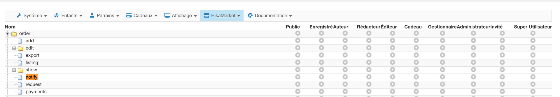

  • Posts: 628
  • Thank you received: 18
6 years 2 weeks ago #323313
Thank you. I will need a little more information.
I don't see any vendor column and all dots are grey. Which one should I turn off?
Do you have a tutorial on this ACL tool for Hikasmarket?
  • Posts: 26384
  • Thank you received: 4077
6 years 2 weeks ago #323316
I suppose your ACL are configured in the HikaMarket configuration page (default vendor accesses).
You an use the HikaMarket accesses panel to mark the "order / notify" as "red" ; so the feature will be removed for every groups.

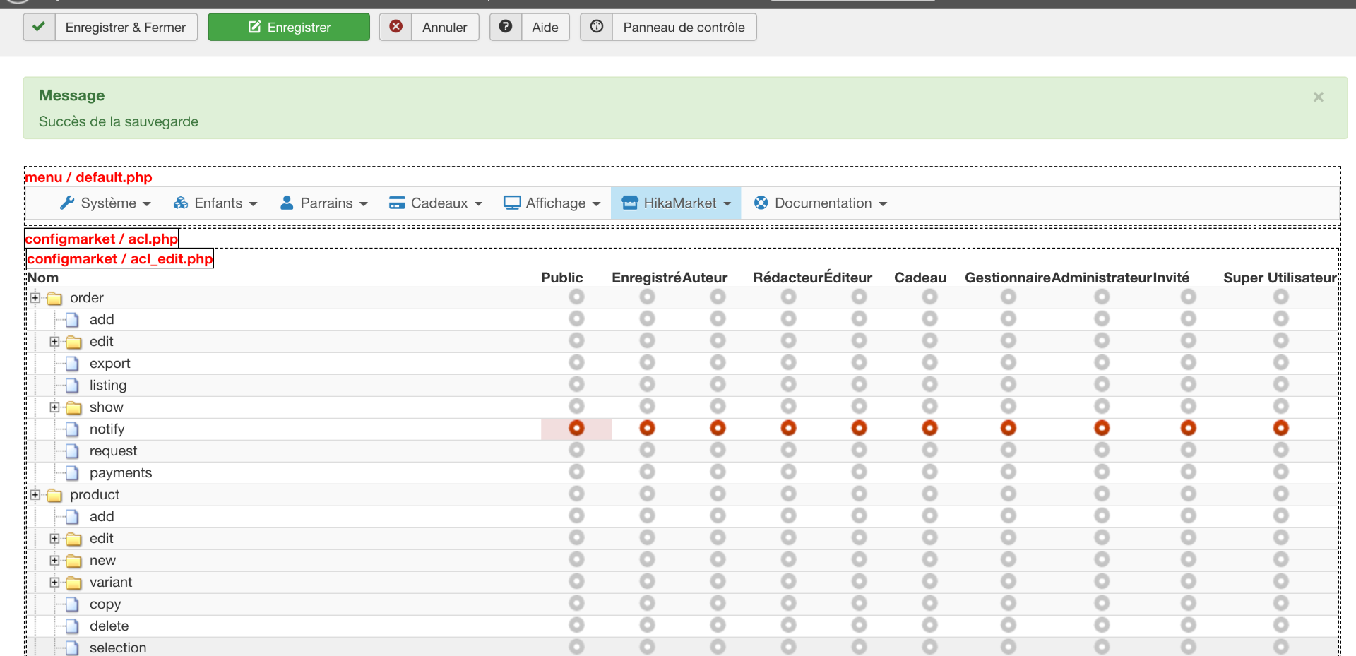

  • Posts: 628
6 years 2 weeks ago #323368
I tried this and Vendors still receive the notification. What am I missing?
Setup
Result:
Thank you very much

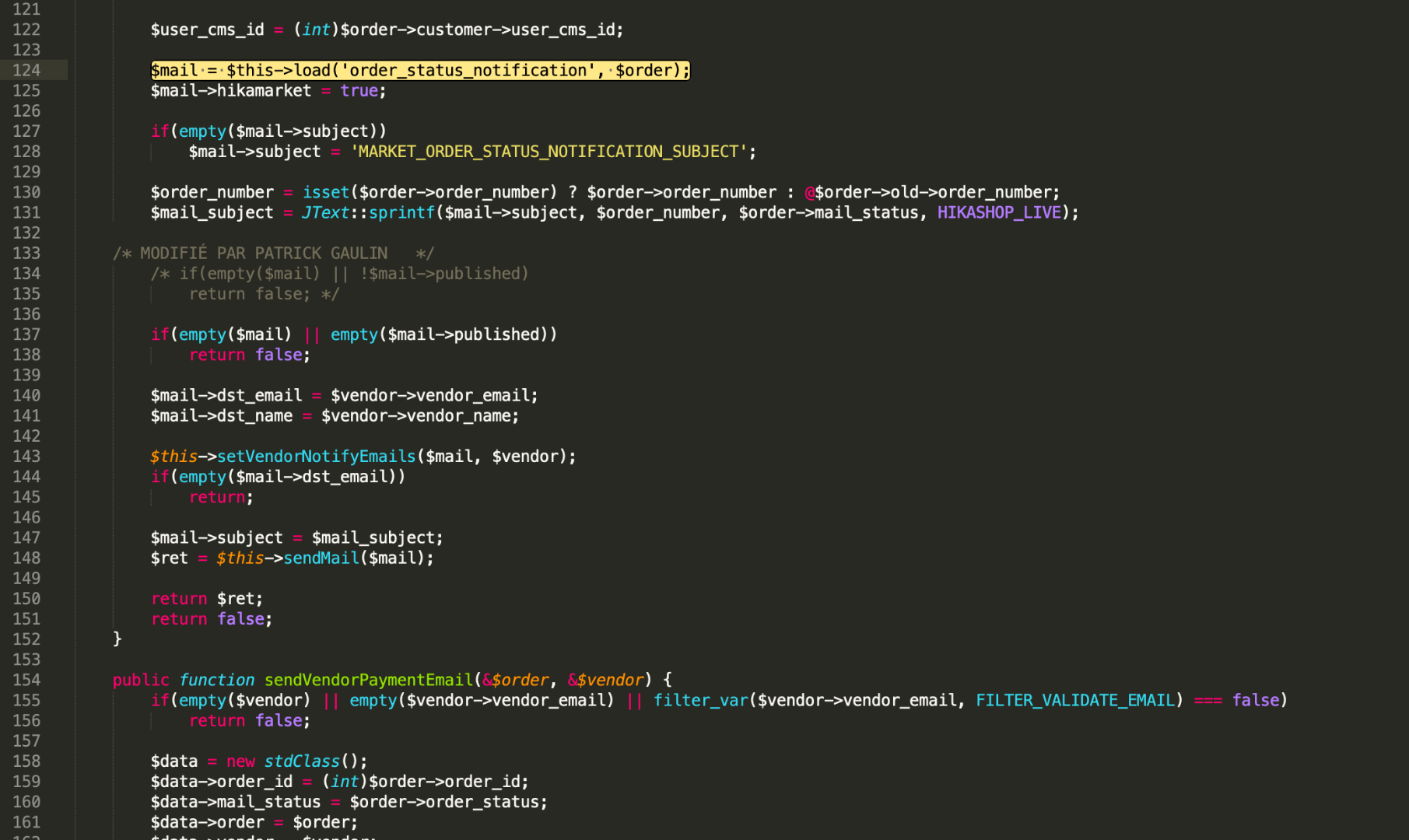

  • Posts: 26384
6 years 2 weeks ago #323409
In the HikaMarket "mail" class (administrator/components/com_hikamarket/classes/mail.php) you will find the line which load the vendor order status notification :
$mail = $this->load('order_status_notification', $order);
Few lines below, you will see the check for the published status for the email :
		if(empty($mail) || !$mail->published)
			return false;
You can replace that code by
		if(empty($mail) || empty($mail->published))
			return false;
and see if its helps.
But that's the only place in HikaMarket where that email is loaded and processed.

  • Posts: 26384
6 years 1 week ago #323518
Si vous souhaitez désactiver complètement cet email, vous pouvez utiliser le contenu suivant (pour le code cité précédement)
return false;
Ainsi, la fonction s'occupant d'envoyer l'email au vendeur s'arrêtera.

  • Posts: 26384
6 years 4 days ago #323762
Dans mon précédent message je vous indiquait devoir remplacer le contenu entier par simplement un "return false" afin de forcer le refus d'envoyer un email.
Dans le cadre où le problème persiste, nous pouvons envisager de vérifier votre site web.
Cordialement,

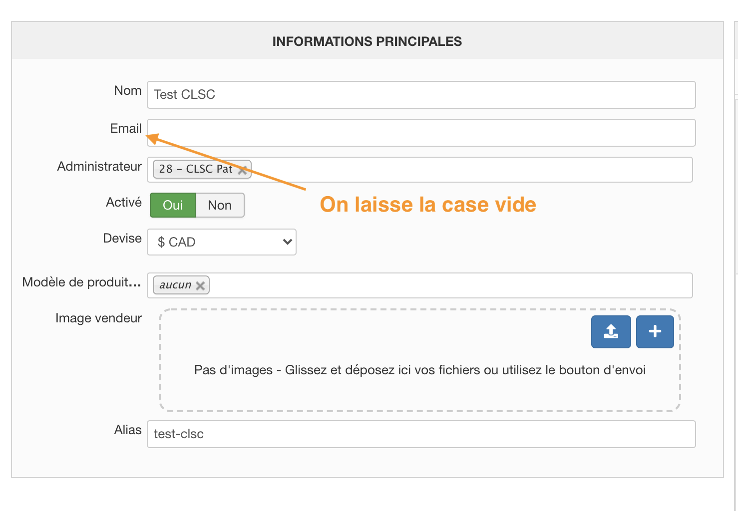

Je crois avoir trouvé un solution toute simple que ne requiert pas de hack.
J'ai fait un test et ça semble fonctionner mais, j'aimerais avoir votre confirmation que mon approche est fiable.
Dans la section Informations principales des options du vendeur, j'ai effacé l'adresse courriel et voilà! plus de courriel qui s'envoient.
Si je n'ai absolument pas besoin que les vendeur reçoivent les courriel du site, croyez-vous que c'est bon?
Je ne n'aurai pas à me soucier, ainsi, de ce hack lors des mises à jour futures.
