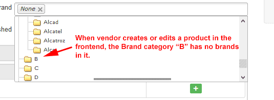

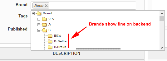

Everything shows pretty fine on backend when creating or editing a product...
but when vendor creates a product he can see the brands in...
Brands / 0-9
Brands / A
but he can not see the brands in
Brands / B
Brands / C
etc
Can you please help?

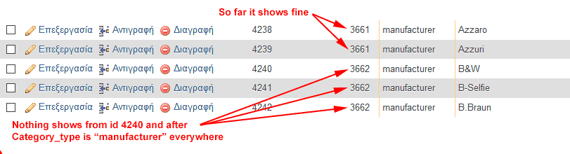

My first opinion would be that the brands might not have the correct "category_type" in the HikaShop category database.
Can you please check your database (using phpmyadmin) for some of these brands ? (some visible and some which are not)
  • Posts: 205
  • Thank you received: 12
5 years 7 months ago #329087
Here is a screenshot of the records (last records that show in brands selection and first records that do not show)
But as i told you, this problem does not exist in backend!
If there was a problem with the table records, this issue would exist for the backend area too.
