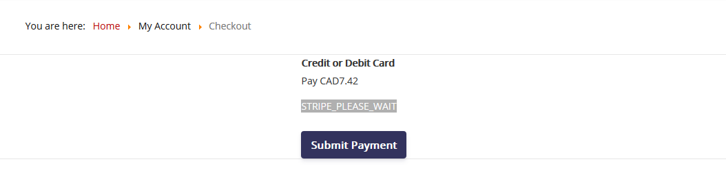

When I try to do a test checkout on my store (now that it's getting to that page) I get a page with a weird text string and a button.
I click the button and get... a whole lot of nothing.
Please advise what the problem is here, and where I can change that text string (looks quite crap.)

You'll find other rhreads about Stripe V3 (which is not related to the HikaMarket support).
These are the common issues :
1 - no https for the checkout/website
2 - wrong credentials
Since it's rhe Stripe JS from the Stripe website which set-up for payment form, you can't have logs in HikaShop payment log. But if you open your brwser consile, you shoukd have some message coming from Stipe directly.
