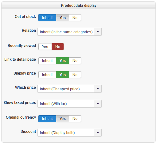

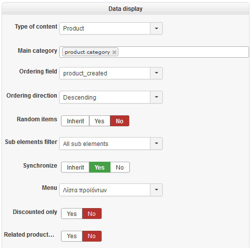

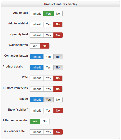

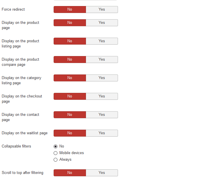

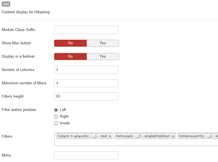

Thank you for your reply Jerome. It made me happy even if i could not make it work so far. The filter module does not seem to have any relation to the vendor's products. For example the brands filter dropdown list shows all brands and not only the brands of this vendor.
So what i have done...
Modules:
Hikashop Filtering Module
and
HikaShop Content Module
on vendor's page.
HikaShop Content Module settings
Hikashop Filtering Module settings
