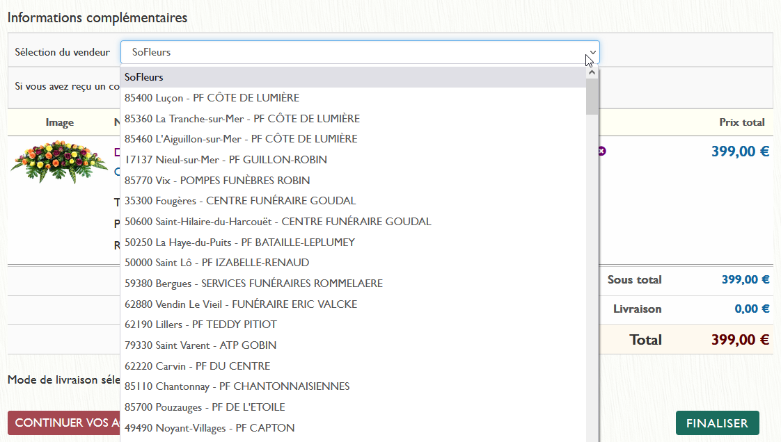

I have created a "select_vendor" field that is displayed at checkout.
The problem is that when I select the drop down list view, the sellers are displayed in the order of their registration and I need them to be displayed in alphanumeric/alphabetical order.
If I select the Namebox view, the order is correct but only some of the sellers are displayed.
If I select the Popup view, the whole site is displayed in the popup with a message that the seller has expired and there is no list of vendors...
How can I change the display to a drop-down list with alphanumeric/alphabetical order?
Thanks for your help

Edit the file "administrator\components\com_hikamarket\types\vendor_selection.php" and replace the line
By
And it will change the default sorting for the vendors.
Code:
protected function getVendorList($filters = array(), $sort = 'id') {
Code:
protected function getVendorList($filters = array(), $sort = 'name') {

Hello Jerome,
Thanks for the answer, it works fine.
