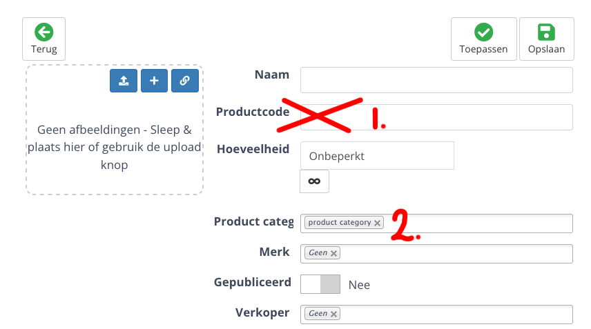

Good afternoon
I feel I am quite familiar with Hikashop but I don't know where to start with HikaMarket and have heeps of questions.
My first questions are:
1. in the front-end view: where to disable the view of fields like "product code".
2. In my front-end view a choice of categories is possible. How to limit this to one category?
Greetz
Dick
  • Posts: 26384
  • Thank you received: 4077
3 years 6 months ago #349713
1 - Best is to configure the default ACL in your HIkaMarket configuration page.
You will find two sections, one for the default ACL and another for the main vendor ACL (so your access as an Admin to manage the entire store).
2 - If you're connected as an Admin (as the "main vendor"), you can't block that.
But for your vendors you have a setting to limit te vendor to its "vendor category".
www.hikashop.com/support/documentation/1...nfig_market_category
