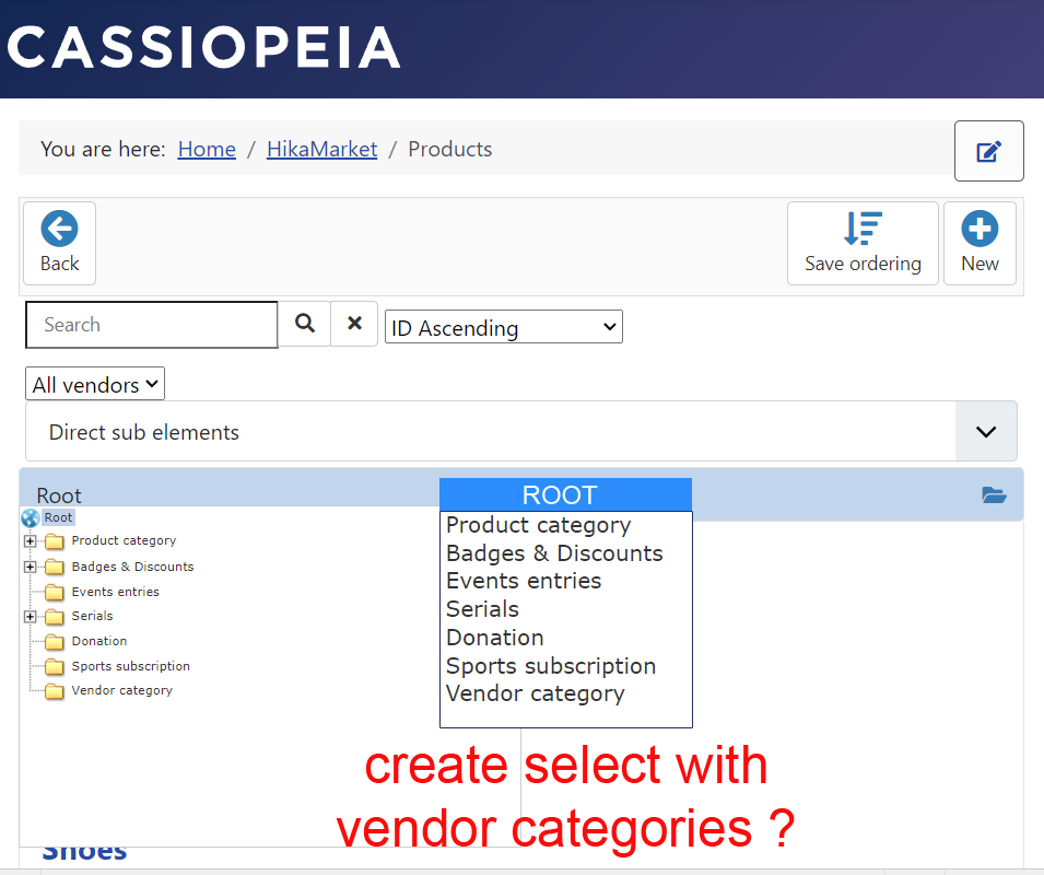

On the Products page I would like to have a select with the categories the vendor can access
A little help? Thanks

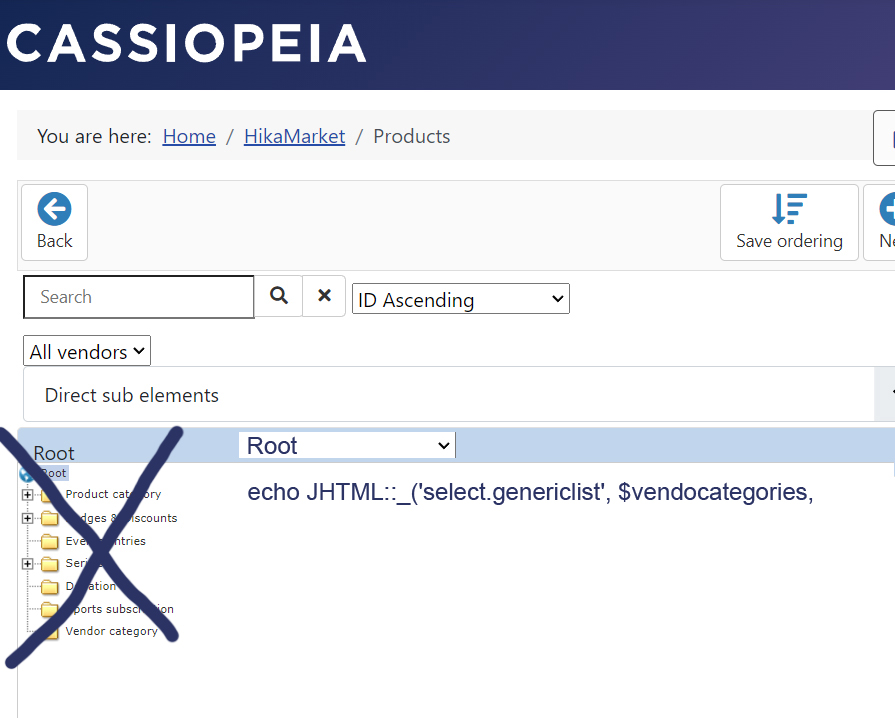

3 years 4 months ago #351586
echo JHTML::_('select.genericlist', $vendocategories...

3 years 4 months ago #351613
Unfortunately my English is not good :(
I would like to have a drop down menu for categories
Using echo JHTML::_('select.genericlist', $results, 'categories','onchange="document.location.href = this.value"..
3 years 3 months ago #351617
Okay.
So you want to keep the "explorer" but you need to override the "productmarket / listing" view to comment the display of the explorer and place your own code instead.
You'll find the display of the category tree (explorer) via that line
echo $this->shopCategoryType->displayTree(...
