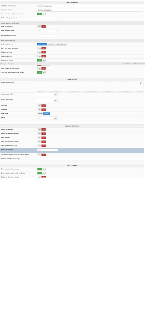

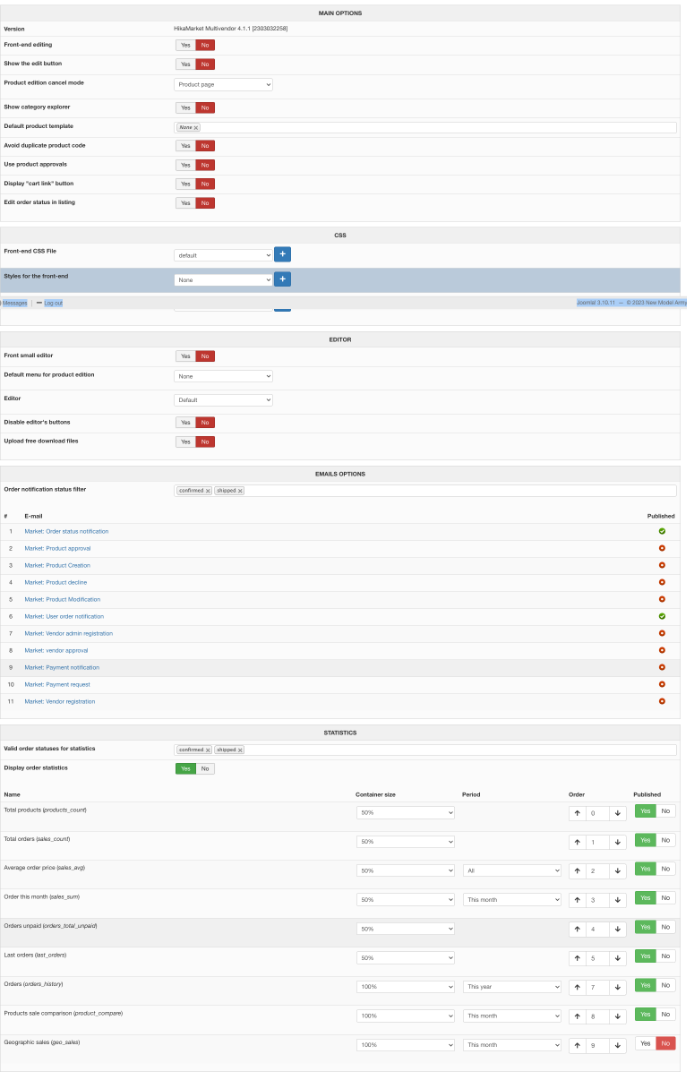

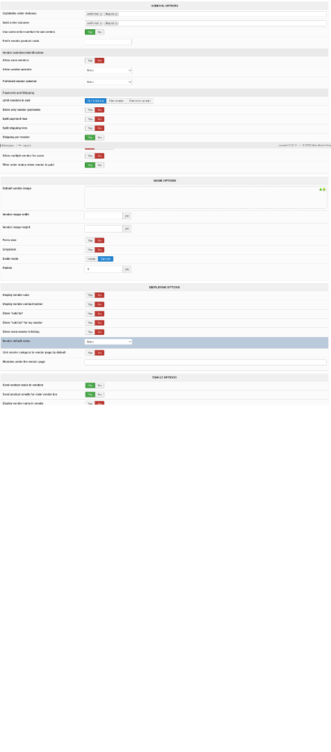

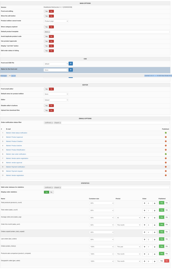

I'm sure I'm probably just missing something obvious; however, when a new order is confirmed, the vendor order status update email isn't being sent.
From what I understand of the configuration, they should be working.
The use case for this shop is that all payments are taken by the store, with HikaMarket being used to send order notifications to the individual vendors.
I've attached screenshots of the HikaMarket settings being used.
KH

  • Posts: 46
3 years 4 months ago #351946
Thanks for your reply Nicolas.
I've checked the email history, and I can see the customer and admin notifications but no vendor notifications.
When checking in system>email the email looks to be published - see attached screenshot.
Is there anything else I should be checking?
Best regards
KH

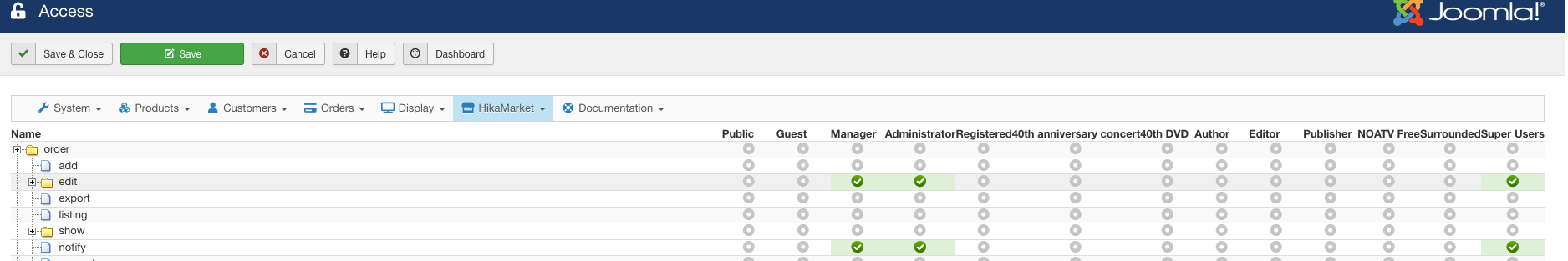

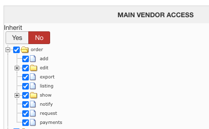

  • Posts: 26387
  • Thank you received: 4078
3 years 3 months ago #351962

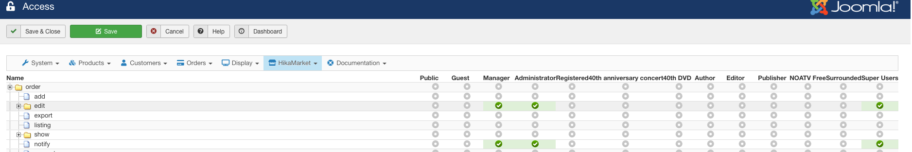

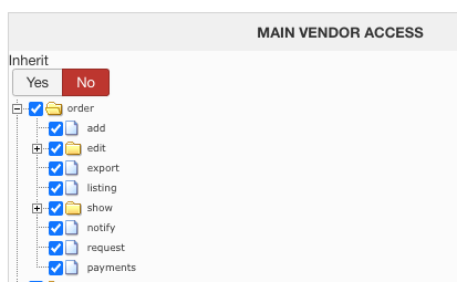

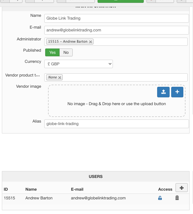

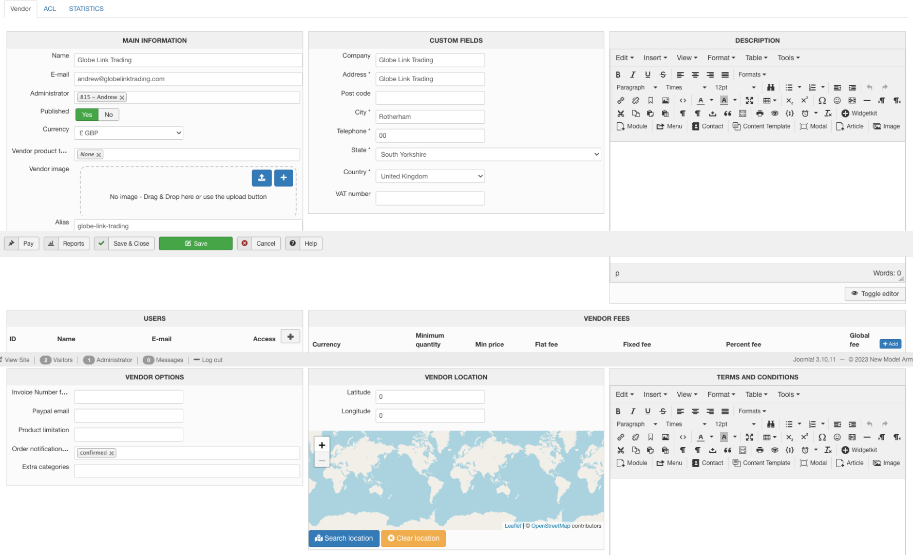

Please check your HikaMarket ACL to be sure that the ACL "order/notify" is right available.
And please add the "administrator" as a "User" under the vendor configuration so, the vendor will have an entry for that user to tell him to send the notification to that user (and email address).

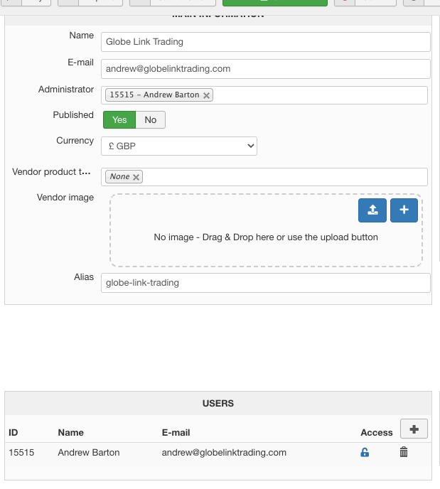

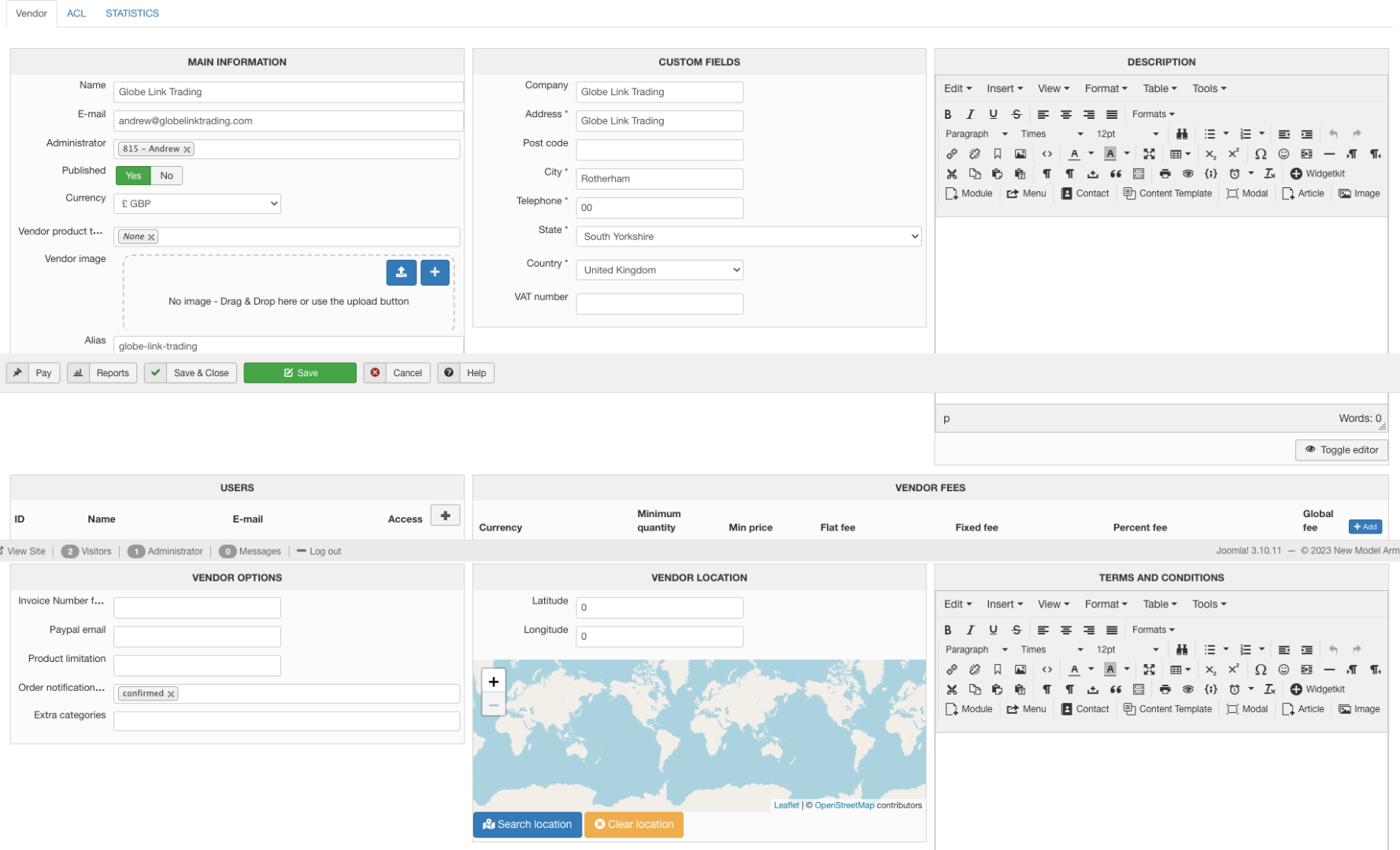

  • Posts: 46
3 years 3 months ago #351981
Thanks, Jerome,
Still no vendor email!
I've attached screenshots of the settings
Any other ideas?
KH
