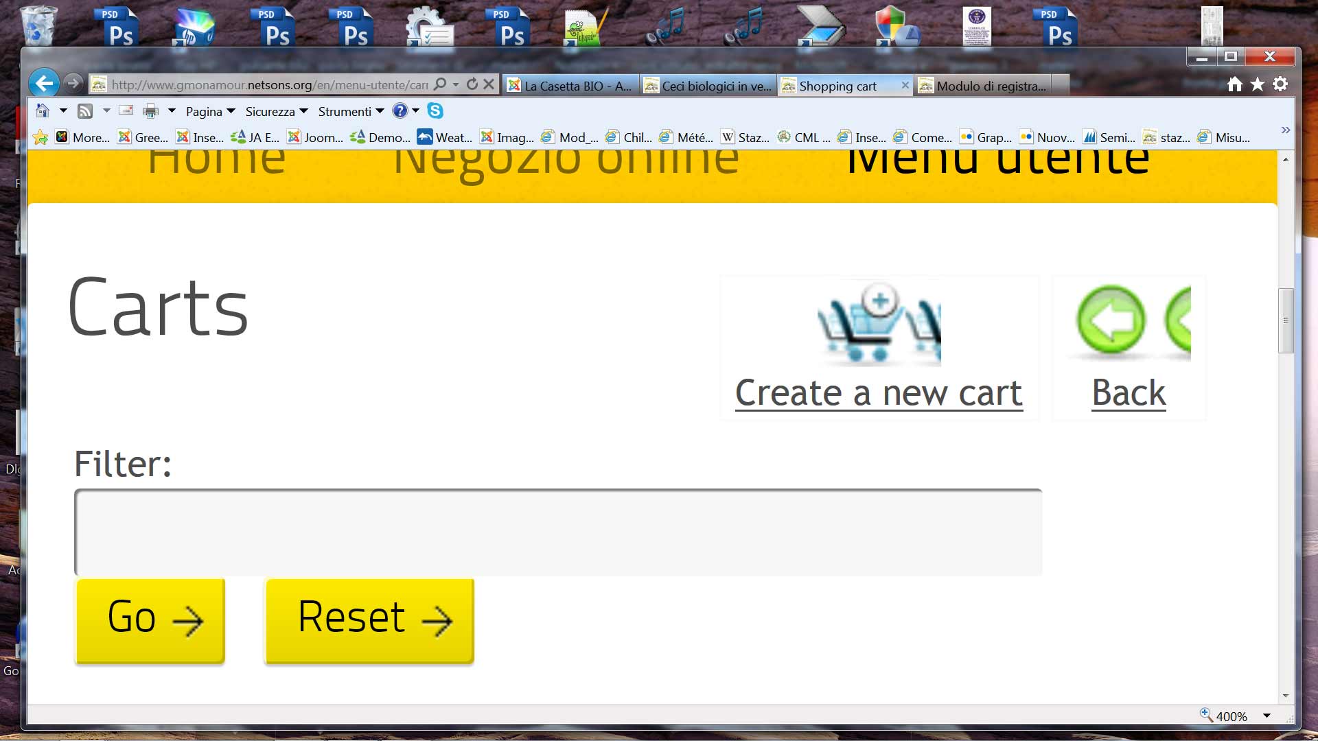

I'd like to change my template with a new responsive template one.
On my test site i noticed two issues.
First
The menù to chose the variants is vertical and so a little bit confused.
You can see it here:
www.gmonamour.netsons.org/en/negozio-onl...o/6-ceci-bio-vendita
In my actual template i have it orizontal and it is better.
How can i set it orizontal?
Second
Some Hikashop icones are quite double.
You can see them in my screenshot attached

13 years 5 months ago #97880
The variants problem is a template issue. You have to remove the css property "display: block;" on the "label" in the file " www.gmonamour.netsons.org/templates/kaiser/css/formelements.css "
For the doubled images it's probably because there is a repeat applied on the images. Try to set the repeat to repeat: no-repeat; in css.

13 years 5 months ago #98138
You have to edit the frontend css file in "Config > Display > CSS" and edit the class: .icon-32-add_cart to add the property: background-repeat: no-repeat;

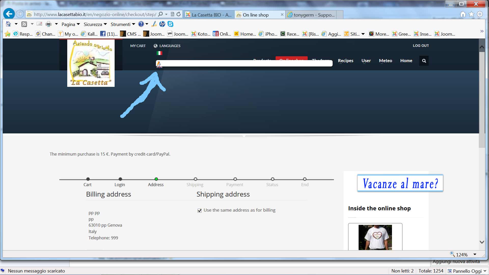

I'm sorry but i had to chage my template again!
Now i have the same problem tha you can see here: www.lacasettabio.it/en/negozio-online/pr...c-chickpeas-for-sale
Also on ceckout>adress i have the icon "change" out of its place. You can see it in my screenshot.

  • Posts: 26386
  • Thank you received: 4078
13 years 4 months ago #100897
It's a known issue which come from the template.
Some templates have a bad handling of joomla 3 bootstrap rules.
www.hikashop.com/en/forum/4-how-to/80674...floating.html#100190
www.hikashop.com/en/forum/4-how-to/77125...-hover-js.html#84203
www.hikashop.com/en/forum/4-how-to/80474...-checkout.html#99408

13 years 4 months ago #100958
you should then try the second solution which is :
The proper solution would be to not use .modal but div.modal in the their extension's modal.less file.

13 years 4 months ago #101106
You have to edit the tempalte css file in order to replace the .modal class properties to div.modal.
By this way it will not display the edit buttons in popup.

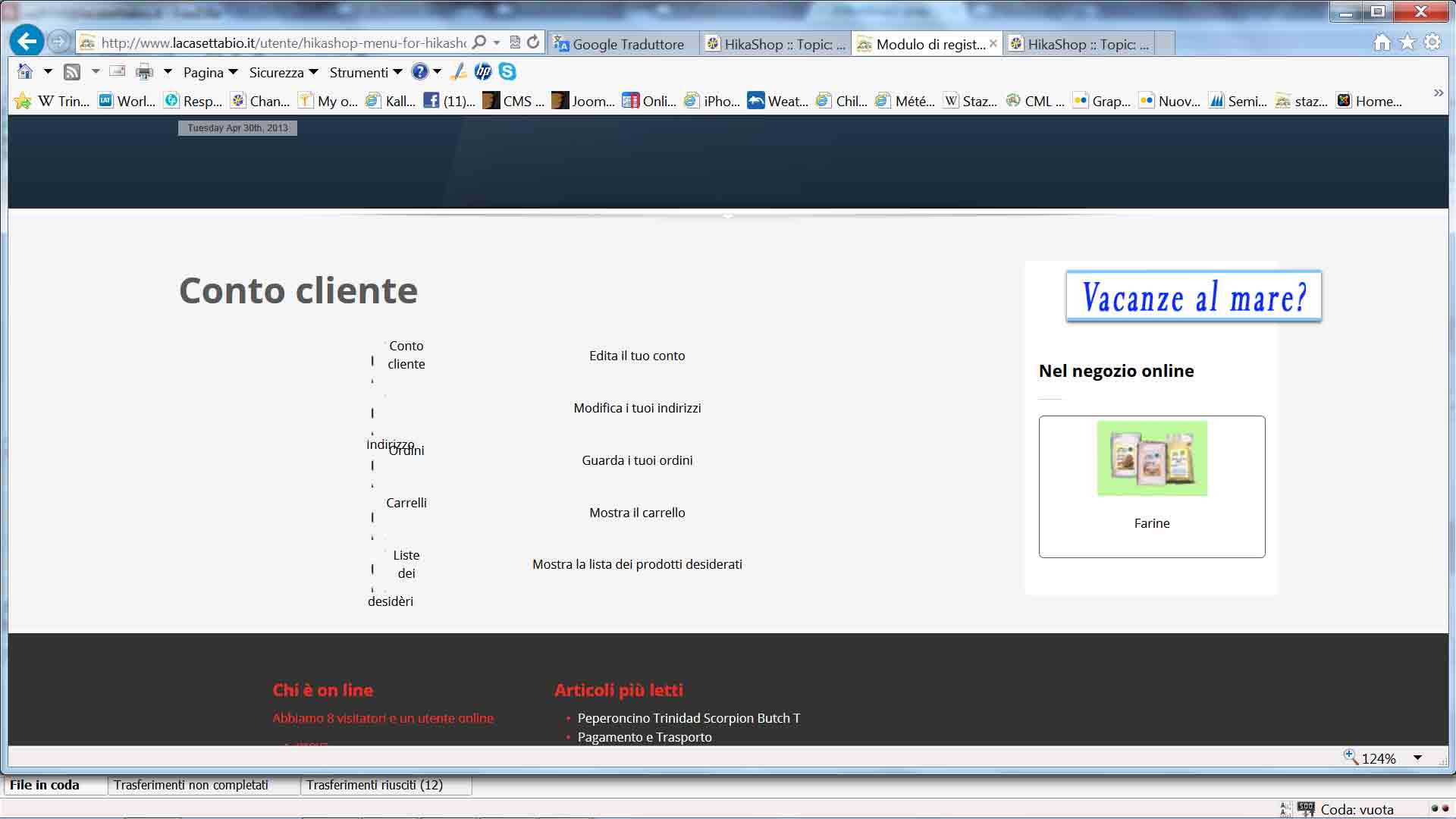

  • Posts: 719
13 years 4 months ago #101590
I'm very sorry but i noticed a new problem on the user control pannel.
There is something strange and wrong as you can see on my screenshot.
I have the same problem with my test site where i didn't change the template modal class.
Could you help me please?
my site with Hikashop
www.lacasettabio.it
