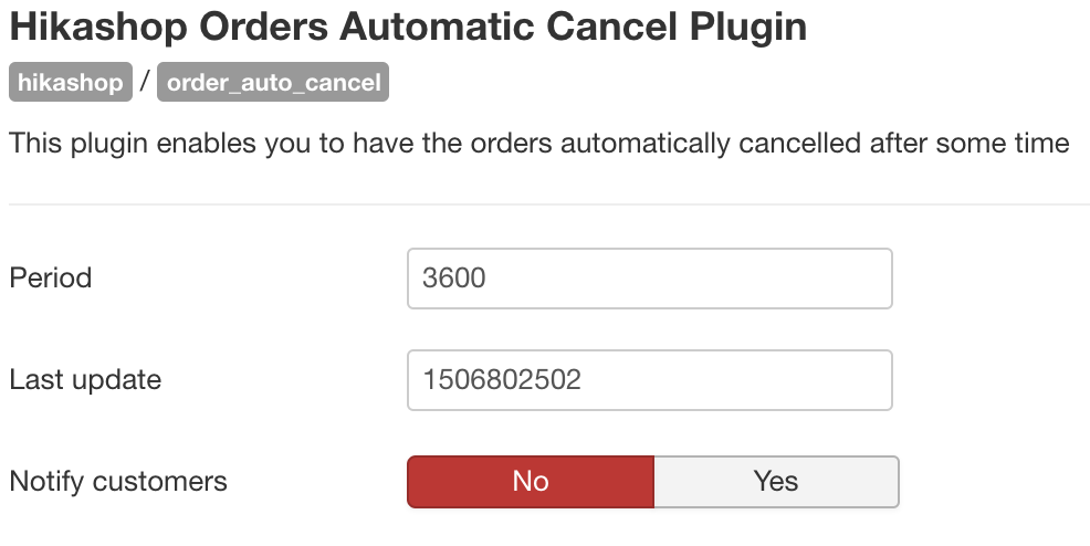

It seems as if the HikaShop Orders Automatic Cancel plugin sends a cancelation email even when it is set not to.
I found this thread www.hikashop.com/support/forum/orders-ma...cellation-email.html
and updated plugins/hikashop/order_auto_cancel/order_auto_cancel.php but I won't know if it works until an order is automatically canceled.

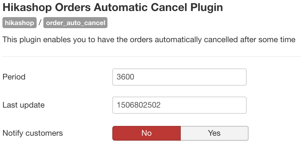

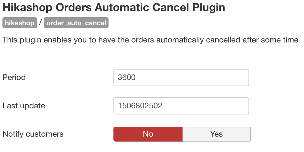

Sorry Jerome. I think I was not clear. I know the orders are getting canceled by the "order auto cancel" plugin which is exactly what I want but the plugin sends them an email notifying them of the status change which I do not want.
It still sends an email even when "Notify customers" is set to No (see attached)
