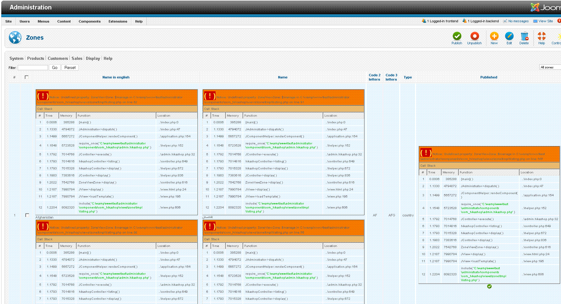

i am also getting an error why i go to the zones section

  • Posts: 86180
15 years 2 months ago #19659
You payment methods are not showing because of one of the problems listed there: www.hikashop.com/support/documentation/i...ins-listing.html#faq
If you think that it's setup correctly, please provide some screenshots of the different screens related to the payments and zone configuration talked about in that FAQ so that we can check them.
For the notices on the zones listing: If you redownload HikaShop and reinstall, it should fix the problem.
