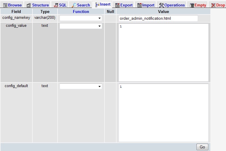

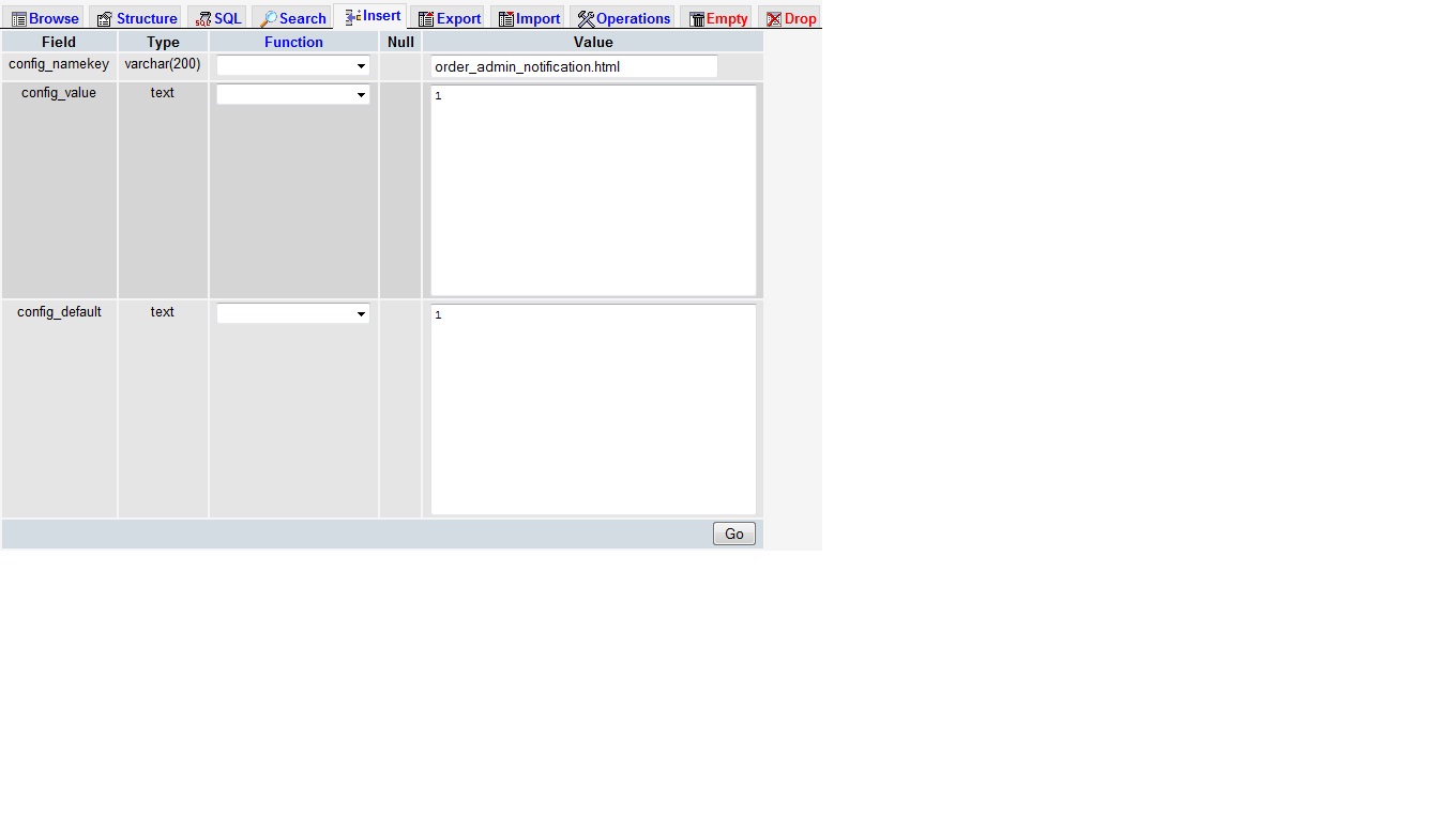

  • Posts: 37
15 years 4 months ago #15267
Just checked the settings once again. Please see the screenshot.
Please advice.
Last edit: 15 years 4 months ago by zoomyman.

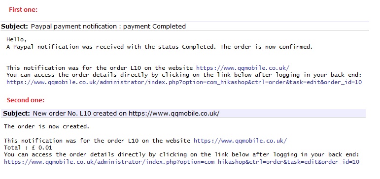

Are you talking about the email sent when the order is created ? Or the email when a payment notification is received ?
Maybe you could do a screenshot of the email received ?
  • Posts: 37
15 years 4 months ago #15270
There are two emails I am getting as an Administrator:
Thank you.

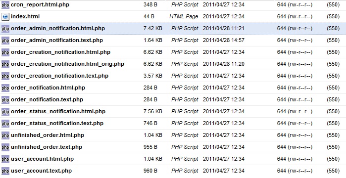

  • Posts: 86181
15 years 4 months ago #15296
Do you have the file order_admin_notification.html.php ? Do you have a file order_admin_notification.html.modified.php ?
I must say that I'm starting to be out of ideas...
That might require to put traces in the code in order to understand the problem.
  • Posts: 37
15 years 4 months ago #15310
Yes I have order_admin_notification.html.php, but I do not have the order_admin_notification.html.modified.php . Does it have to be in the same folder? If so, there is no file called order_admin_notification.html.modified.php in media/com_hikashop/mail folder on my server. I have just checked, file called order_admin_notification.html.modified.php is also missing in an installation package (com_hikashop_starter_1.4.9_2011-04-29) .
