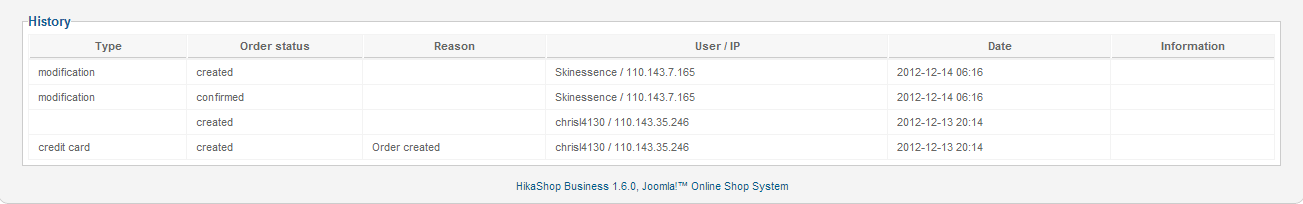

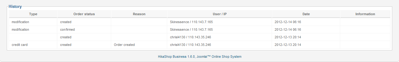

  • Posts: 14
13 years 8 months ago #82187
The history plugin is already enabled. On the bottom of the detailed order I can see the history table. The table contains the following columns:
type, order status, reason, user / ip, date and information
Unfortunately none of its columns show any information about the actual credit card info. The last column named information is all blank...
We are using version Business version 1.6
  • Posts: 86113
  • Thank you received: 14210
13 years 8 months ago #82469
The credit card information should be in the last column "Information".
Since the column is empty, it means that there was no information recorded at the moment the order was created, or that you already clicked on the link which allows you to delete the information from the database (there is a message with a link at the top of the order details page telling you to delete the credit card information once used for security reasons).
So anything you do won't make it appear for that order. You should try with a new order.
