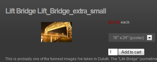

As you can see in this example, the name of the product itself contains one of the characteristics that I have applied to this product. I'm wondering how to remove it so that this page simply says with the name of the item is, not what the options are IN the name.

You need to turn off the option "Append characteristics value to product name" in the Display tab of the config.

Ok, I did that and I checked the difference between having it on or off, and having it on adds the colon's, and having it off removes the colons but leaves the characteristics. Maybe I'm just missing something.

Looking again to your screenshot and with your new comment, it seems that what you're seeing after the product name is not the variant name but the variant code. It should normally be hidden in CSS.
There must be something on your website screwing it.
Could it be that you're using a rockettheme template and you have that problem: www.hikashop.com/support/forum/4-how-to/...e.html?lang=en#15467 ?

Ok, yes I have a Rocket Theme template, I found this at that link:
"By the way, if you want to circumvent easily the problem, instead of using CSS to hide the product name, you could edit the file show of the view product via the menu Display>Views and remove the code :
echo $this->element->product_name;
and the code:
echo $variant->product_name;
That way the product name won't be displayed by PHP at all."
Which file should I edit?
"listing_img_title"?
I know I'm so close?

That instruction was to display the variant name. What you want is to remove the product code...
You should edit the file show of the view product and remove the lines:
echo $this->element->product_code;
and:
echo $variant->product_code;

Thank you so much, this worked perfectly.
