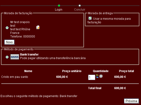

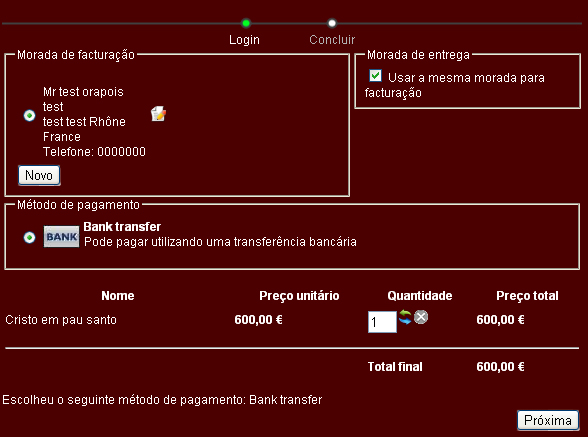

I'm sorry to say this, but there is only 2 possibilities!!
1st: You didn't used the user and pass I gave you. Cause I'm still having some problems with the emails that was why I gave you those.
Or you didn't understand how to work on it! I'm placing a picture with those things you didn't found

  • Posts: 86180
15 years 2 months ago #21418
I got the exact same screen as the screenshot you posted.
The shipping is activated automatically if you have the shipping view in the "checkout workflow" option of the configuration and that you specify a weight for the products (or that the option "Force shipping regardless of weight" is activated).
If you don't want hikashop to require a shipping selection for your products you should either:
1. remove the weight from the products if you set one or deactivate the option 'Force shipping regardless of weight' of the configuration.
2. remove the shipping_ view from the "checkout workflow" option of the configuration.
