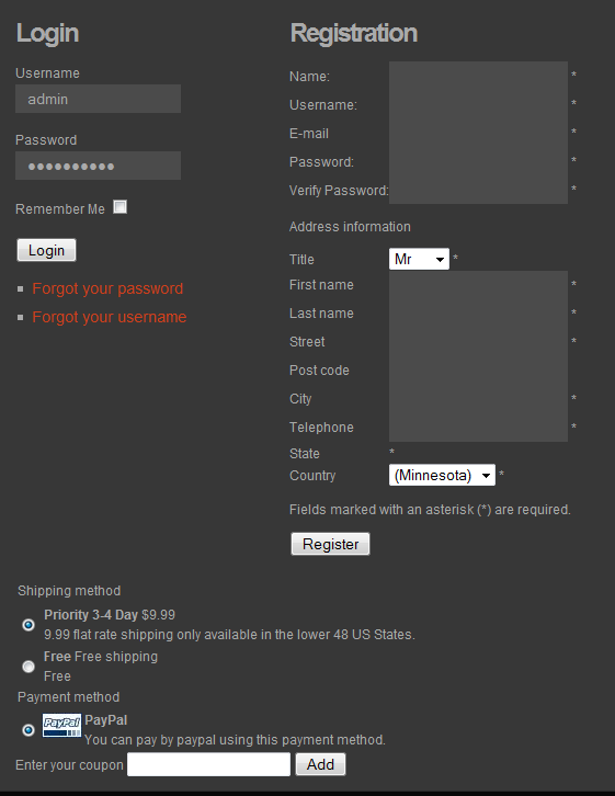

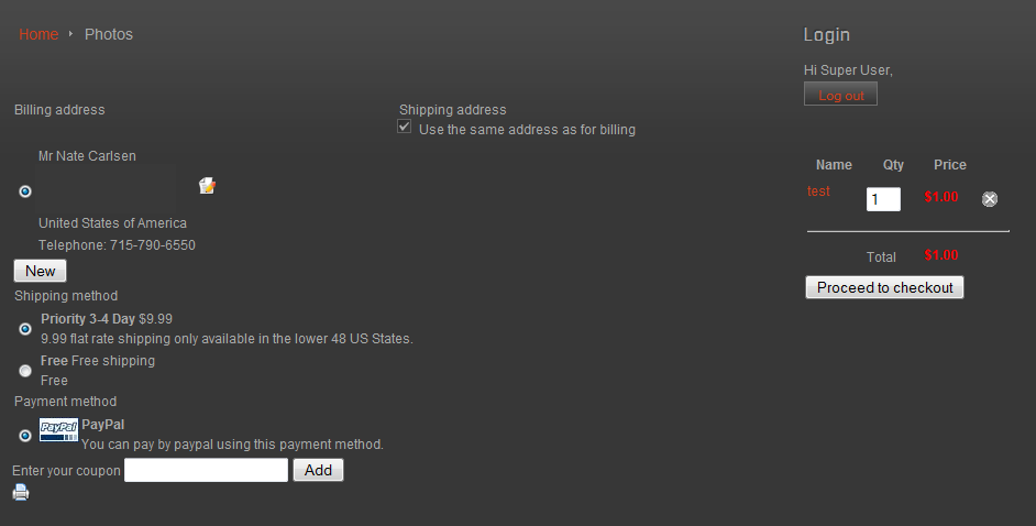

15 years 1 month ago #22814
Ah, I got it. Apparently there IS a requirement to register before purchasing, as seen in the screen shot. Once registered, everything looks normal, at least to me. And as you can see, the PayPal option is there. Do you not see this option?

15 years 1 month ago #22816
I can see the paypal method while not registered/logged in, but when I login/register on your website, I don't see it.
  • Posts: 164
15 years 1 month ago #22817
That's weird, because I do. Is there some sort of setting somewhere to only allow a super user to have access to a certain payment option?

15 years 1 month ago #22822
Your country is USA, mine is minnesota and that's the only one I can select. Please read the FAQ. It clearly explains the problem :
5/ If you restricted your payment methods to zones, check that the address you're using is inside those zones ! Otherwise the payment methods will be filtered out.
Thus, you should remove the payment plugin's zone restriction that you setup.
