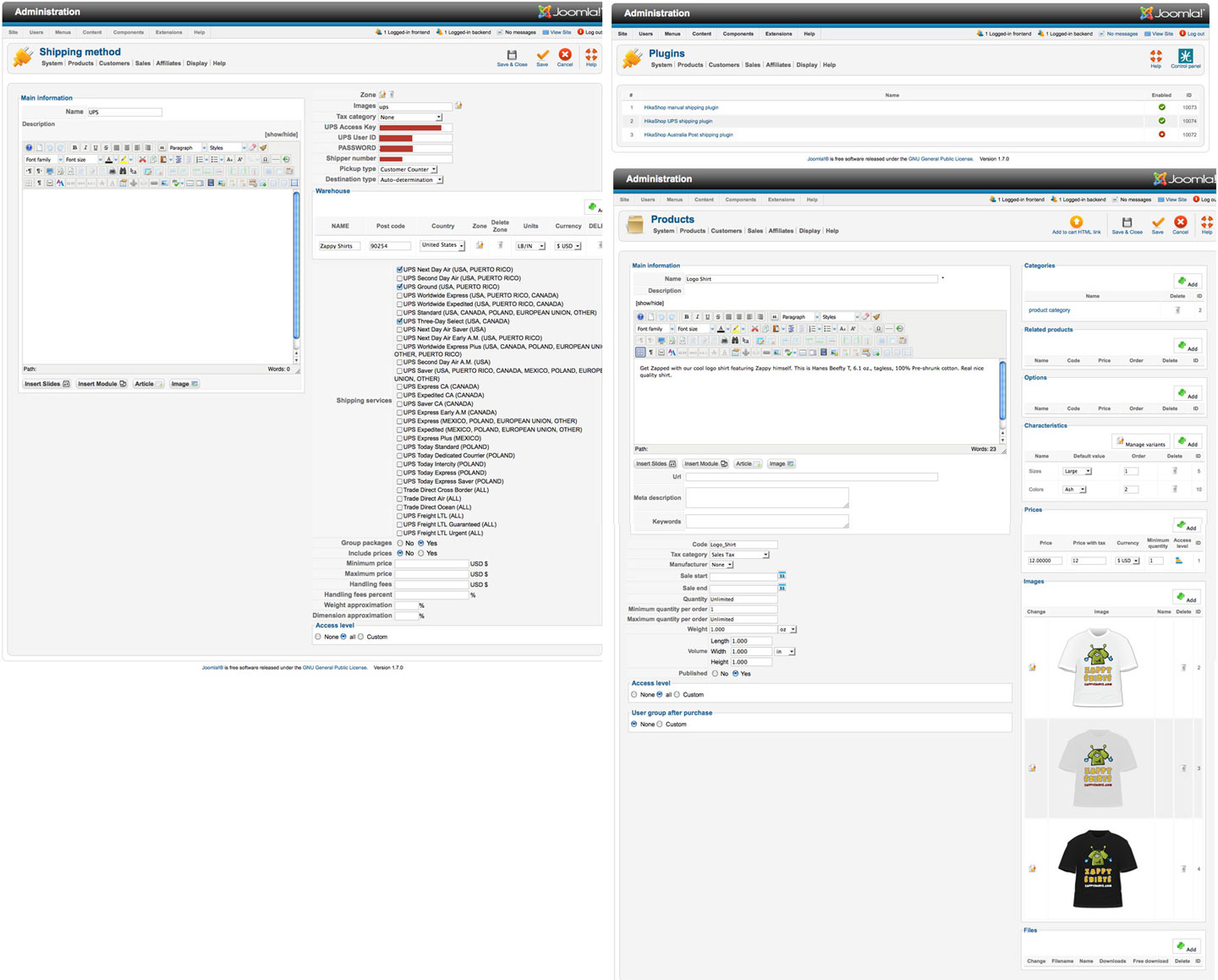

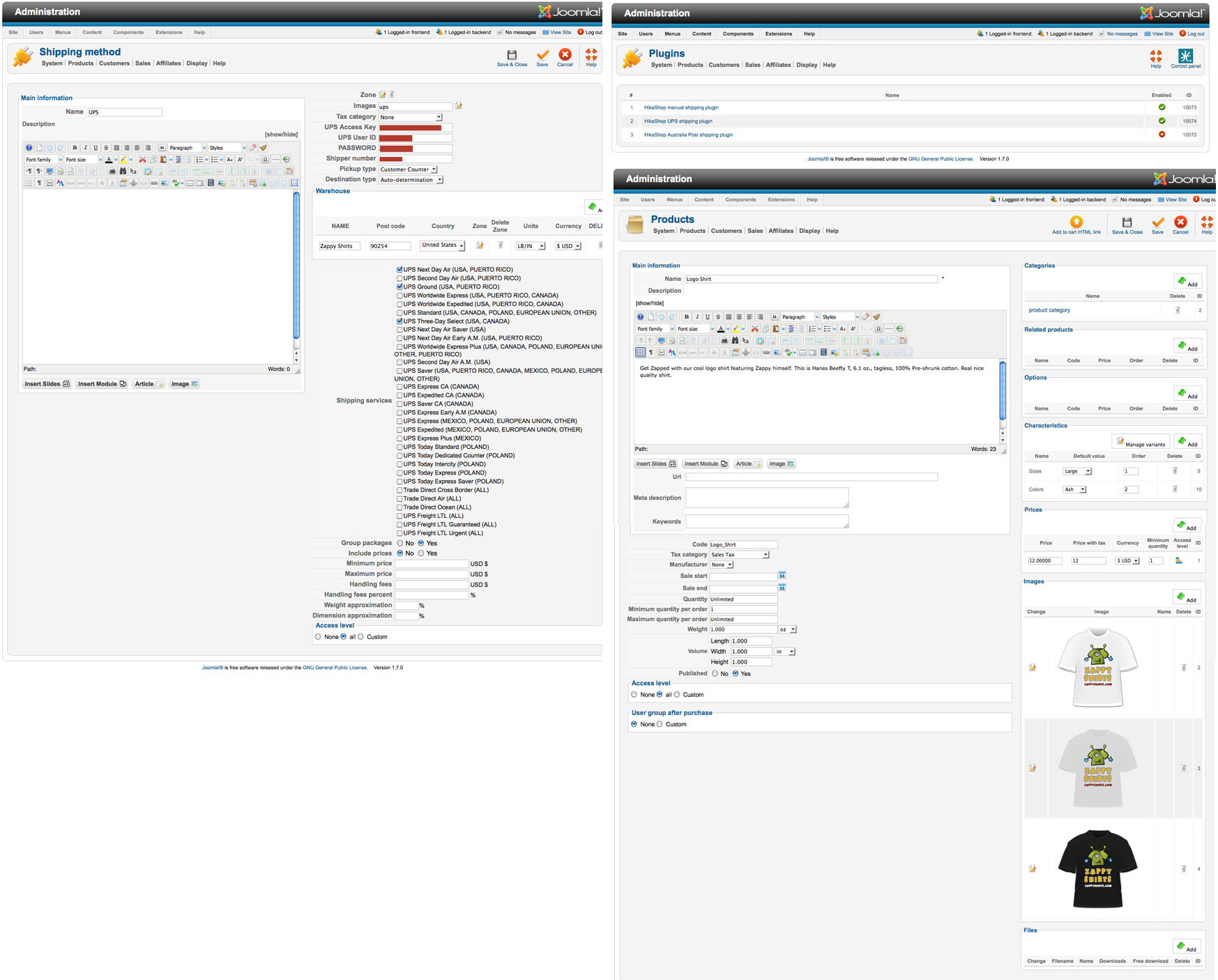

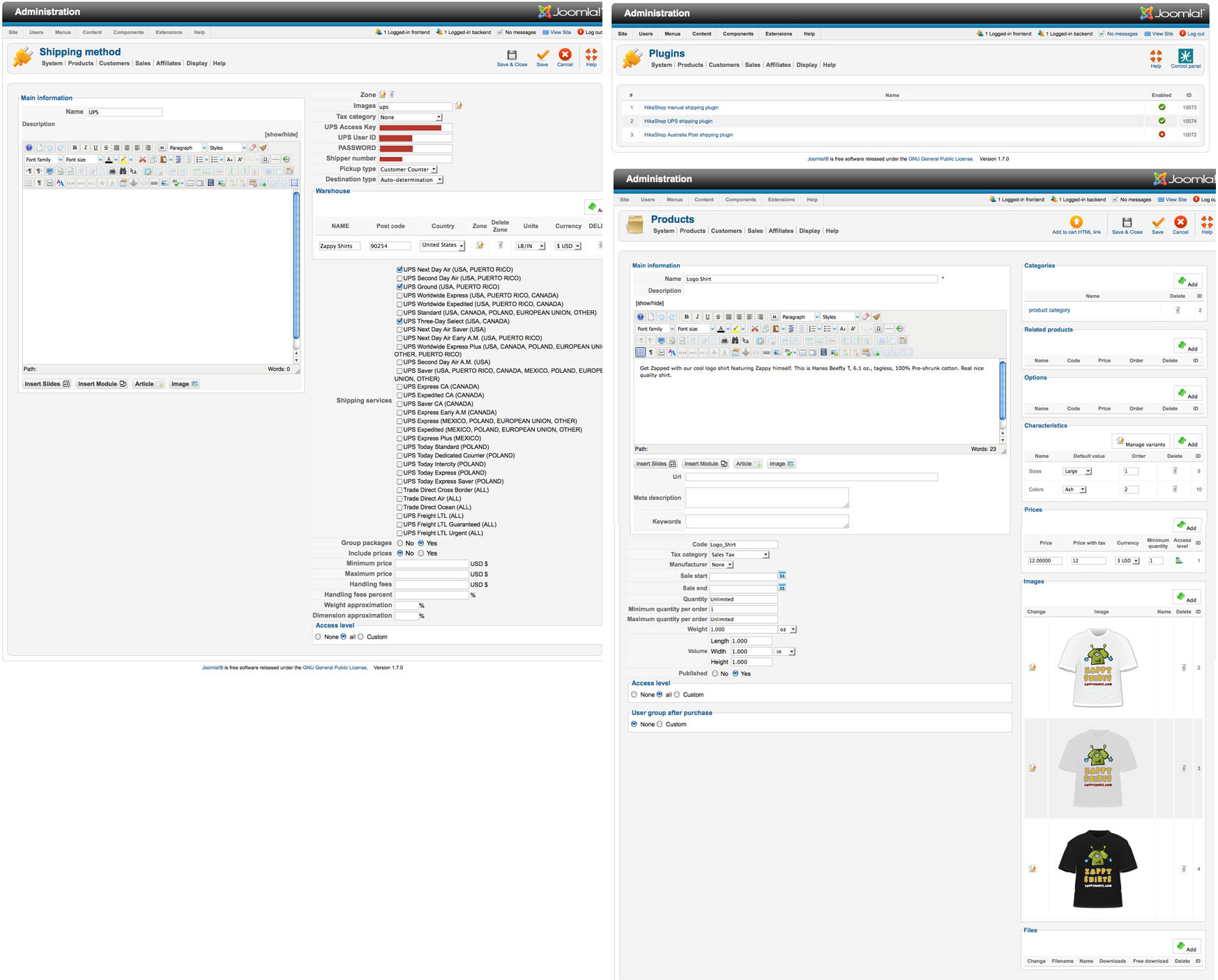

  • Posts: 6
14 years 11 months ago #23593
Nicolas,
I looked at all the suggested docs and still it's not working.
Please review the images and let me know what is wrong.
I can supply my UPS login info for you if needed.
If you need admin access to my site, let me know. thanks.
Last edit: 14 years 11 months ago by robert2301.
  • Posts: 85884
  • Thank you received: 14124

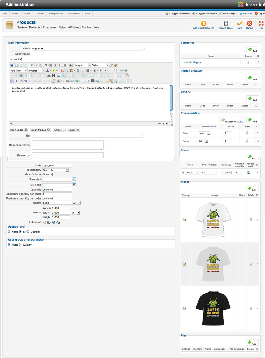

14 years 11 months ago #23596
I see that your product weight is 1oz.
Please make sure that your configuration's weight units option has oz as the main unit, as explained in point 9 of the FAQ.
  • Posts: 16
14 years 4 months ago #43386
Ok what do we do if we have different weight units such as some products are in OZ while others may be in KG
and on dimensions, some may be IN while others may be M
I have a product with weight listed as 0.100 lb and 0.250 M
configurations is : m,in,ft,yd,dm,cm,mm
oz,lb,kg,g,mg,ozt
Still nothing shows
Last edit: 14 years 4 months ago by Outdoorsman.
  • Posts: 85884
14 years 4 months ago #43508
The UPS plugin should work with any weight unit as there is a system in place to convert the weight from one unit to the other.
Please do a screenshot of your shipping method's options if you don't find the problem in the FAQ here:
www.hikashop.com/support/documentation/i...ins-listing.html#faq
