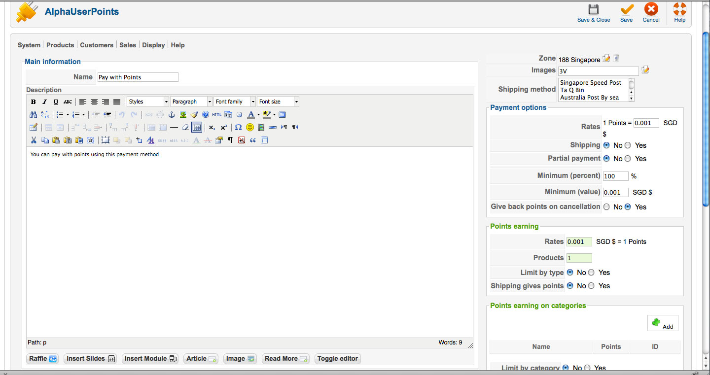

14 years 11 months ago #23776
Thank you Nicolas.
Here are the screenshots of the AUP configuration.

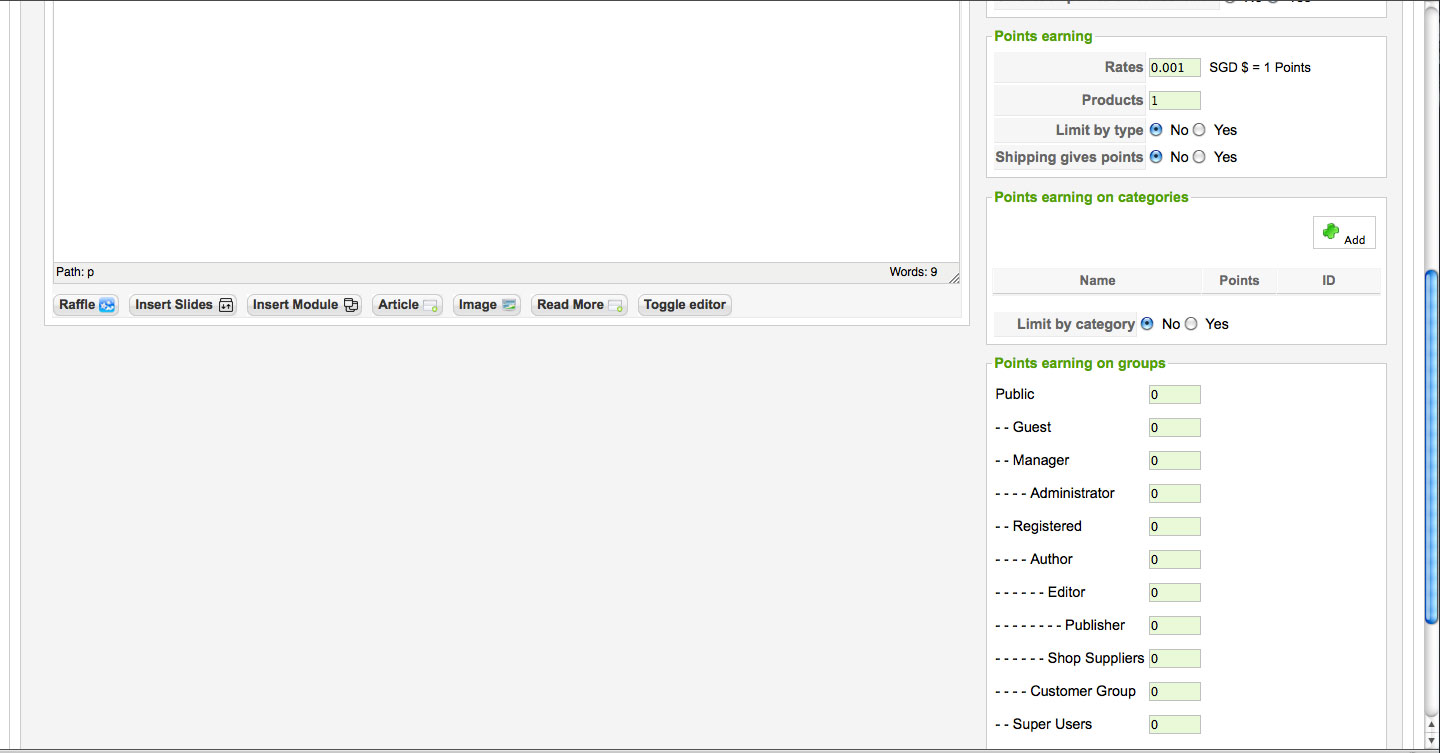

  • Posts: 4
14 years 11 months ago #23777
This is the other half of the configuration.
By the way if it is not possible, does it mean I have to create my own plugin? :(
Quite disappointing, thinking that purchasing the commercial one can help with this.
But thank you for your help anyway, the program is helpful in many ways though.

14 years 11 months ago #23779
Well the question is, how the plugin knows which user is your referee ? You want to have the user to enter the name of the referee on the checkout ? You want to use the affiliate system of HikaShop Business ? As it is now, you would indeed have to modify the views in hikashop and/or create a plugin to handle that.
I see that you restricted the plugin to singapore. That means that it will only be displayed on the checkout if the address of the user is in singapore. It's probably why it's not displaying.
