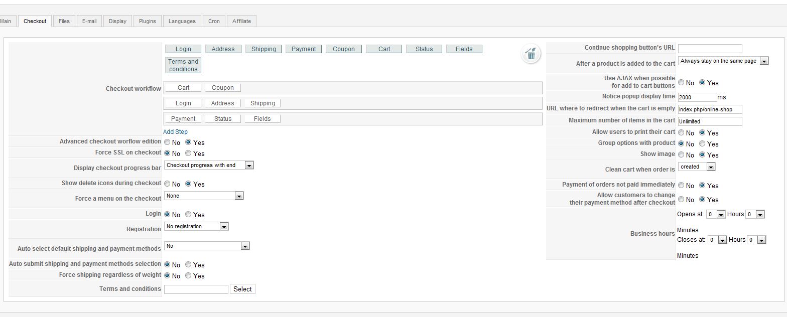

As I had so much trouble (1 full days work) getting the Checkout Workflow to work consistently (so far), i thought i'd post my settings here. If not for others, at least I can refer back myself.
My requirements were:
1. no login required
2. enter Name & Address
3. choose shipping
4. choose payment options
Seemed easy enough, but the Documentation about the Workflow in my eyes was not self explanatory. Which is difficult given all the options.
Example, if you don't want registration, that's obvious to set Login=No and Registration=No registration.
But, to be able to capture their "Address", you still need Login in the Workflow. Address on it's own doesnt work.
Just that simple requirement took hours of scrolling through the forums to find a comment from Nicholas stating that. And many page refreshes, cache emptyings and punching the screen.

  • Posts: 28
14 years 9 months ago #31566
Nicholas, it may be clear to some, but i didn't understand that from the documentation.
The same as this option, i really don't quite understand what your'e saying here:
Auto submit shipping and payment methods selection : You can deactivate here the auto submission of the checkout form new information when a user select a new shipping/payment method.
I don't get what that means?
I'm still having issues with the above setup.
Yesterday morning I tested the checkout process by doing a test purchase. It worked fine, all the steps were there.
Then in the afternoon I tried it at a different location on a different PC, and the "Shipping Option" didn't show up.
Perhaps it's a missing weight in one of the products, or something. I havent had time to come back to it yet.
But, that Auto Shipping option, what exactly does it do or not do please??

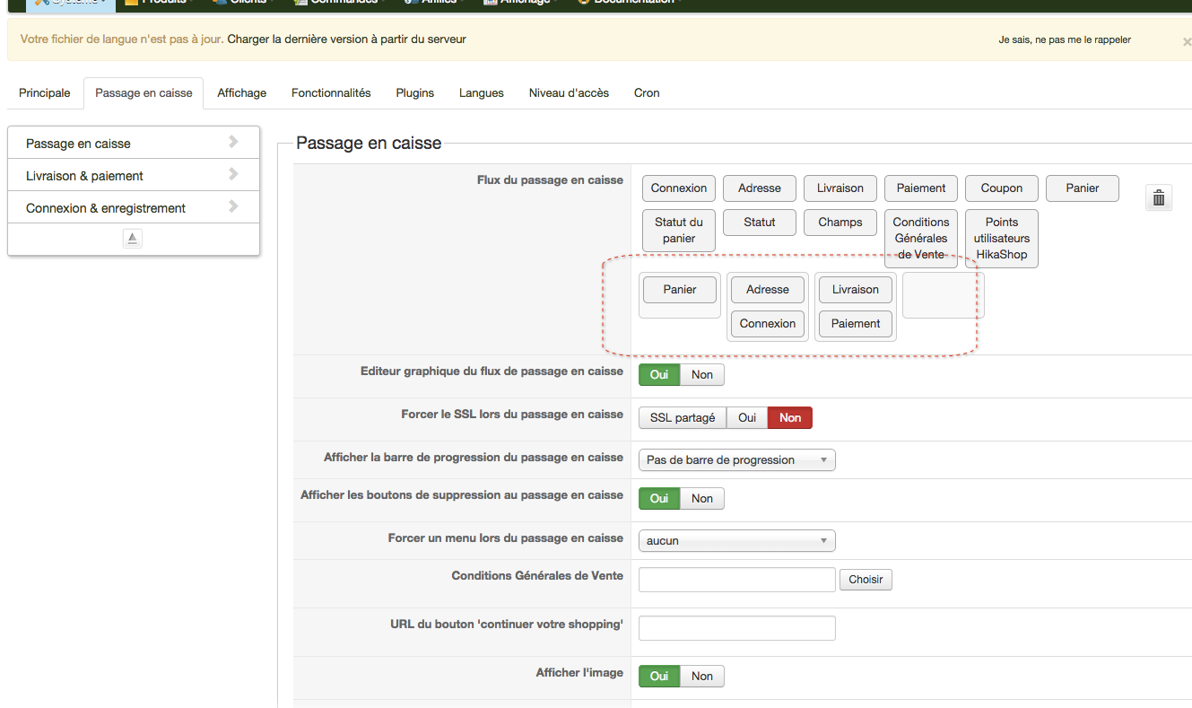

  • Posts: 37
11 years 10 months ago #176484
Well.
I did exactly as you said (check it: www.programme-minceur.eu/?betab=1 )
Things look good. BUT if you try to order (very quick trial) then... you can go up to the payment step without any address requirement !
INFO:
Checkout process set-up in Hikashop (very simple):
- 'Cart status'
- 'Delivery'
- 'Payment'
More info:
- I checked : my product require a delievry. So what's wrong ?
- if I add the 'Address' field in the second step for instance, I have the 'waring' message and then it is not possible to the next step.
What's going on ?
What should I do ?
Something is indeed going wrong... :( :(
Or I missed something.
Many thanks in advance for your help.
I really need to solve this by tomorrow, I had a meeting today. Customer not so happy to not be able to finalize order...
HELP!
Dominique

  • Posts: 37
11 years 10 months ago #176529
Hi again,
And thanks for your answer.
Actually I tried this before, but clicking on 'Next' was not doing anything, so I thought this was not it.
I added it back into the checkout flow.
Issue is still here: even if you enter a valid email, clicking on 'Next' just reload the same page again and again.
It never goes to next step.
