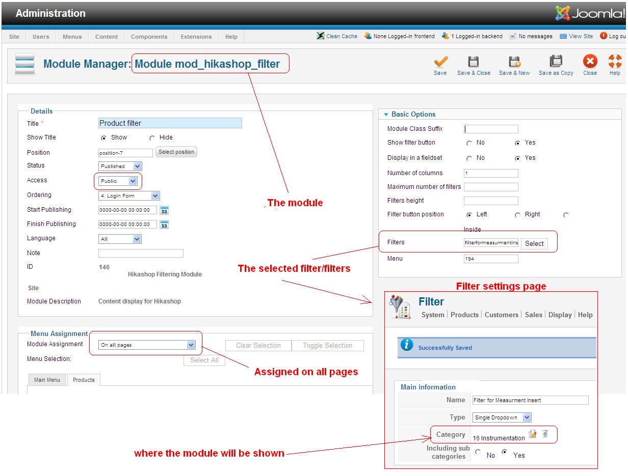

The Module mod_hikashop_filter does not stay on all pages even if you have selected "menu assignment: on all pages"
The module will be visible dependent on the filter you have called in the module's sttings. (the dependency is that you need to select a category in the filter's page, which will be where the module will be visible!)

Yes that's normal. The menu assignment tells joomla to display the module or not.
The category option of a filter tells HikaShop to display the filter or not based on the current category.
So that's two different things. You can have for example two filters on your module. If they are attached to different categories, you will only see one at a time (or none for another category).

No, the module for be on all the pages and you configured it to have it on all the pages.
So you should see it on all the pages. However, the filters in it will only be displayed in the category to which you assign them. If you want to display them everywhere, you should not assign them a category.

try this
1. Module Manager: Module mod_hikashop_filter
2. Basic Options: Menu = The ID of the menu you want the products to be shown
3. the ID is taken from Component-> Hikashop->display-> content menu.
You can make a module and set all you want to be showen and then use its ID in the Filter module.
Hope it helped you and made things even more complicated :-)
