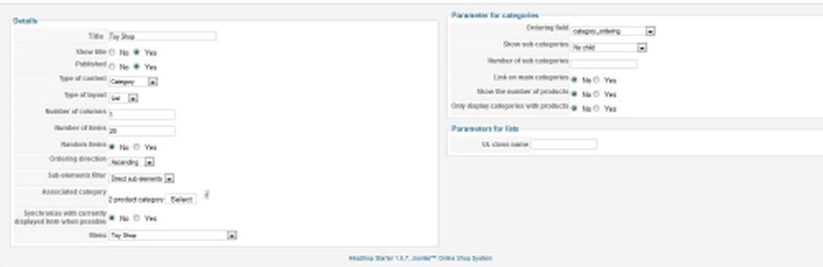

What you did is create a category listing menu. What I said you should do for what you want is to create a category listing module.
Here is a tutorial for that:
www.hikashop.com/en/support/documentatio...ml#categories_module

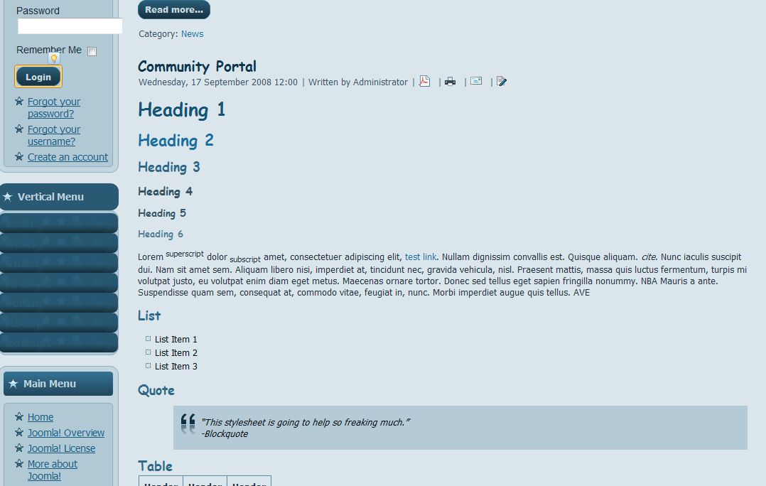

  • Posts: 76

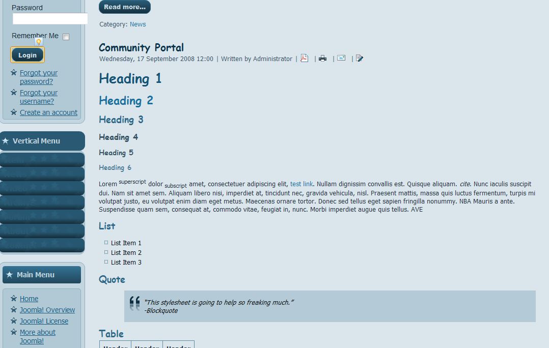

14 years 4 months ago #48227
I've had another try and seem to be able to pick up the template CSS for the side menu module now although its not showing correctly. I have attached an image and would appreciate any suggestions.
  • Posts: 86177
  • Thank you received: 14212
14 years 4 months ago #48283
I don't see the same thing on your website.
Could you give the exact link of that page ?

www.examplepages.me.uk
It should look like the template image I attached before with the menu in a darker blue colour but its not picking up that formatting.
Sue
  • Posts: 86177
14 years 4 months ago #48377
I'm not seeing any joomla menu with that formatting on your website. In fact, I'm not seeing any joomla menu.
  • Posts: 76
14 years 4 months ago #48395
Ok... well thanks for your help. I'm completely lost now. When I look at the site I can see the side menu with the Hika shop module showing the categories but not with the blue colour that the template should show. I'll just go with it as it is... or try and change my template. I haven't added any Hikashop modules to the main menu yet.

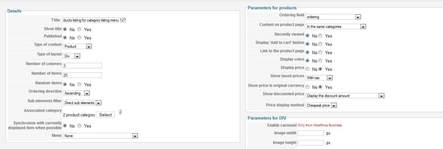

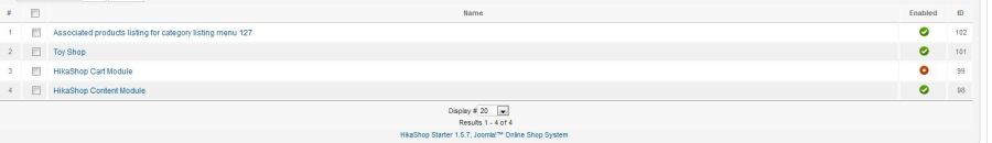

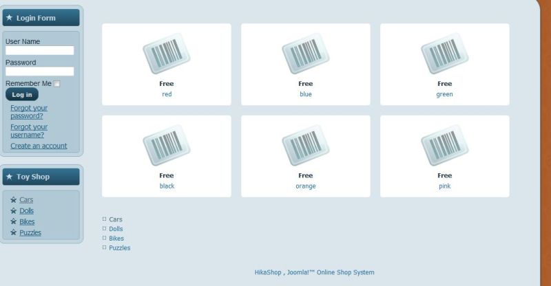

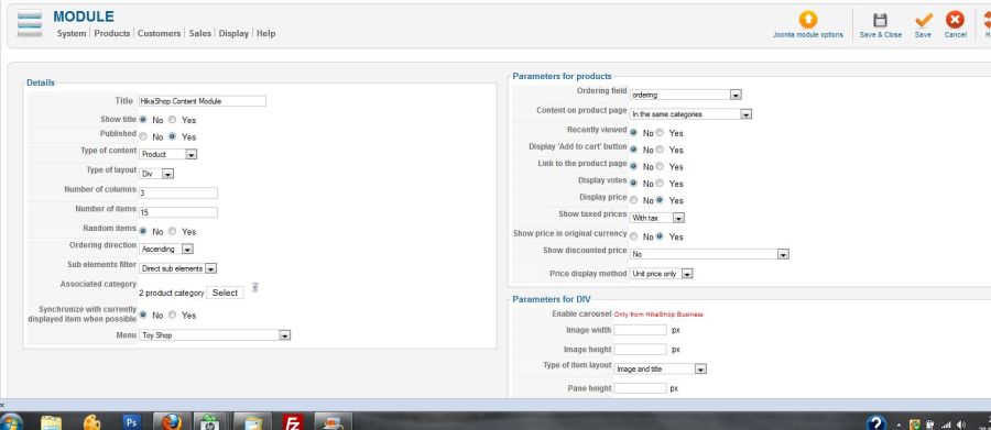

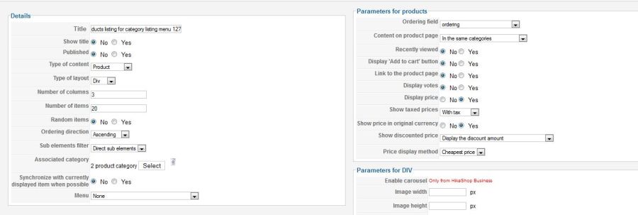

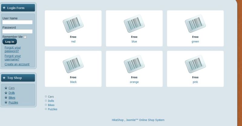

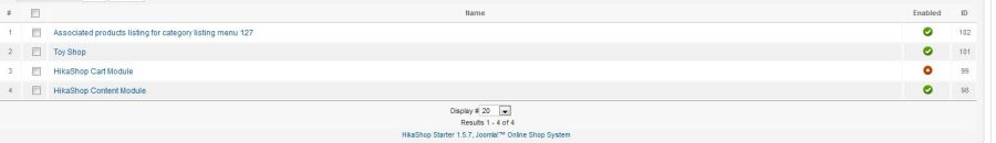

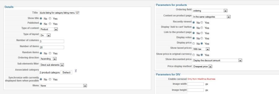

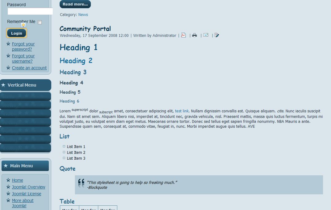

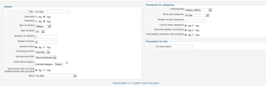

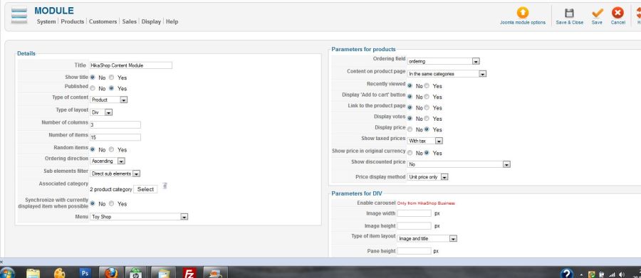

14 years 4 months ago #48573
I have had one last go at this. I have got there I think except that I cannot stop the categories also shopping on my products page. I have attached some images. Please can you let me know where I'm going wrong.
Sue
