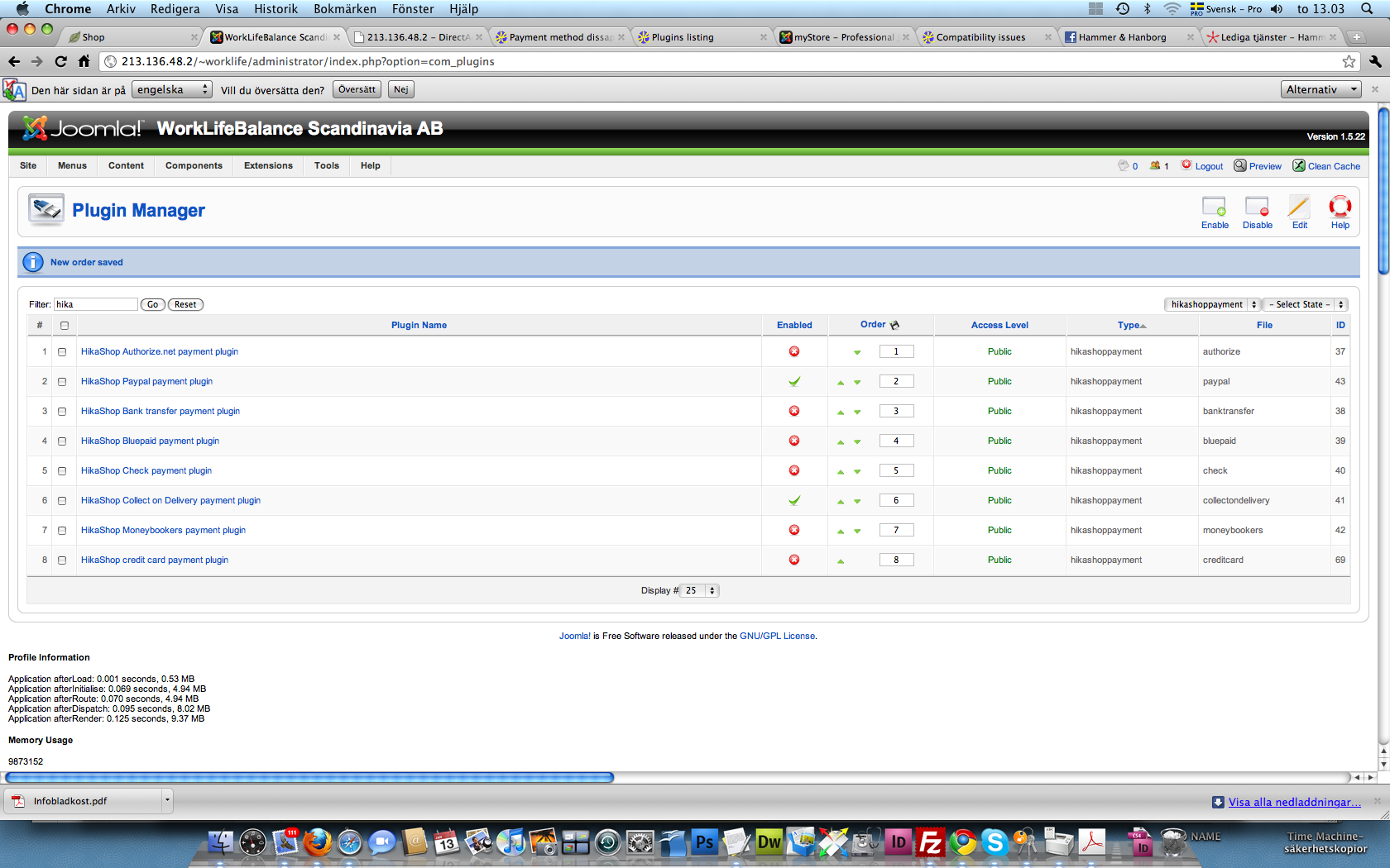

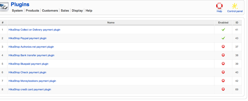

  • Posts: 86183
15 years 8 months ago #5059

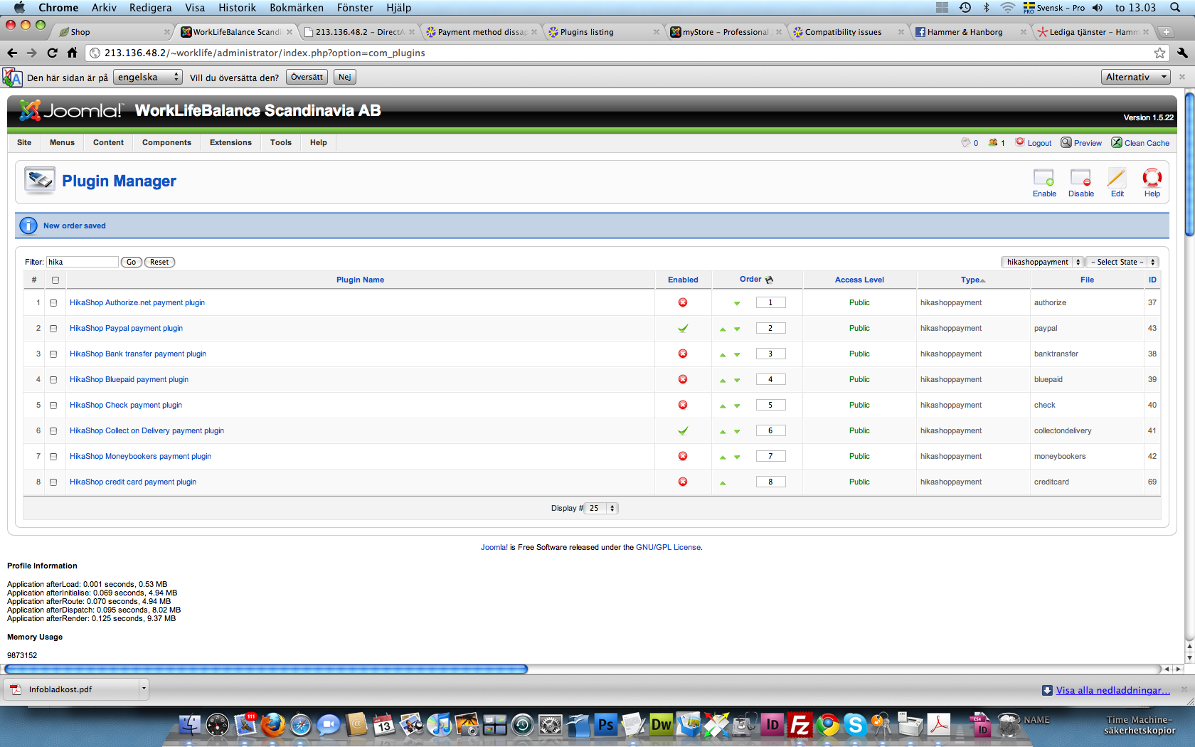

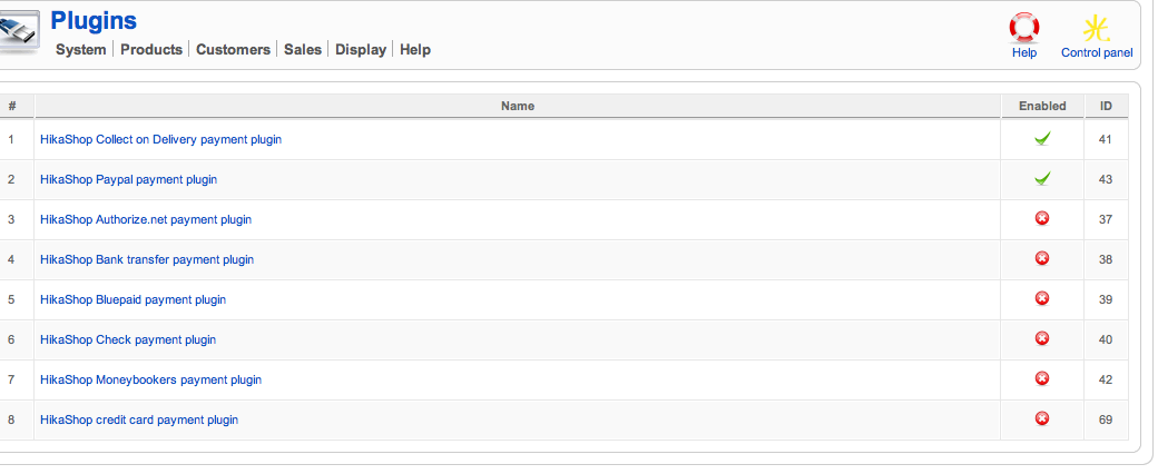

Could you do a screenshot of the listing of hikashop payment plugins in the joomla plugins manager and in the menu System->Payment methods ?
  • Posts: 50
15 years 8 months ago #5060
Last edit: 15 years 8 months ago by weting.
  • Posts: 86183
15 years 8 months ago #5064
Could you set an ordering value for the two payment plugins you published ?

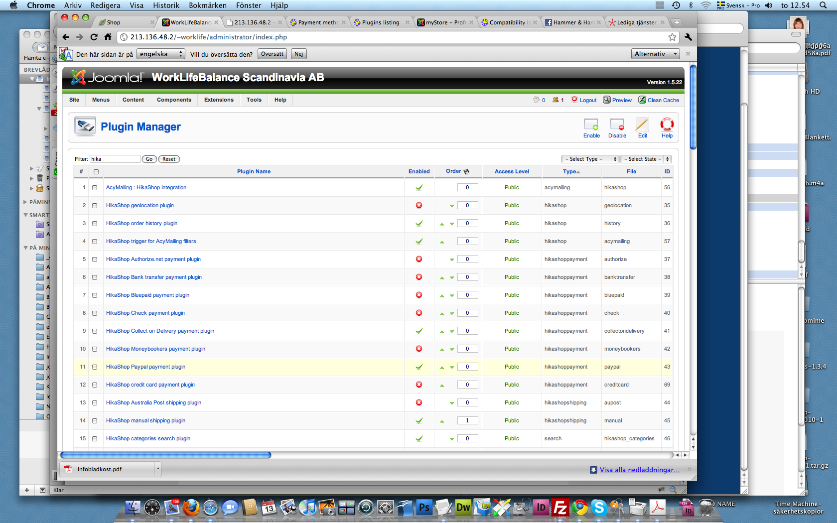

  • Posts: 50
15 years 8 months ago #5065
Like this?
No difference ..
  • Posts: 86183
15 years 8 months ago #5066
Yes. At one point, in old releases of HikaShop we had the payment plugins not displayed when the ordering value was the same for all of them, so I thought it might come from that.

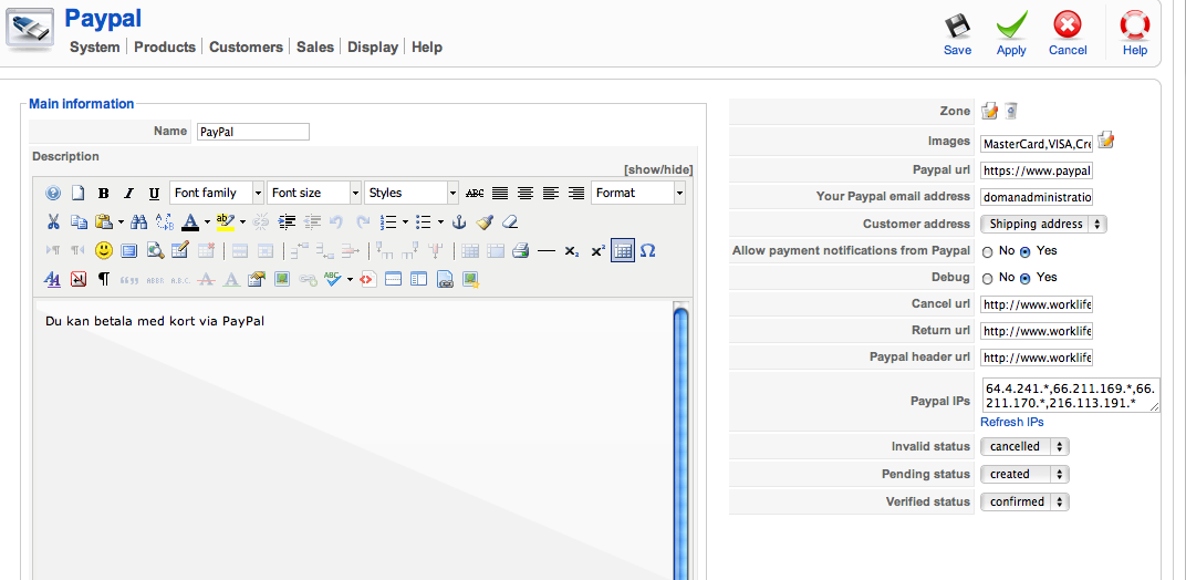

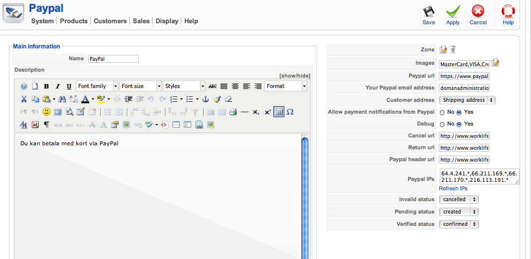

Could you do a screenshot of the options of the paypal payment plugin ?
  • Posts: 50
15 years 8 months ago #5067
/I
