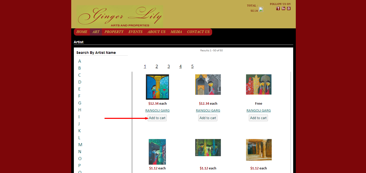

I think i broke my site. gingerlilygallery.com/index.php?option=c...product&task=listing
Even though i add a product to cart its shows 'The cart is empty' at check out.
Could you please help me to resolve this problem

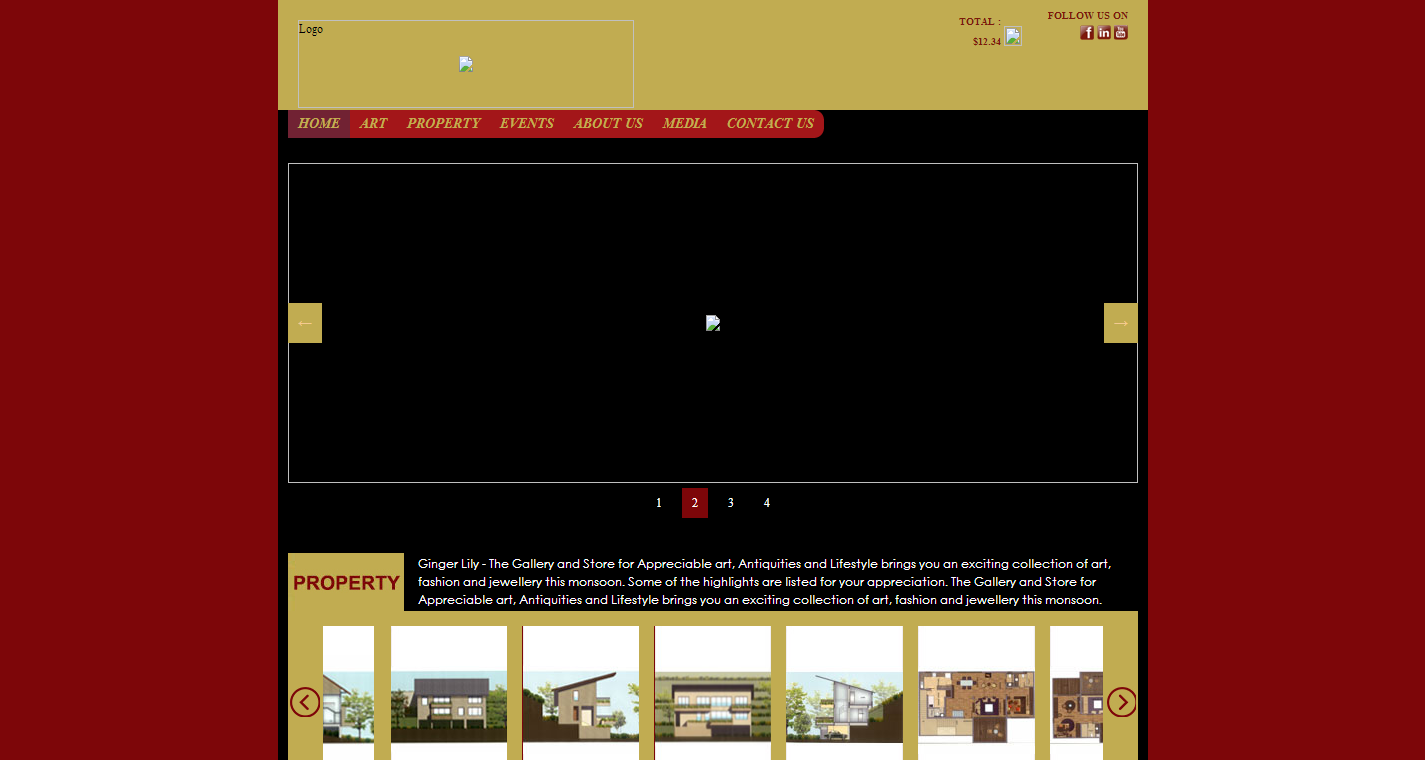

12 years 5 months ago #143623
Here are the two attachement. I do 'Add to cart' and it takes me to the home page.

12 years 5 months ago #143663
When I test it through this page , a popup is showing if I use the "add to cart" button and the product is correctly added to the cart, so can you give me a link to the page where you are having that issue ?
