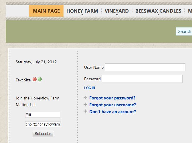

  • Posts: 254
13 years 11 months ago #58305
I resolved the authorize problem - I was editing the file in the administrator/components/com-hikashop/extensions area rather than the plugins folder - it works fine now - Thank you!
Some more issues:
I have been trying to set up checkout without login and am having some problems with the "end codes".
My workflow is: cart_login_address_shipping_payment_coupon_status_fields_confirm,end
I set config to "no login & no registration" and removed all extra code from the "end" and "after end" pages. A test order with check payment went through perfect, Another test order with authorize and order went through ok but no copy of page (code was removed) & page is blank but Thank You is in blue box on top of screen.
Then I put the "after end" code back and the new code in the "end" file. Both new codes were pasted in below the original ones.
2 more tests:
Test 1 with no login/no register/ added code in end & after end - sent test order with check payment - order went through with ending in this page: (attached 1)
Test 2 with no login/no register/ added code in end & after end - sent test order with authorize and order did not go through & I received this page: attached 2, asking for a login.
I would like to have the setup - No login, no registration, & after order is sent using either authorize, Paypal or check the customer sees a copy of his order (with maybe a "Thank You" on the page to print along with the thank you on the very top of the window (outside of the page) With check payment it would be nice to see the check pay instruction along with a copy of the order.
  • Posts: 85795
  • Thank you received: 14089
13 years 11 months ago #58372
The order details page is only available for logged in users.
When the user is anonymous, he can't access order details for security reasons because it's not possible to identify him.
So the behavior you're experiencing is totally normal.
Either you don't redirect the user to the order details page and you can have a "no registration" checkout, or you redirect to the order details page and you can't have a "no registration" checkout.

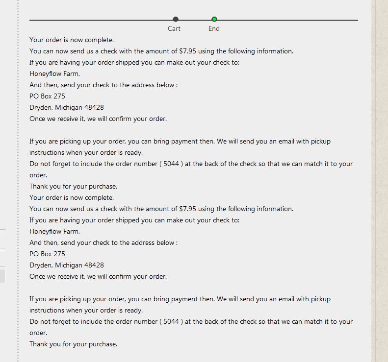

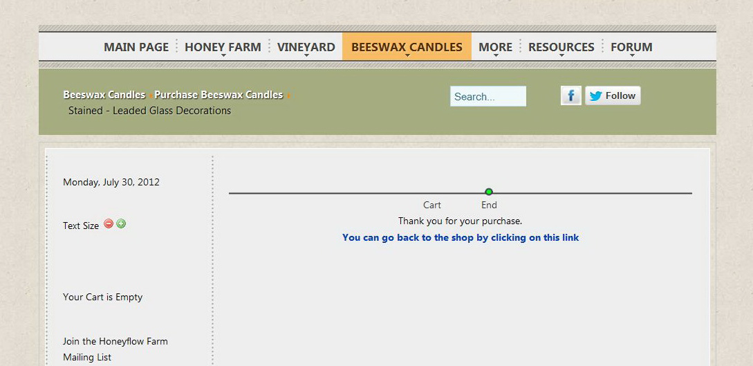

  • Posts: 254
13 years 11 months ago #58394
Thank you for the clarification - We are going to proceed with "No registration or login". (Just a note for future versions, It would be nice if the customer had the option of creating a log in or not)
A few final questions:
Test order 1 - local pickup & send check - order went through just fine with nice send check info screen at end.
Test order 2 - ups & authorize - order went through just fine but at the end I saw a nice screen with some thank you text and something more... But the screen disapeared and went blank.
1 - How can I keep that screen back in the end picture (and maybe edit it slightly?
2 - On the invoice (sent to us and customer) (attached), can I get the TYPE of shipping, and the TYPE of payment somehow on the invoice?
3 - How do I get any mention of VAT off of the invoice - We have none.
  • Posts: 85795
13 years 11 months ago #58511
1. Can you do a screenshot of that page and give the link you have in the browser URL bar for it so that we know which one you're talking about ?

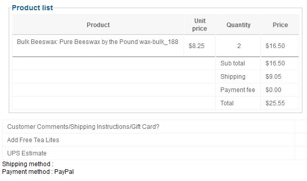

  • Posts: 254
13 years 11 months ago #59376
1 - Attached is a screenshot of the page that dissapears after an order is completed. If I could get that page to stay with a copy of the order below it the problem would be solved. Do you have some code I could paste - I cannot write code myself. (I think maybe you already said I could not do this because the customer is not logged in - but can I edit the page and remind them an order copy will be sent to them?) (I guess I have to decide what scenario is worse - forcing a login or no order copy)
2 - I copied and pasted the code to show the shipping and payment methods to the "bottom" of the "invoice file I found in the "display - Views" folder. The methods were not visible in the next text order I made.
3 - I changed the code for the VAT tax - but I remembered that I will have to set up State of Michigan Sales Tax eventually - Is that a separate issue or did I just mess that up.
New question - I have a customer that purchased 3 jugs of honey that has the price included in it. The "Shipping Address" fields do not show up for him to verify that it is going to the correct address. I think this is because of the "no shipping" but is there any possible way to put the "Shipping Address" fields back in the picture for the customer?

13 years 11 months ago #59431
1. Indeed, you can't display the order details there since users have to be registered for that.
If you just want to change that text, you can use a translation override:
www.hikashop.com/en/download/languages.html#modify
I think that the redirection that you get on that page comes from the fact that you entered a URL in the "return URL" field of the authorize.net configuration.
If you don't set it, it won't redirect the users.
2. Make sure that you're doing it for the file of your back end template.

13 years 10 months ago #60199
I have pasted the above code in the back end of the invoice file on the bottom and the shipping method is still not visible on the invoice printed from the back end of Hikashop. (image attached) It does show up for a "Free Shipping" order. I use this page to go pack the order and it is very useful to show how I should pack and ship it. The payment method comes through ok. I can write it in by hand but it should be there.
I just set up Sales taxes for the State of Michigan - works fine - but can I set it up so the sales taxes show "AFTER" the customer enters his address rather than before? I do not use a log in. My customers in all the other states do not like to immediately see Michigan taxes applied (It could make them stop the order) - even if the taxes go away after entering their address. I also removed the change for the "VAT" tax that you gave me and Michigan Taxes still shows up automatically.

If you don't want the tax to be applied before the address is entered, you can change the "main tax zone" option of the configuration to a different zone.
It must be because you're using UPS.
Instead of:
$shippingClass = hikashop_get('class.shipping');
$shipping = $shippingClass->get($order->order_shipping_id);
$shipping->shipping_params = unserialize($shipping->shipping_params);
echo 'Shipping method :'.$shipping->shipping_name;
try:
echo 'Shipping method :'.order->order_shipping_method;

10 years 7 months ago #220503
This:
$app =& JFactory::getApplication();
$order_id=$app->getUserState( HIKASHOP_COMPONENT.'.order_id' );
$app->redirect(hikashop::completeLink('order&task=show&order_id='.$order_id,false,true));
in fater_end.php doesn't seem to work anymore? Is there an update to display the order summary?
Many thanks.
  • Posts: 85795
10 years 7 months ago #220506
That code should still work.
Are you being redirected to the after_end URL after the payment ?
If not, that could explain why you don't see any change.
Or it could be because you're editing the view file for another template than the one you're using.
