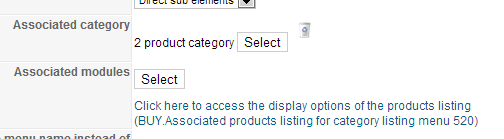

I went through and deleted all menus and modules, and started again by copying exactly the setup of another site that works properly, and the only thing that was different was that the correctly working site had no associated category menu selected (see attached) and the site that doesn't work properly, automatically has the product category selected, and when you delete it and save, it appears again.
Another thing I noticed was that the alias was not saving correctly either, but seems to be working now.
Thanks for your help! :)
