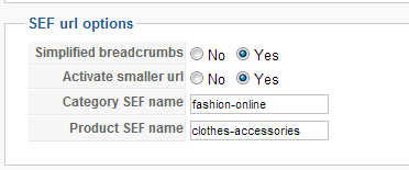

It sounds like the issue is that the product SEF name and the category SEF name are not configured properly in the configuration of HikaShop and because of that, the SEF system is not able to distinguish between the product details page and the products listing page.
Could you do a screenshot of the whole SEF options area of the configuration of HikaShop ?
  • Posts: 392
13 years 4 months ago #96286
Removed the dash and works perfectly, thanks so much Nicolas :)
